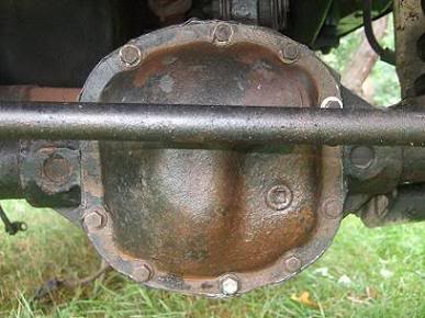

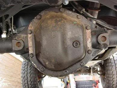

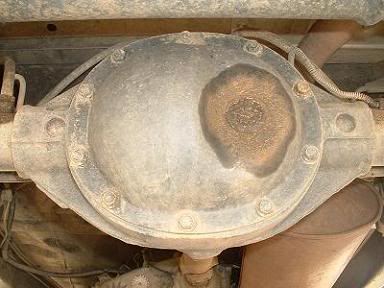

In the short term, you can look at the axle - if there is a plastic / rubber fill plug on your back axle then it's a Dana 35.
Dana 30:
Dana 35:
Dana 44:

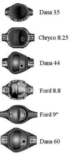

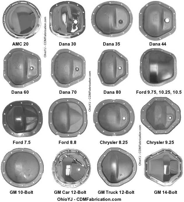

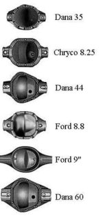

Front will be a D30, rear could be a D35 or Chryco 8.25. If you have ABS good chance it's a D35.
heres some helpful pictures i have collected over the last year
