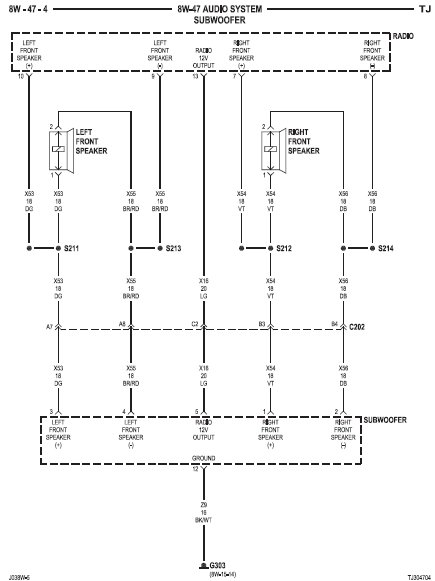

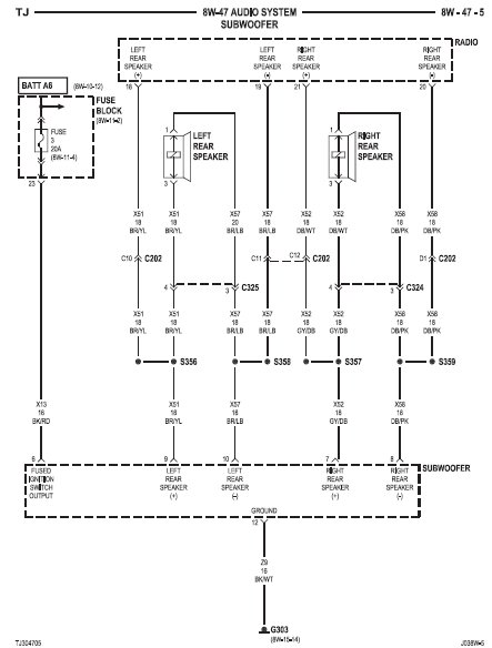

Here is the wiring diagram if you can make sense of it. Unfortunately I know very little about wiring but just have the FSM.
PM me if you want me to email these images to you in pdf format so you can see it better.
