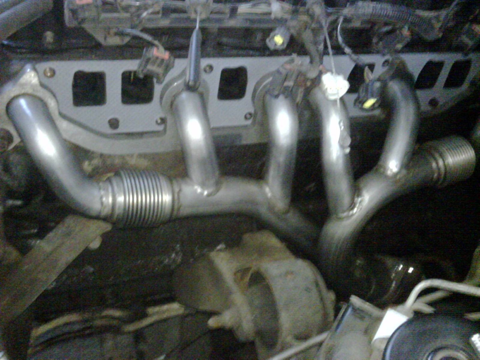

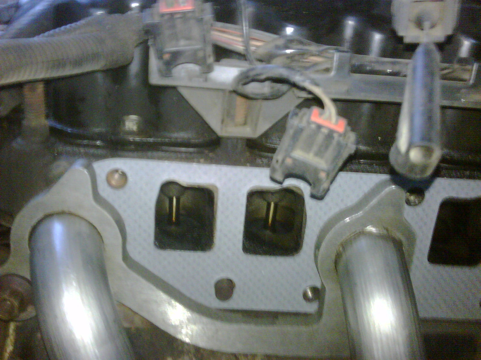

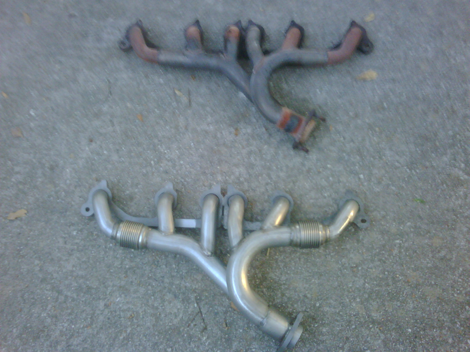

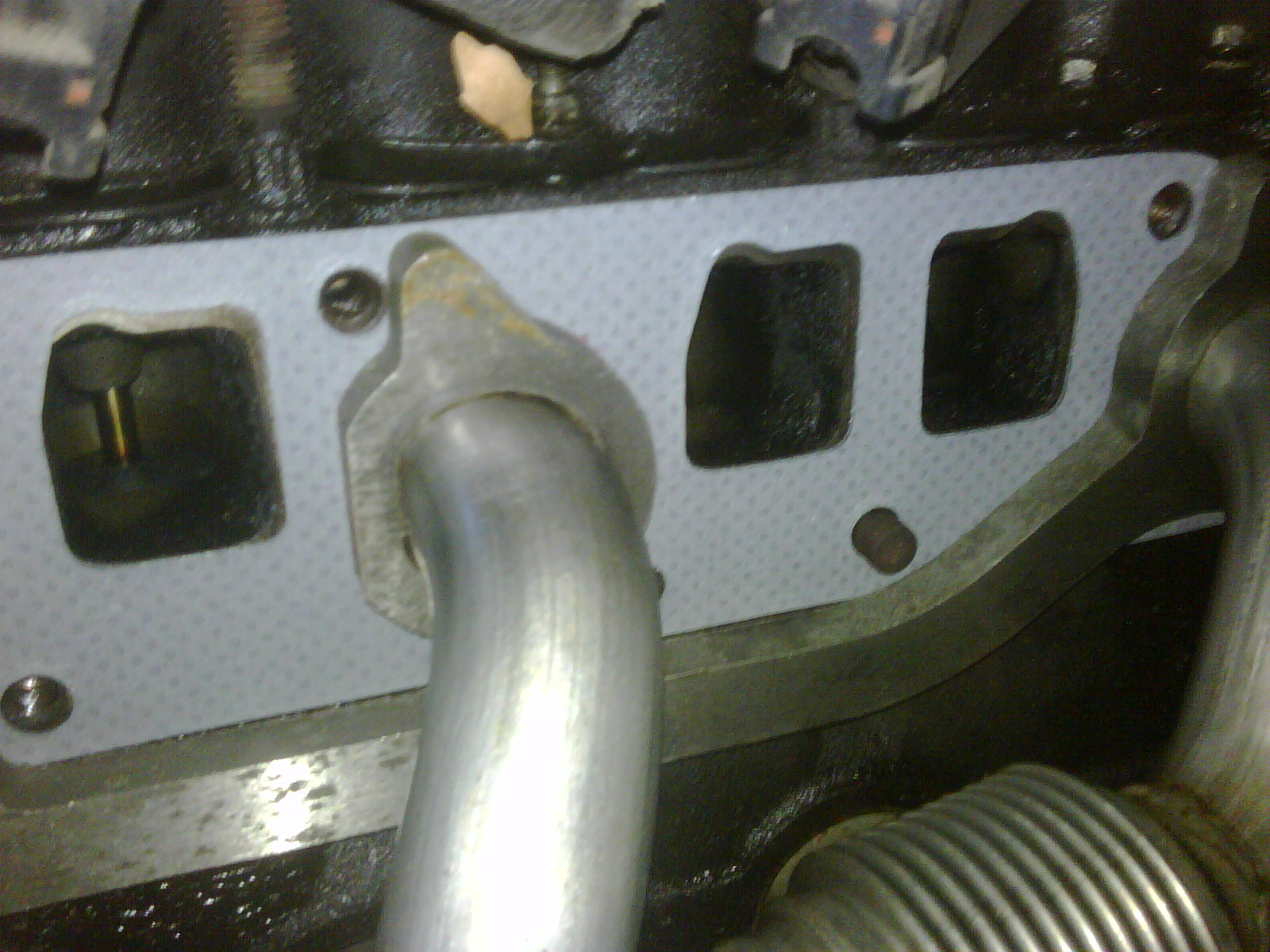

The replacement ECU works fine now. It turns out that a fuse had blown. Apparently when the other ECU finally went bad, it pulled additional amps taking the fuse out with it. It reminded me of a light bulb that's at it's brightest just before burning out. Anyway, it's running good now. I just finished swapping in another exhaust manifold (looks more like a header) due to fractures at the weld points. I still need to swap in the new o2 sensors. I figured with almost 200k on the clock that a fresh set of o2 sensors wouldn't hurt. Oh, and the analyzer now reads the ECU fine along with the fuel gauge working and the check engine light now cycles on and off right after the ignition is turned on.
I have attached some pics of the old and new exhaust manifold.
Matt
