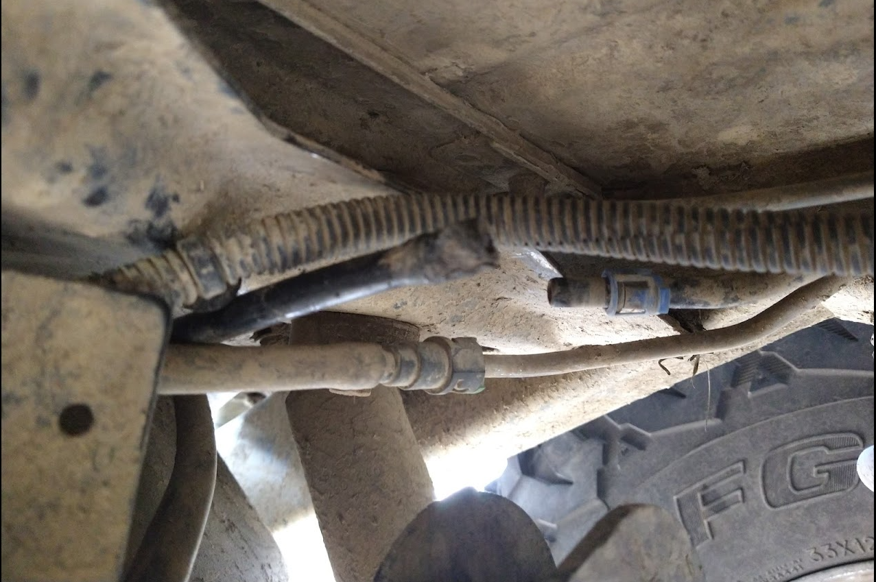

I found it. It was the plastic hose that goes from the tank / evap canister back to the front of the Jeep. Where the plastic line mates to the hard line, it broke off.
I'm having a heck of a time finding this hose online. For the time being I've wrapped them together with a big wad of tape :roll:
It looks like I may have to drop the tank to successfully replace this.
