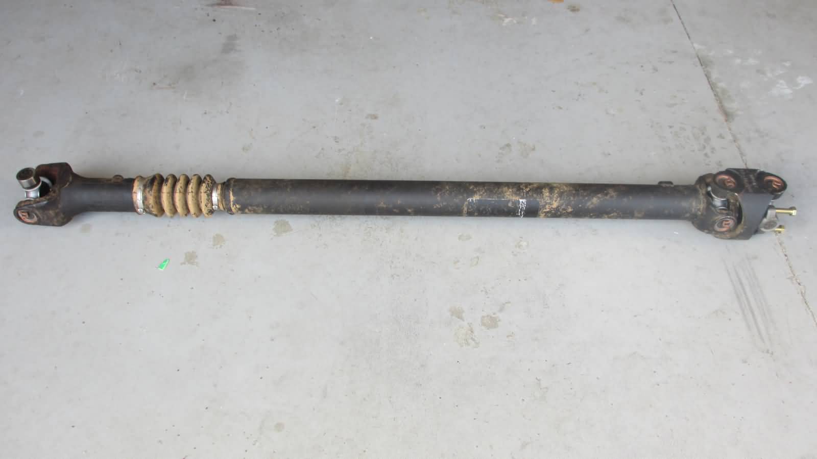

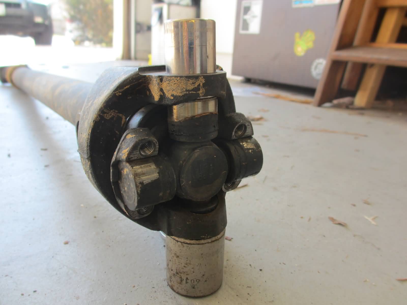

This is the front driveshaft from my 2005 Wrangler TJ

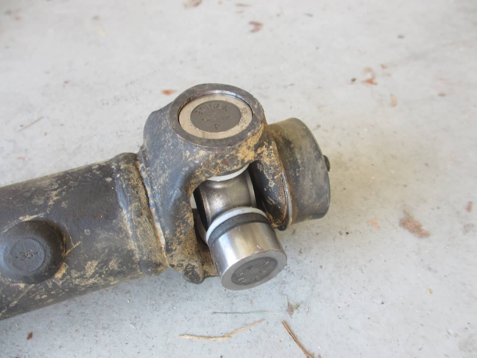

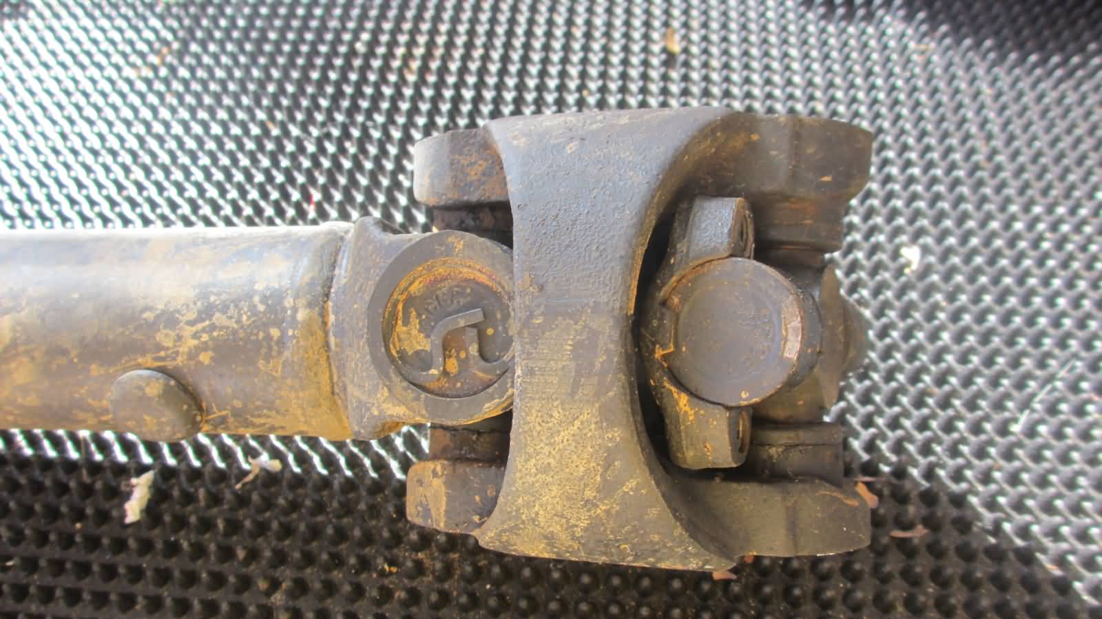

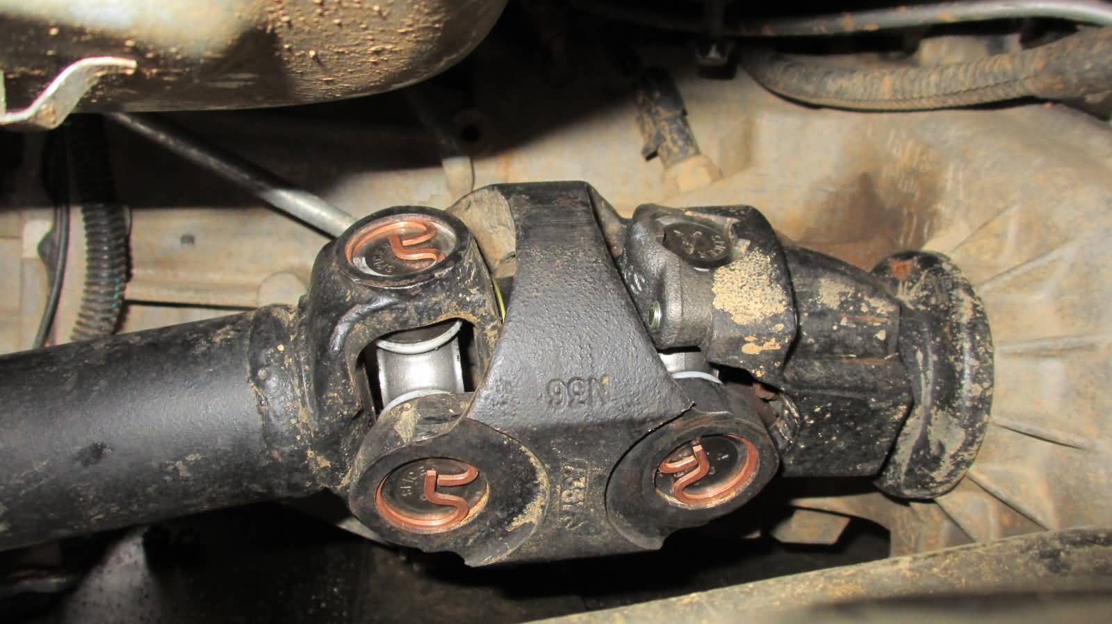

And this is an up close view of the double cardan

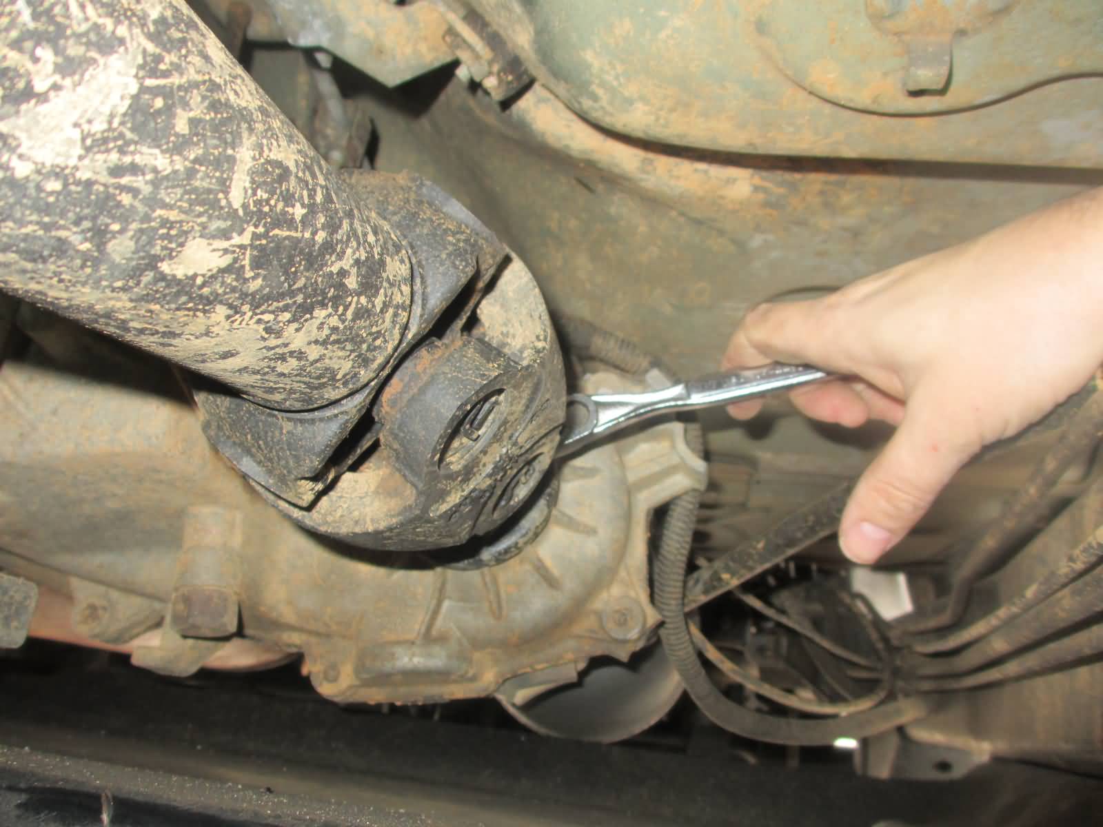

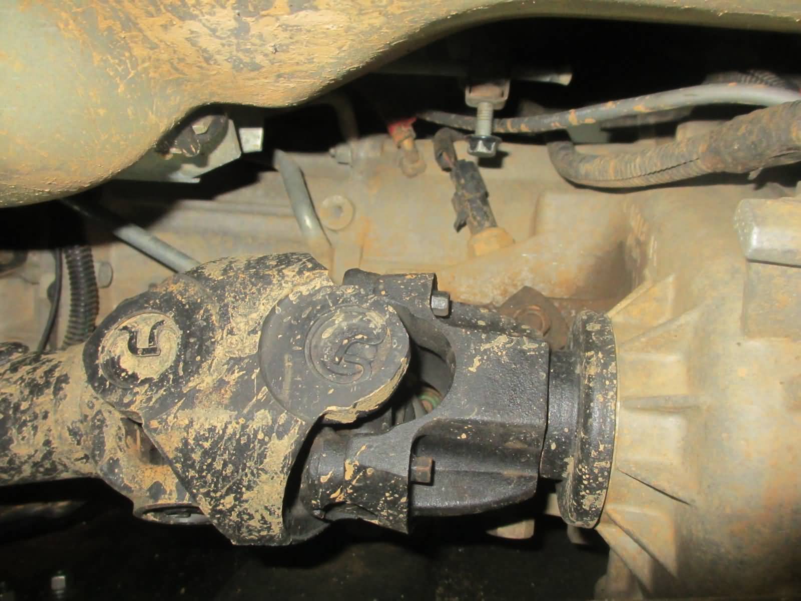

Start by removing the 8 bolts that hold the driveshaft to the transfer case. This is a view from the side, and you can see two of the four bolts to be removed.

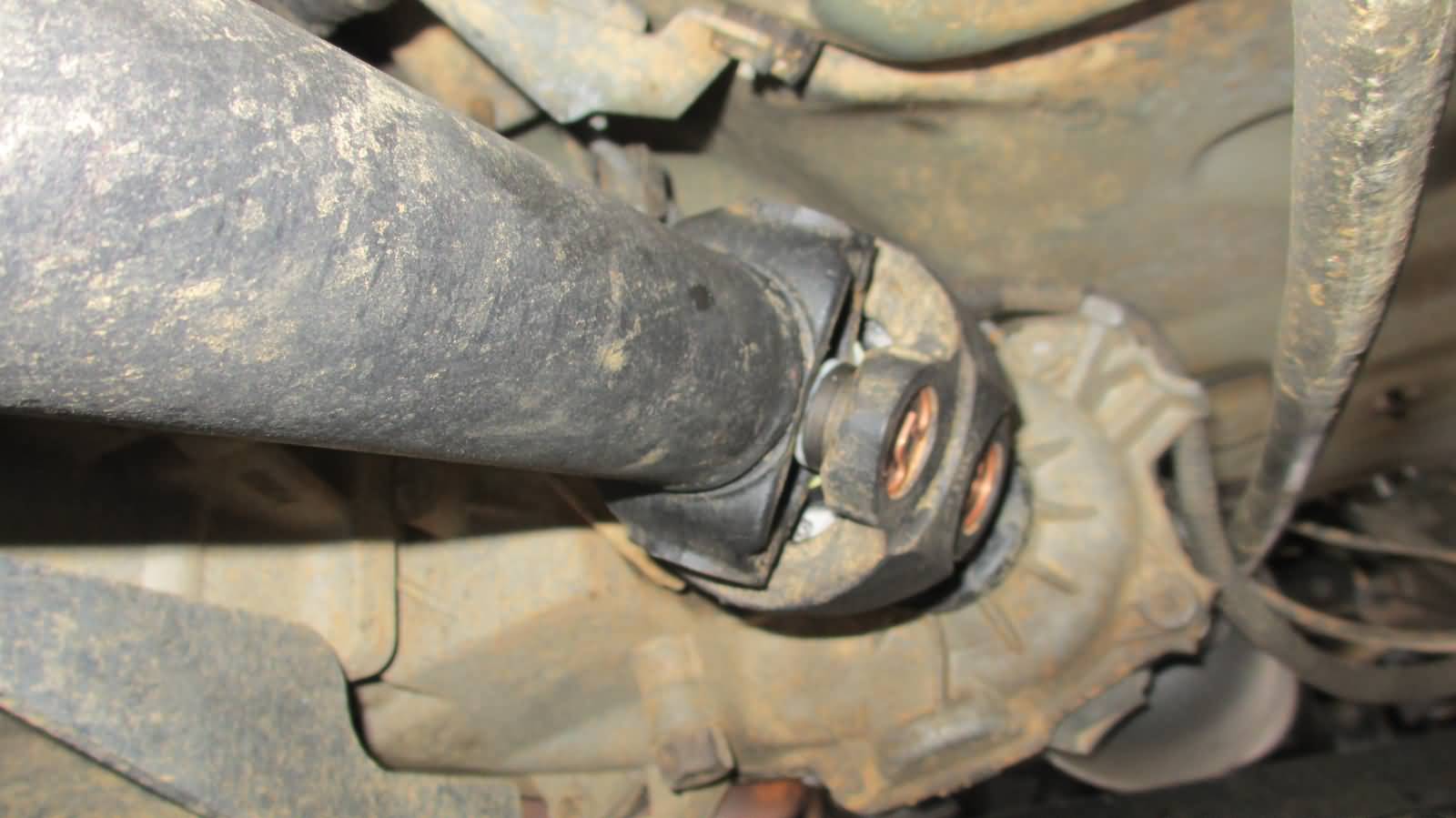

As you can see from this picture there isn’t much room to work. I found it easiest to remove the two bolts that I could reach, then pull the Jeep forward 12 inches, which would rotate the driveshaft, and the two remaining bolts would become accessible.

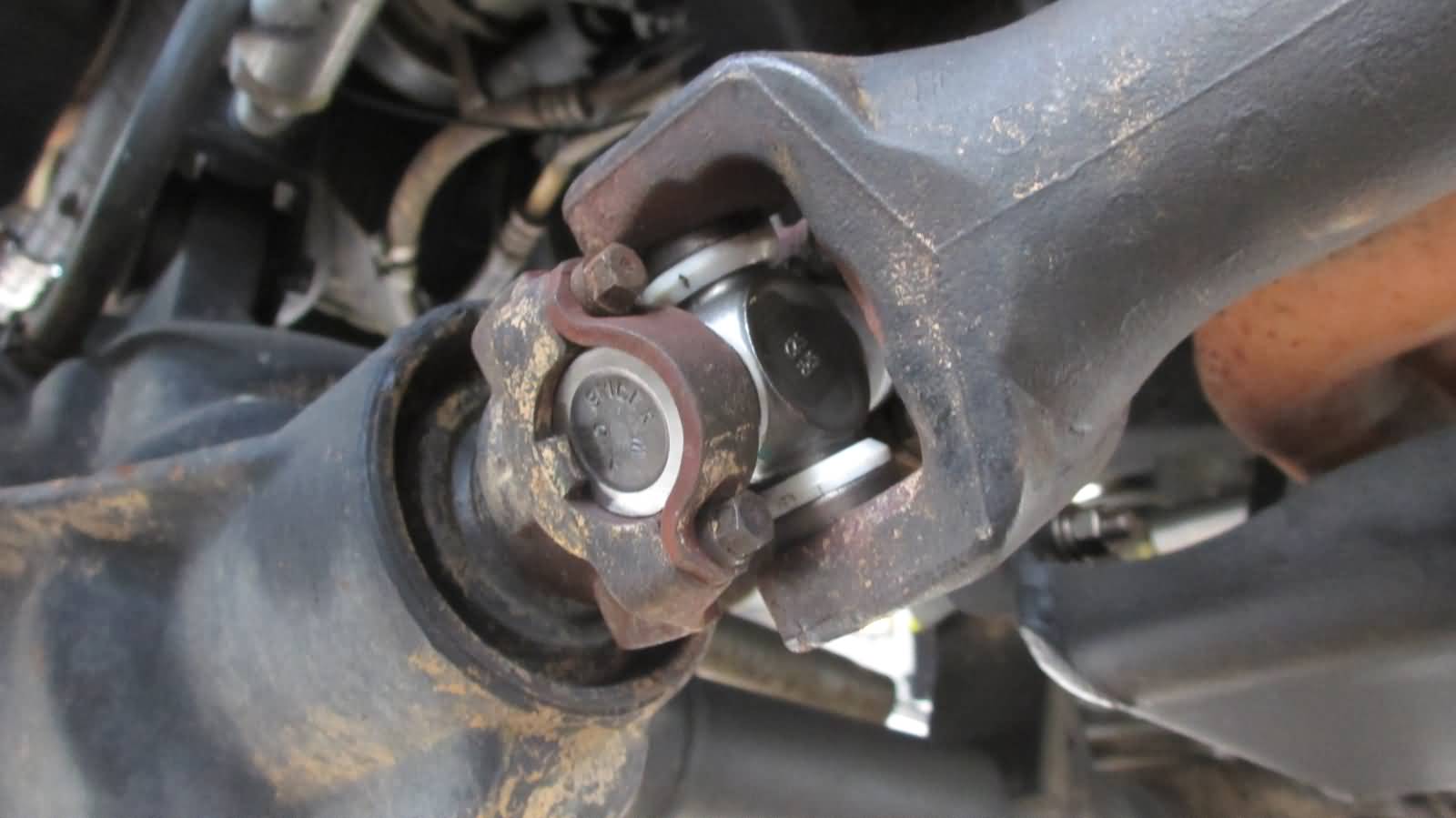

Once all four bolts were out, I removed the axle side (it’s held on by 4 bolds in a similar fashion). Be careful at this point not to let the driveshaft fall on your head. It’s heavy, and the ER can eat up all your Jeep money.

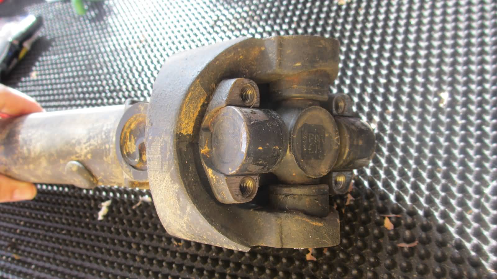

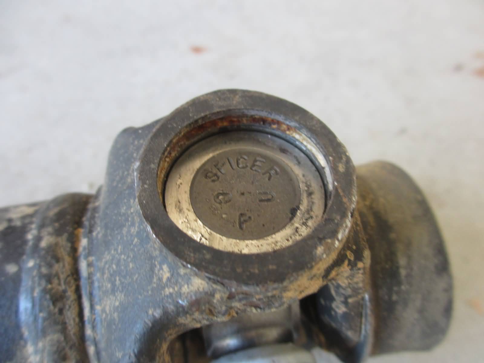

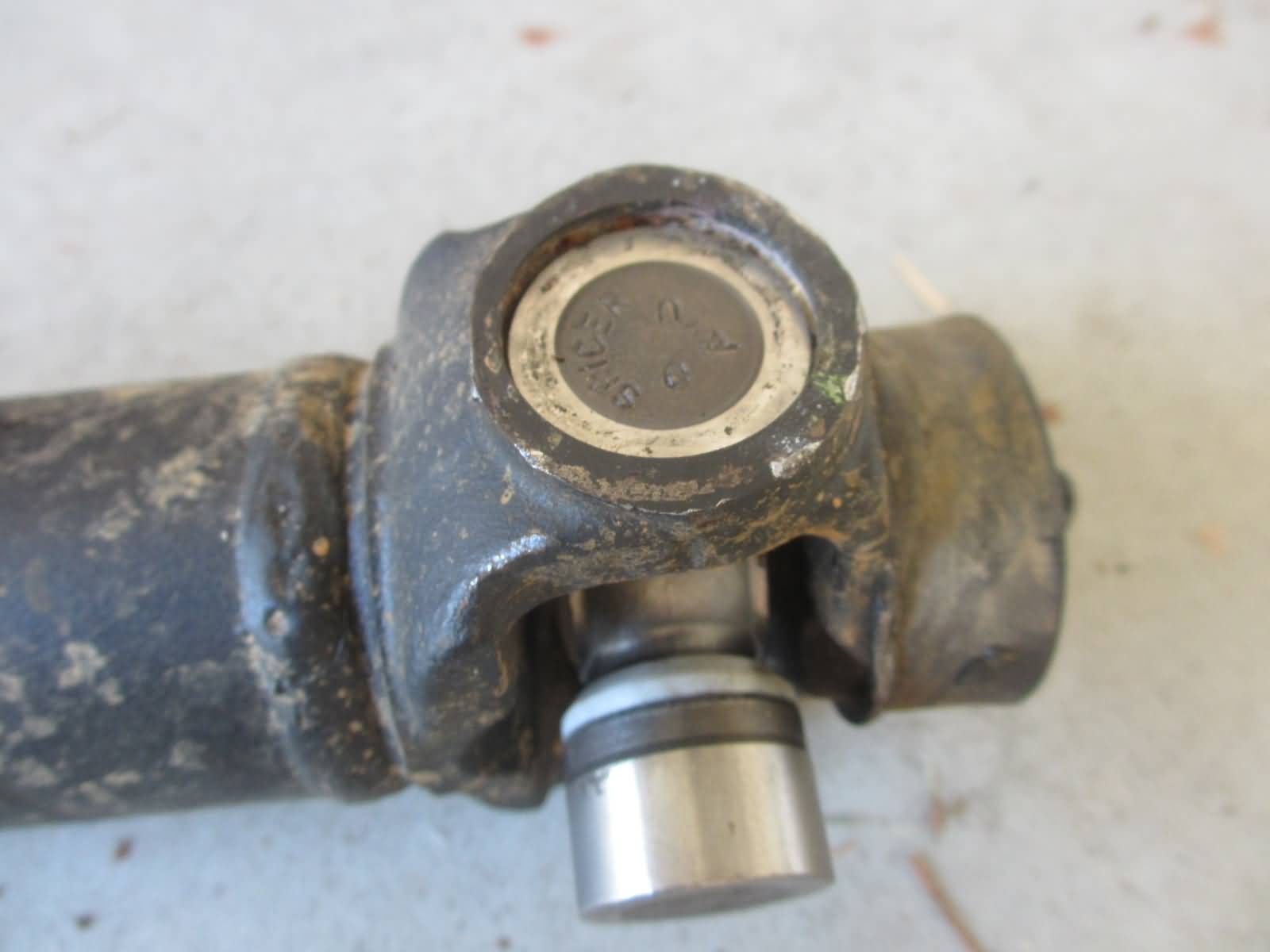

I noticed right away that these u-joints were long overdue for replacement.

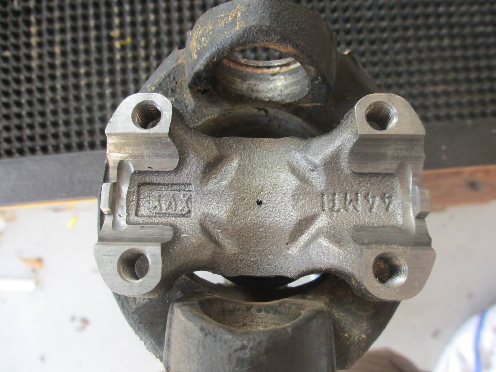

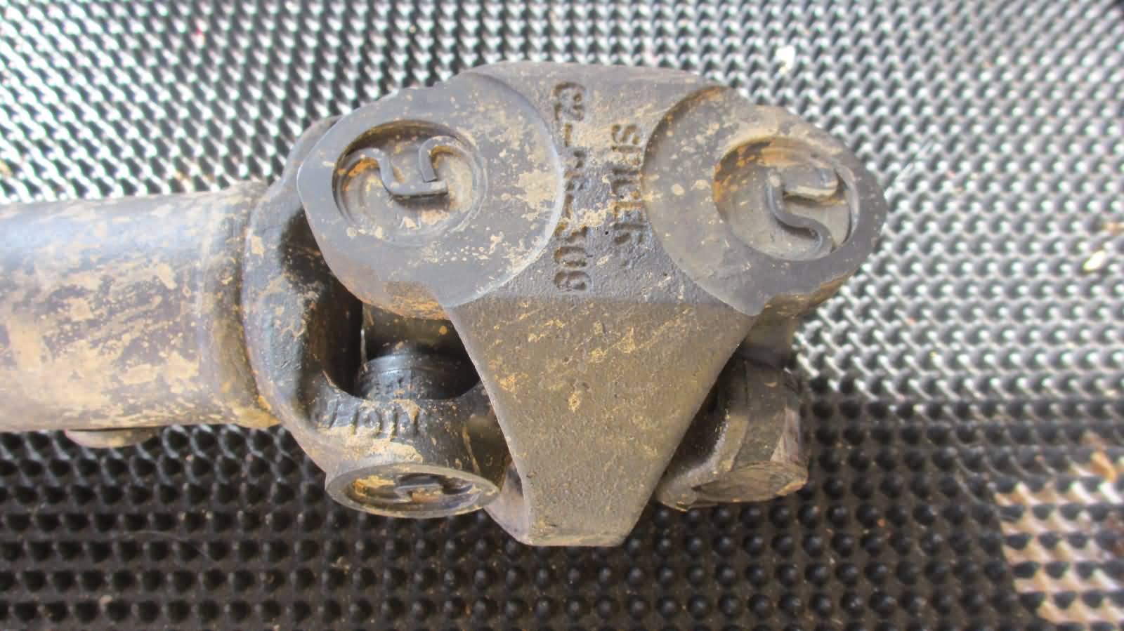

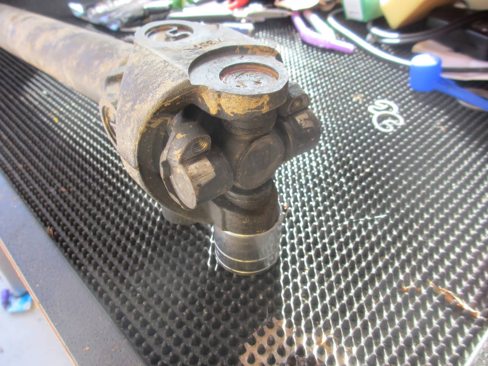

Here are some photos of the CV / double cardan portion of the driveshaft
At the end, you can see the ball centering unit’s ears, behind the outer u-joint

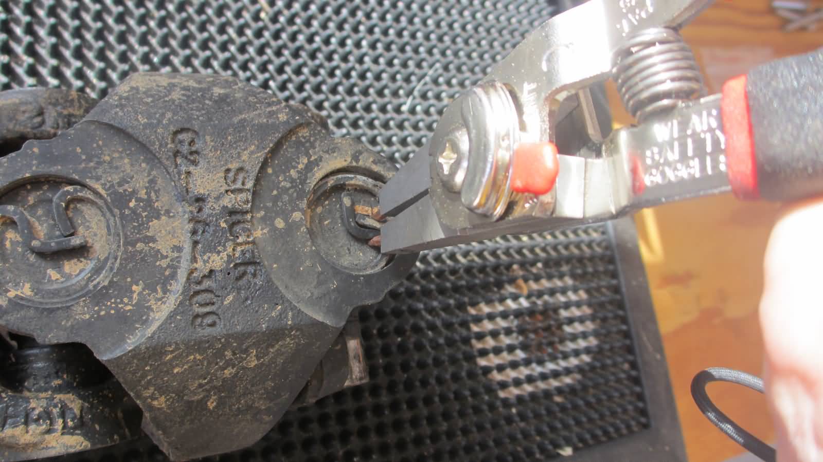

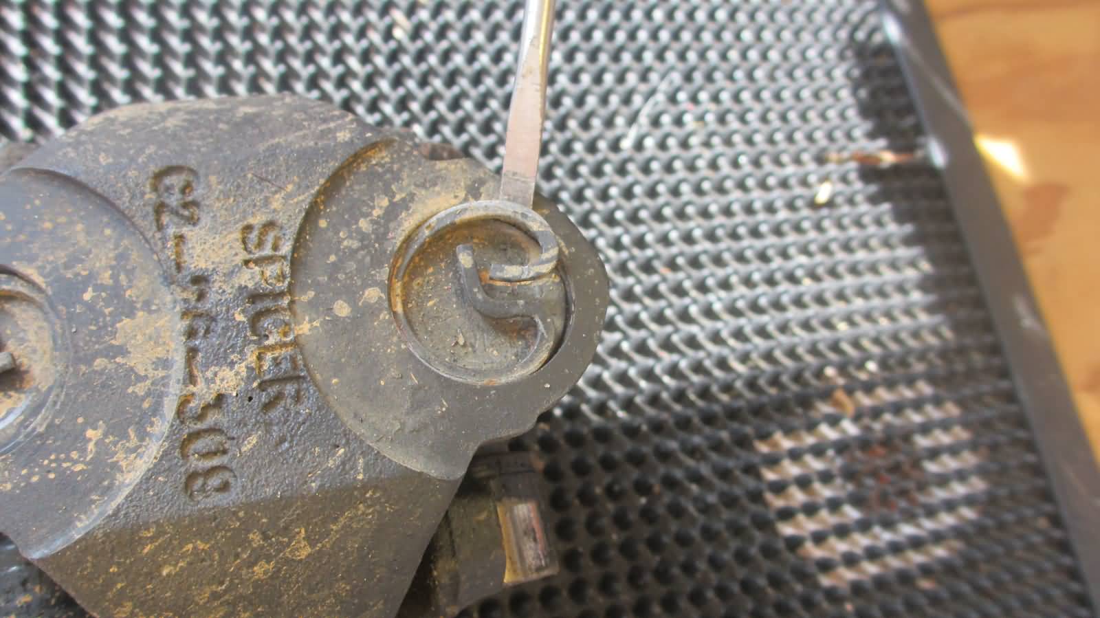

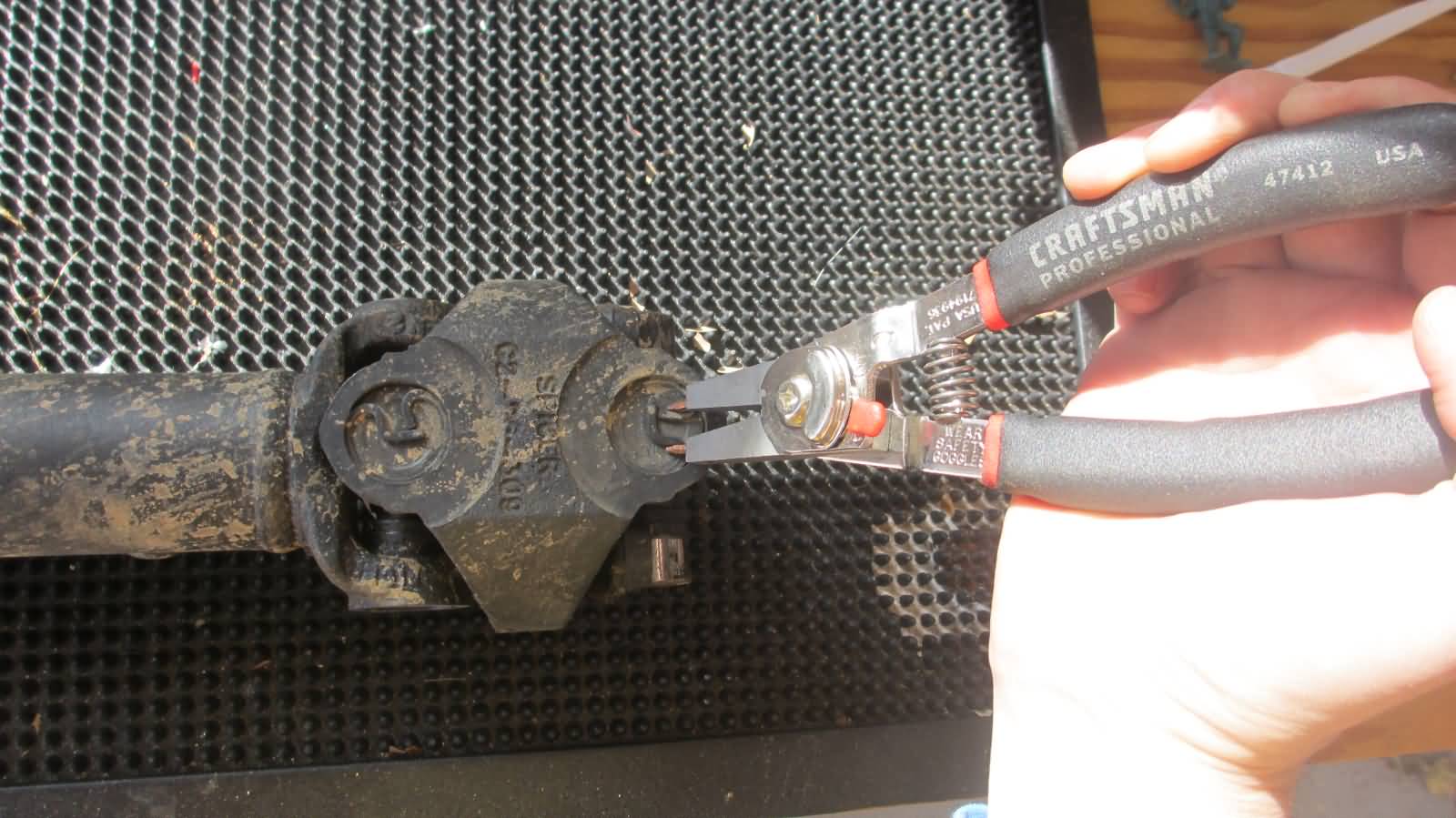

Just use a pair of snap ring pliers if you have them – if not needle-nose pliers should work, and remove the snap rings from your u-joints.
Just compress the snapring
If it doesn’t pop out, you can use a flat screwdriver to help it out. Careful, it will fly out (and halfway across the room).

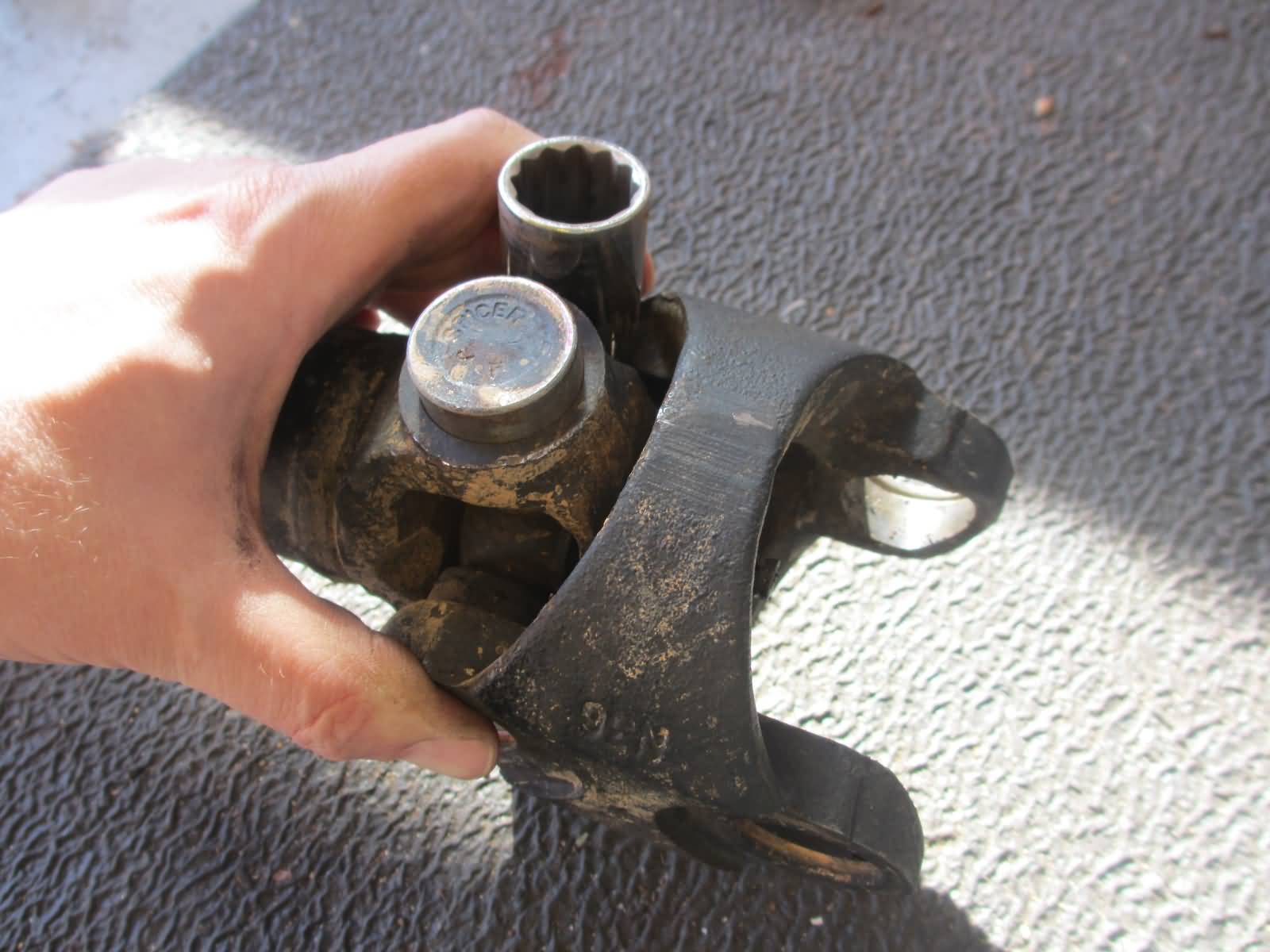

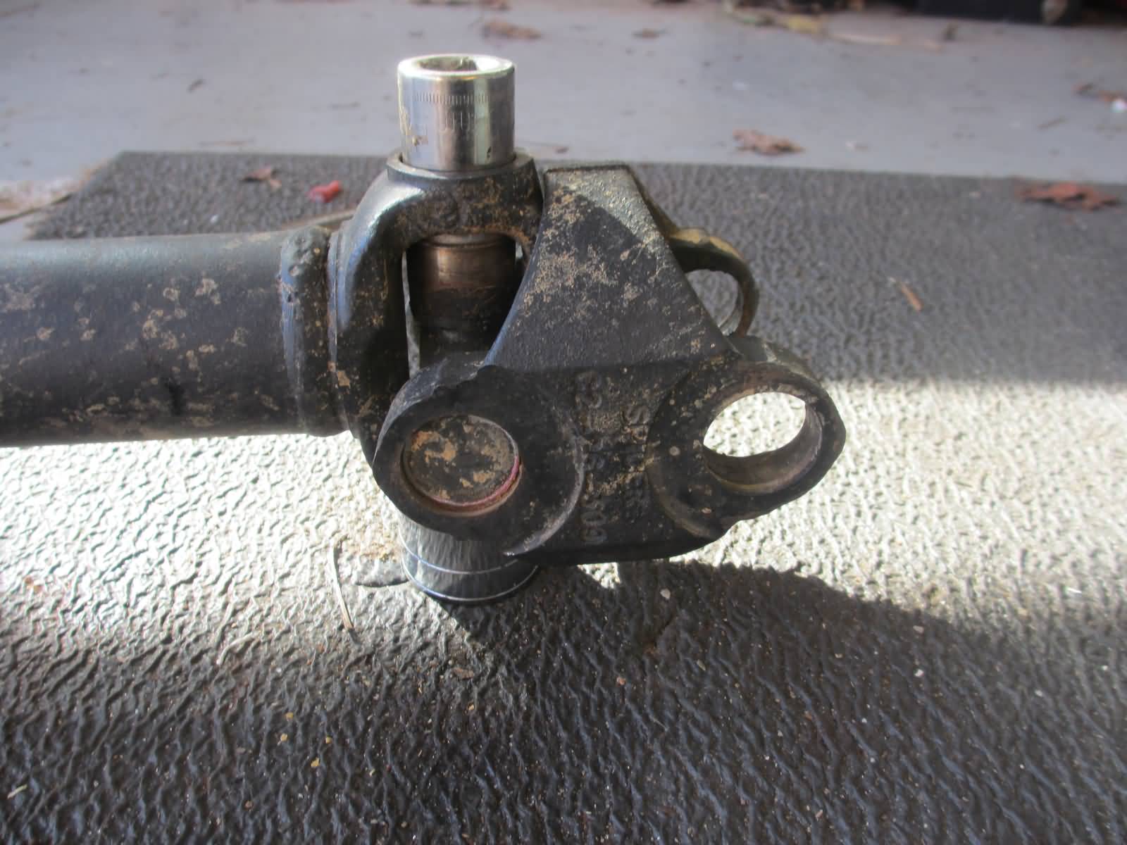

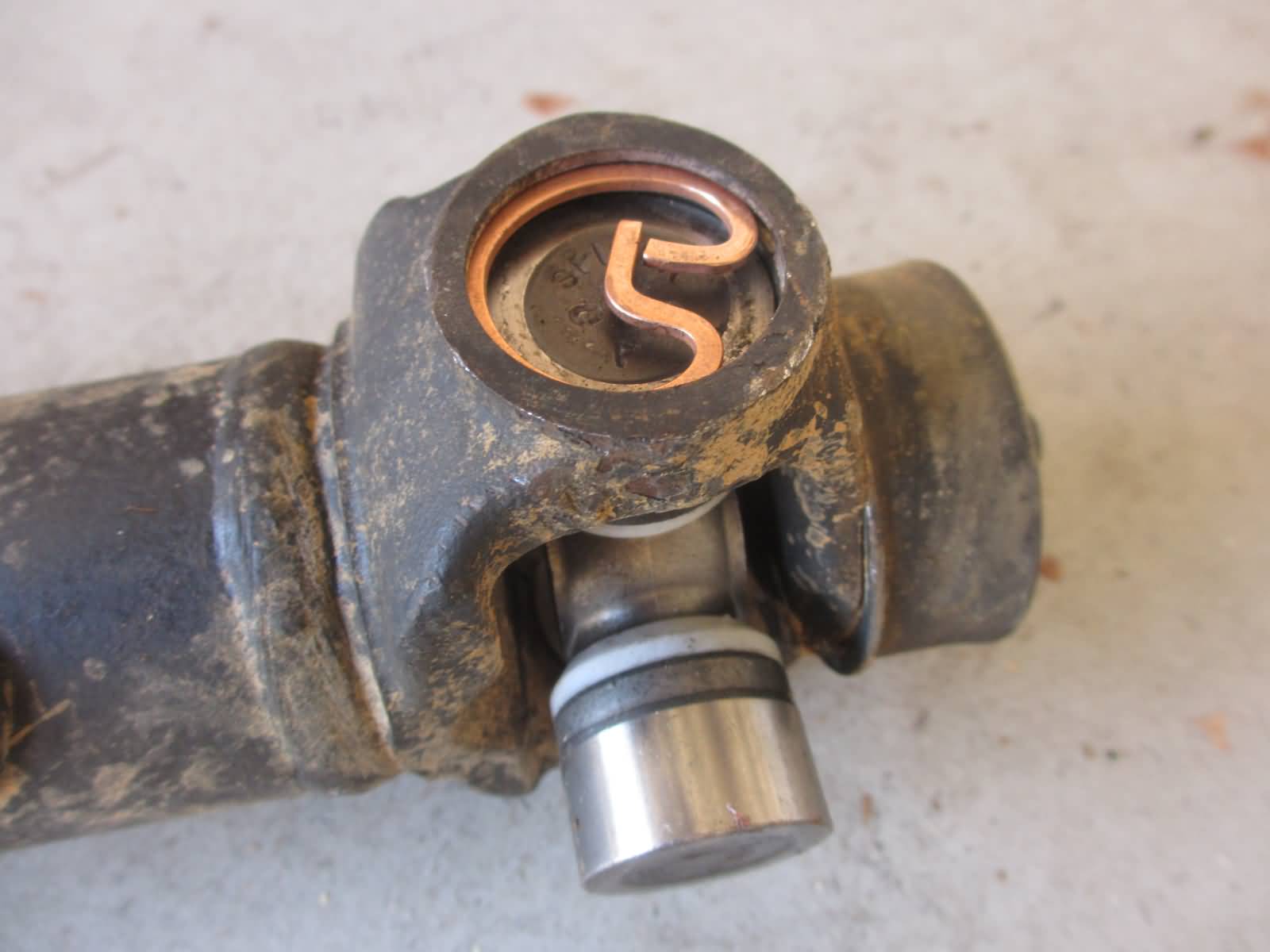

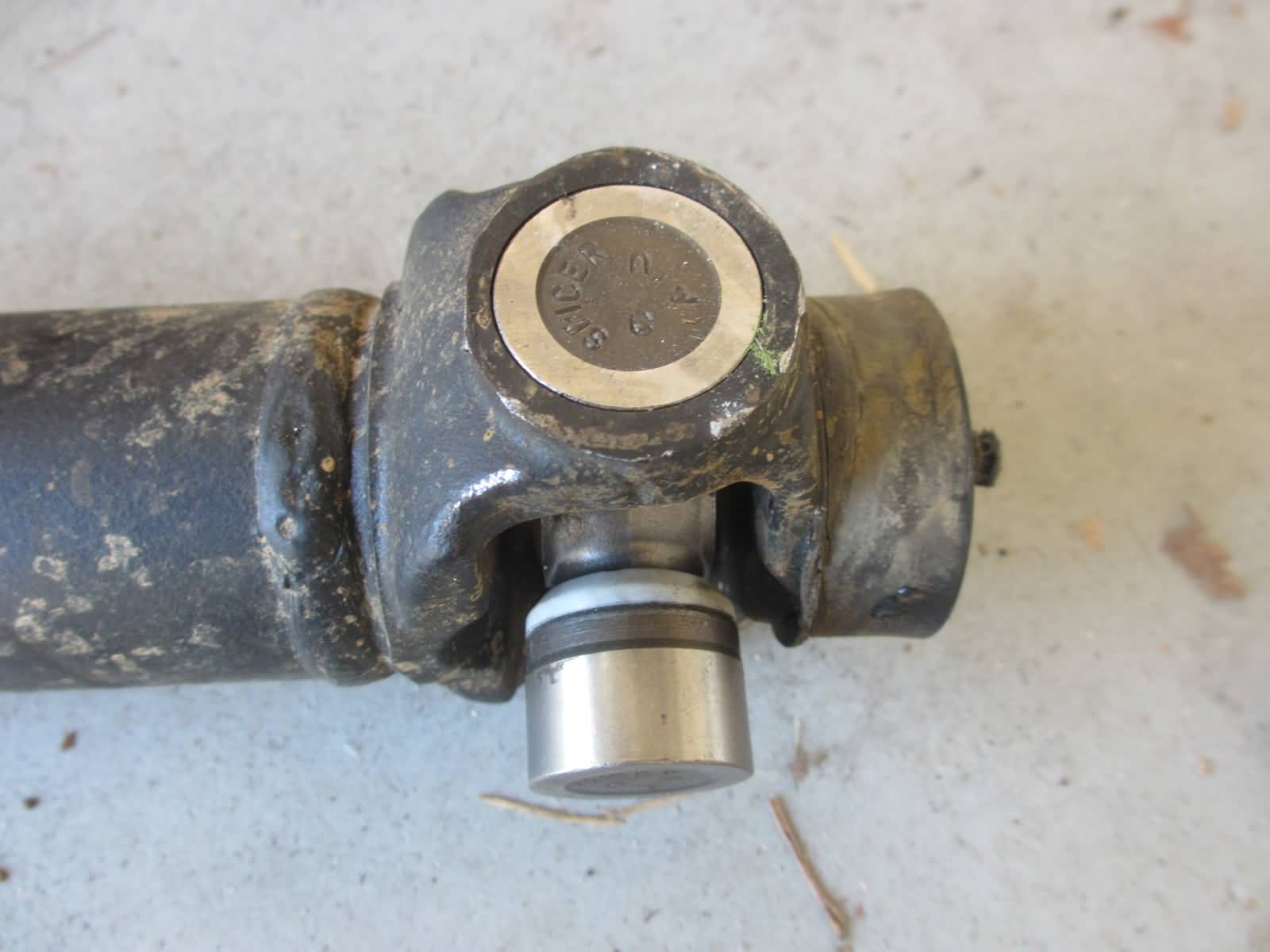

Once you have the snap-rings removed from each side of the u-joint, it’s time to pull the joint out. There are several ways to do this – most people will use a u-joint press. I decided to try a big hammer instead.

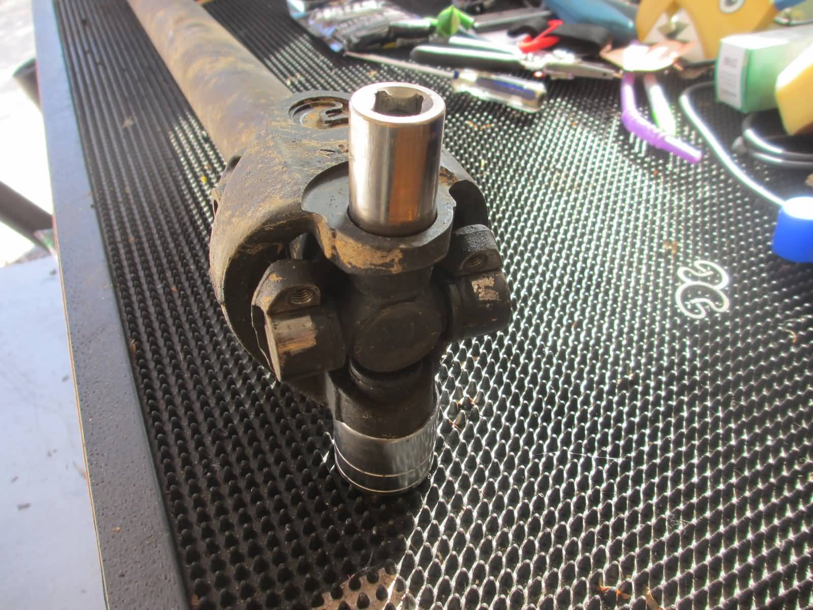

I found a large socket that was larger than the u-joint cup, so that when I pounded it down, the u-joint cup would go into the socket.
I then put a socket on top of the u-joint that was slightly smaller than the cup
And give it some good whacks
You can see here that I’ve pushed the u-joint as far down as it will go. You just take some pliers and pull off the exposed cup. After that, you flip the joint over, and use your smaller socket to pound the joint down, and remove the second cup.

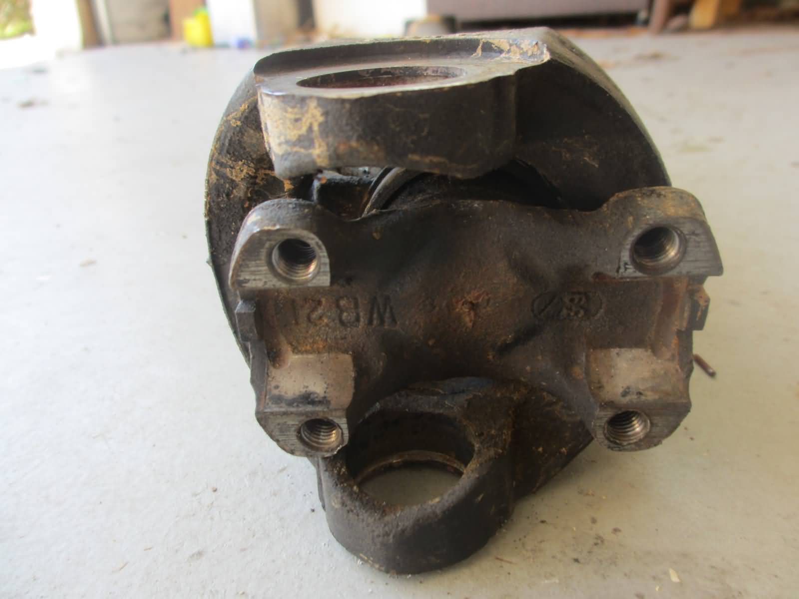

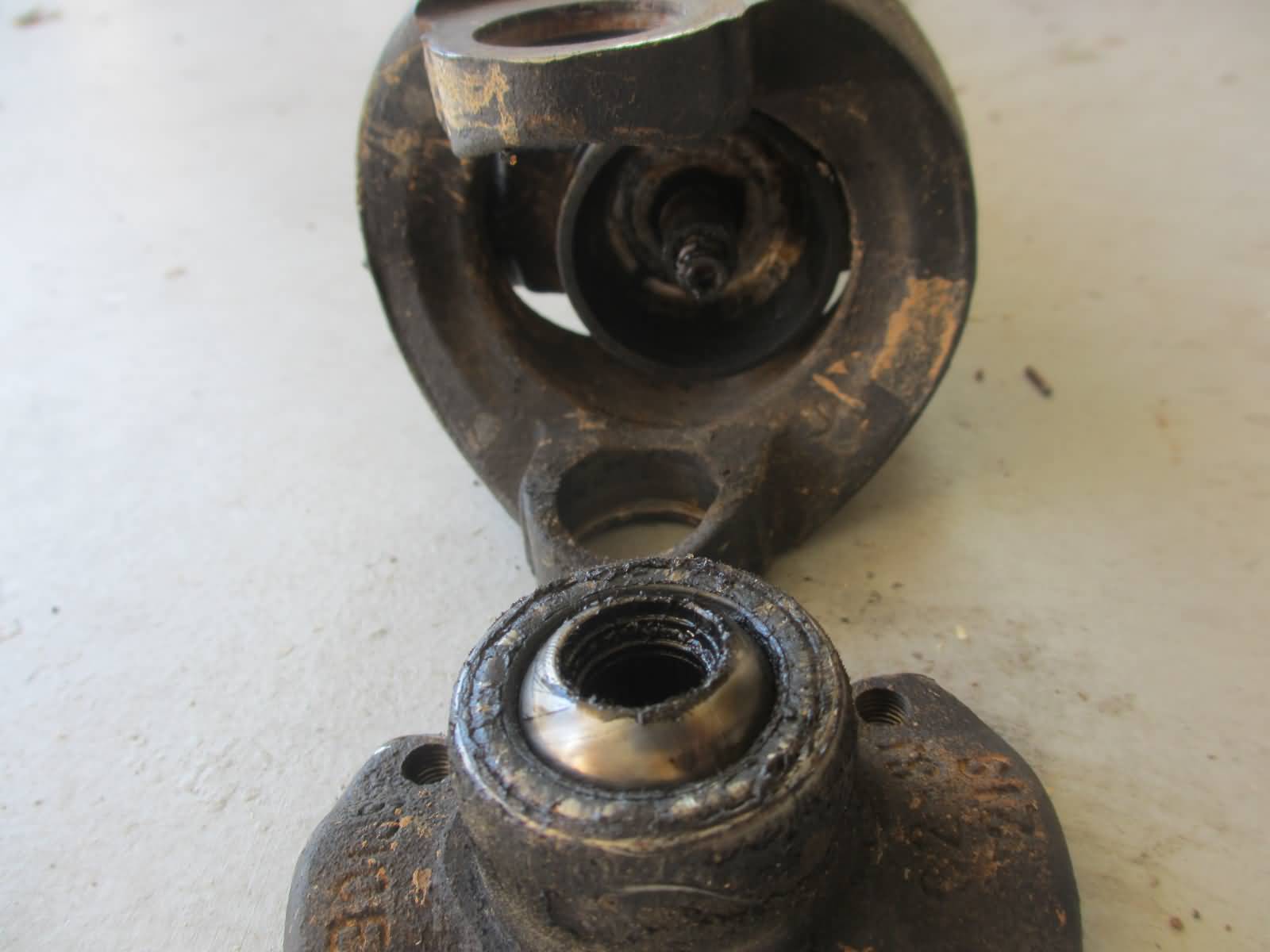

Here you can see the ball centering unit (after the outer u-joint is removed). At this point it just falls off – the u-joint was the only thing holding it on. Keep in mind there is a spring that is easy to lose if you’re not careful.

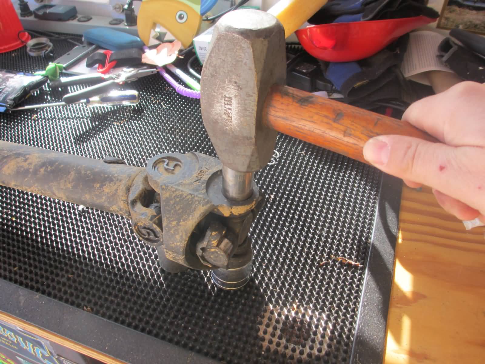

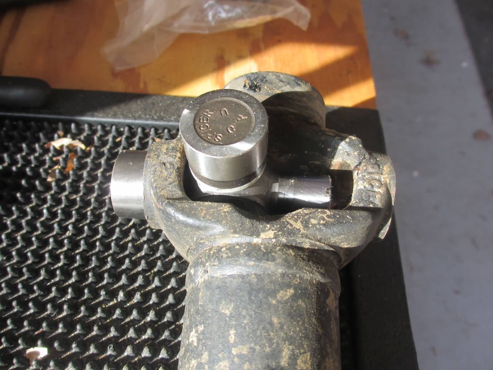

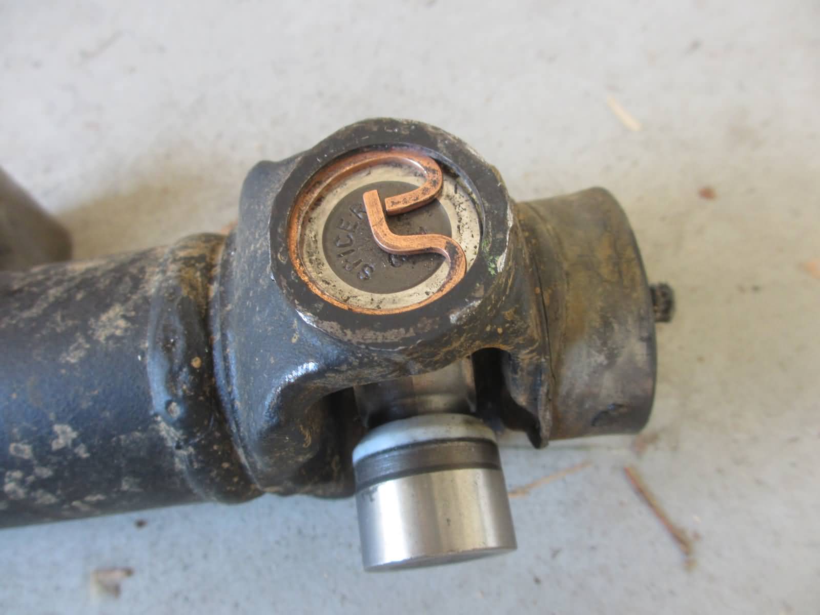

Now it’s time to remove the inner u-joint. I set things up the same way – large socket on the bottom, smaller one on top. I then whack it until the joint bottoms out.
I then flipped the driveshaft over, and used my pliers to pull the cap off. I pounded down the other side, removed its cap too. Finally, I repeated this procedure on the connecting piece.

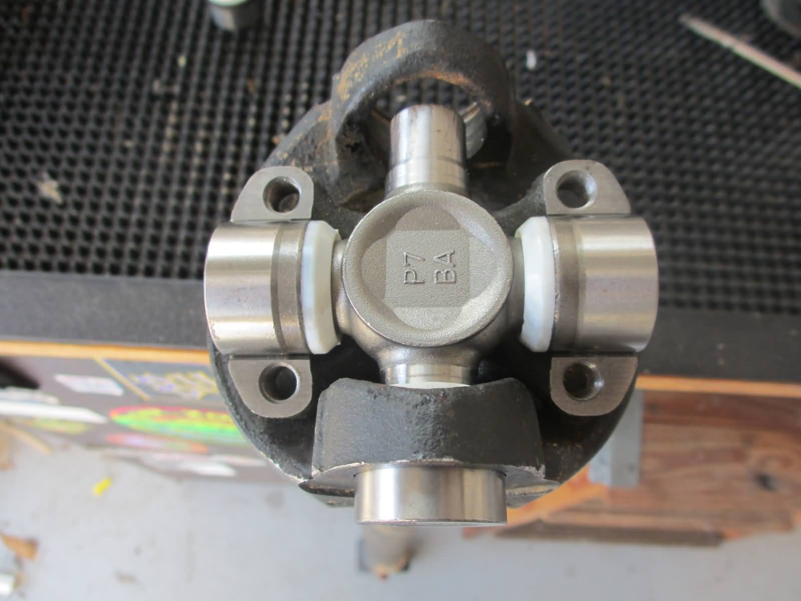

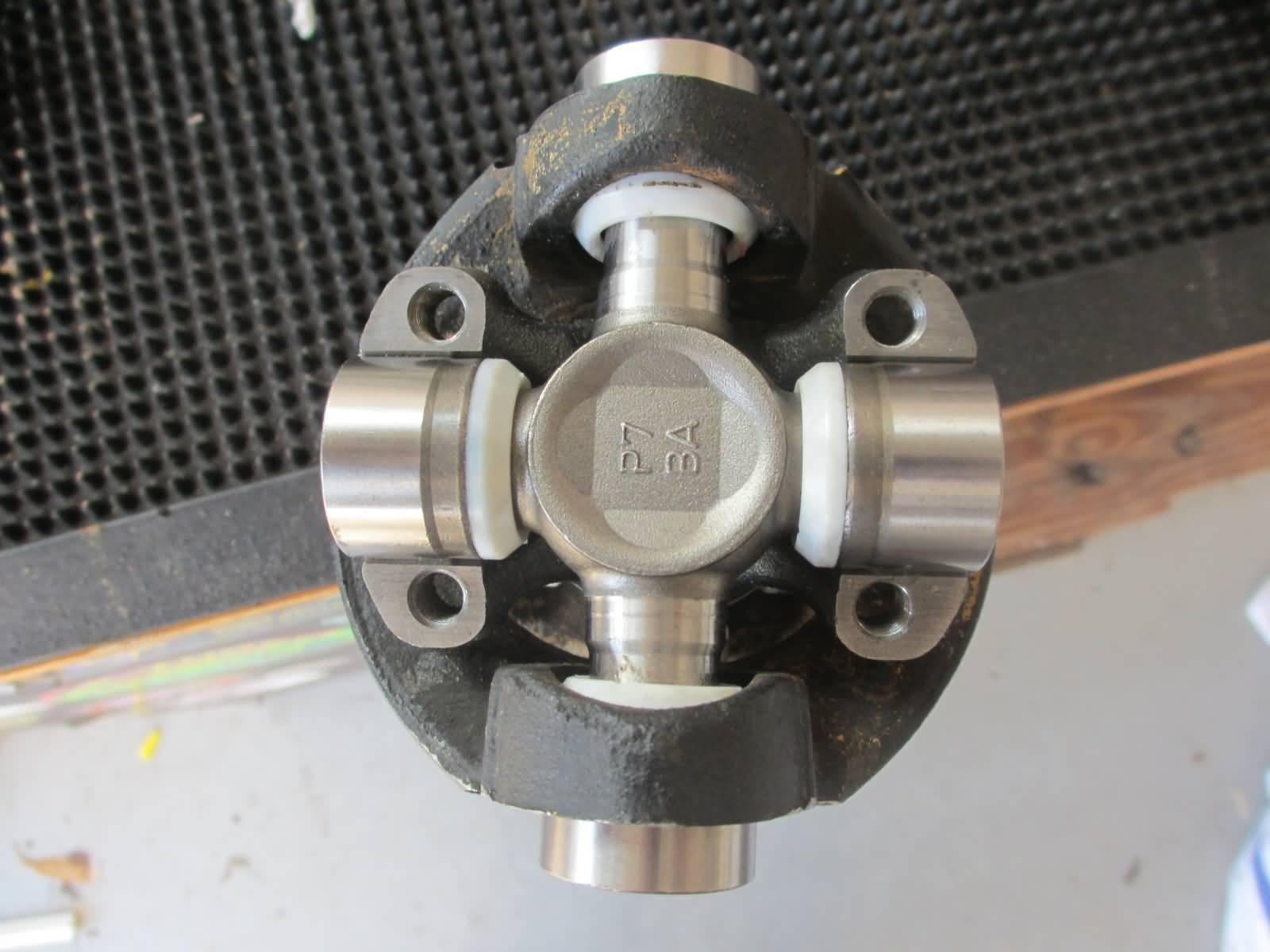

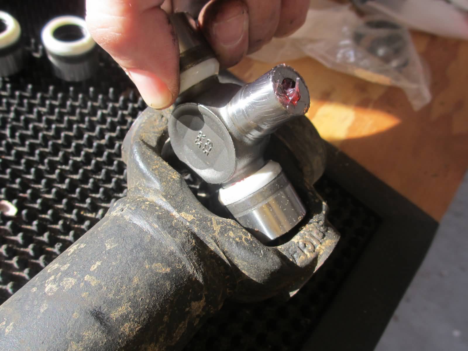

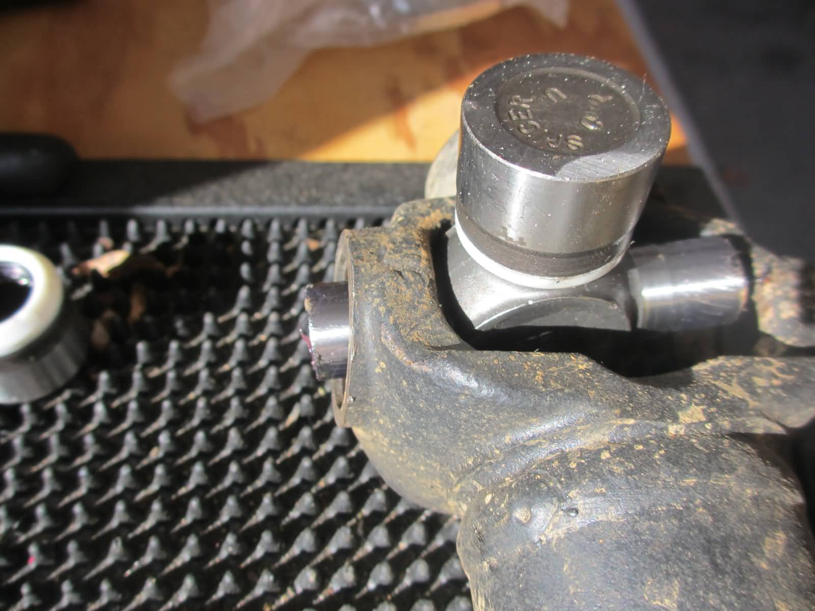

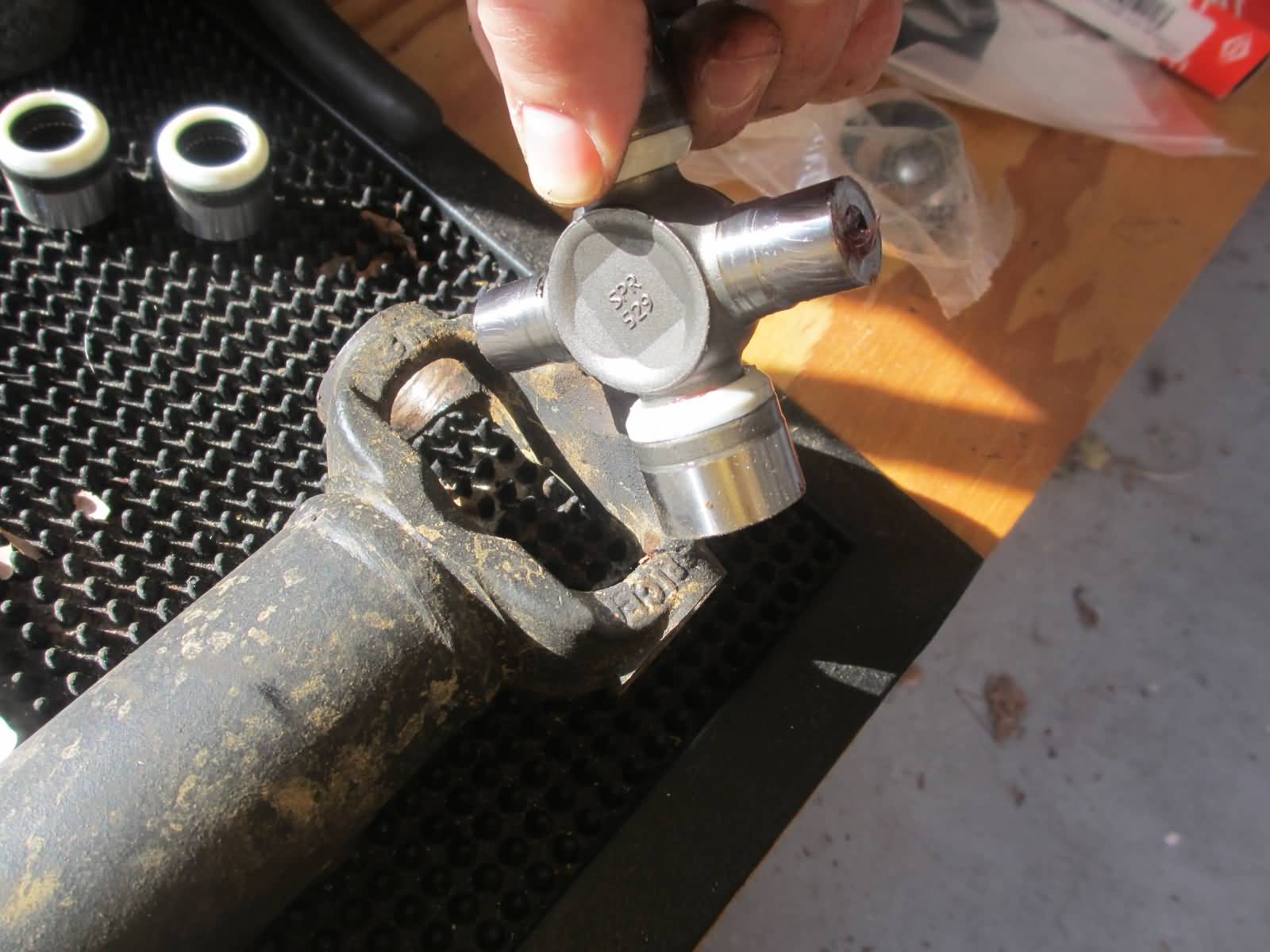

You’ll want to very carefully pull two caps off of your new joint, and insert it into the driveshaft. Be sure not to let the pins fall out of the cap (it’s fairly well greased, so as long as you don’t drop it, you should be fine). Also, try not to get the exposed u-joint arms dirty, as grit inside your u-joints is not a good thing.
Once in place, carefully slide the cap onto your u-joint from the outside. Keep in mind that you want the pins lined up around the inside of you cap, and you don’t want to knock them down.

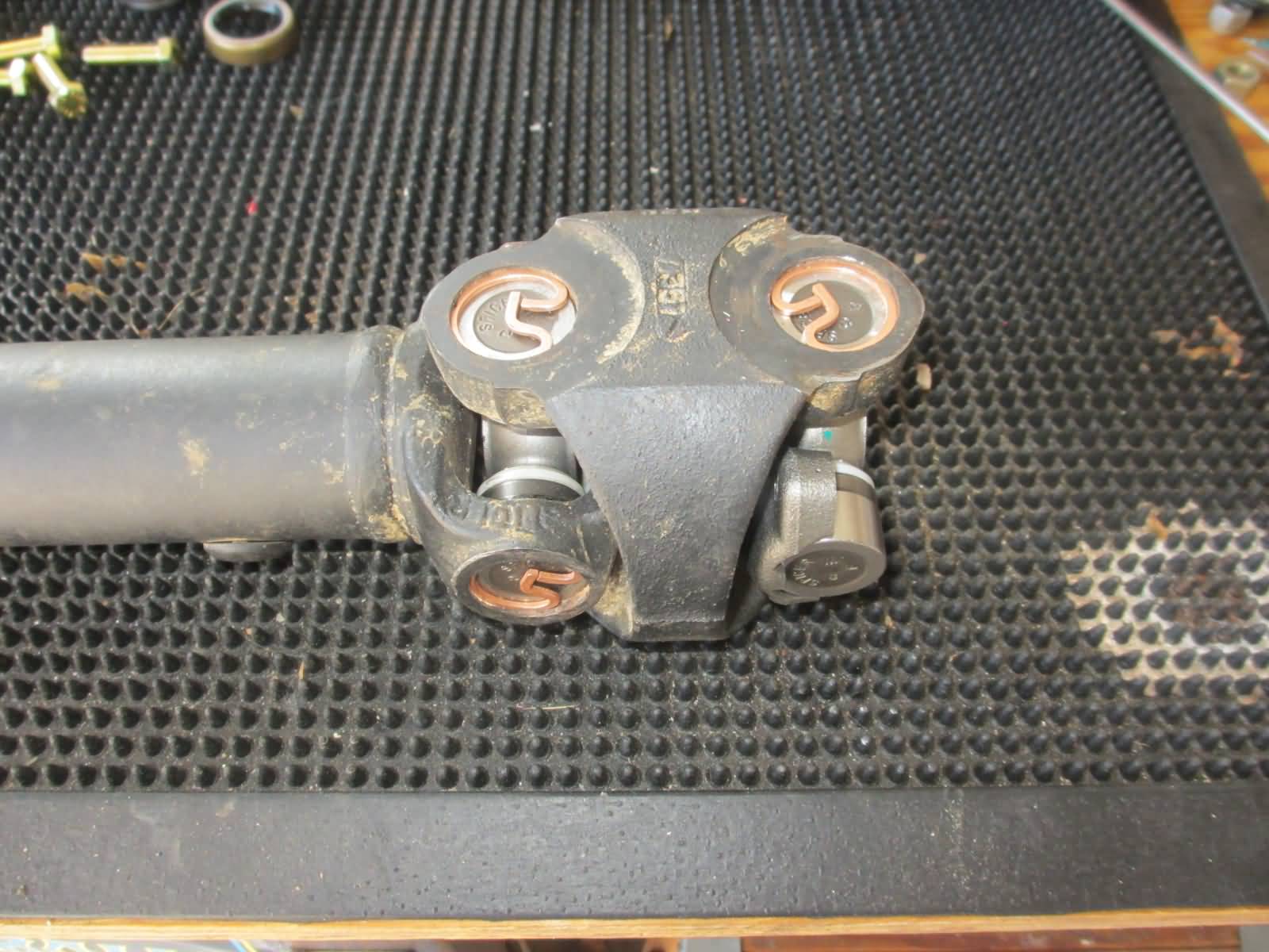

Now, put the cap on the opposite end, and gently tap it into place with your hammer. Here you can see the u-joint in place

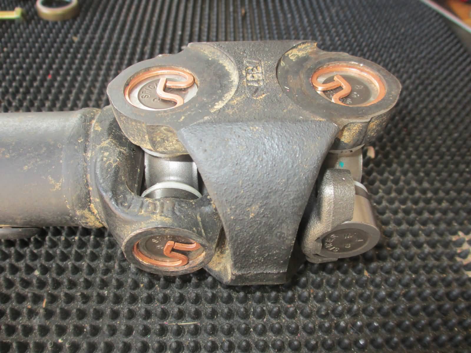

I then tapped down the cap some (probably more than I needed), and put the snap ring on
Flip the driveshaft over, and do the same thing

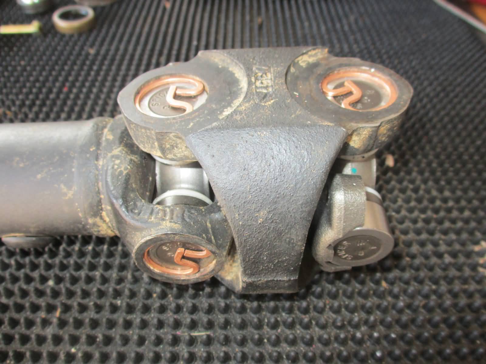

Now, do the same thing with our connector

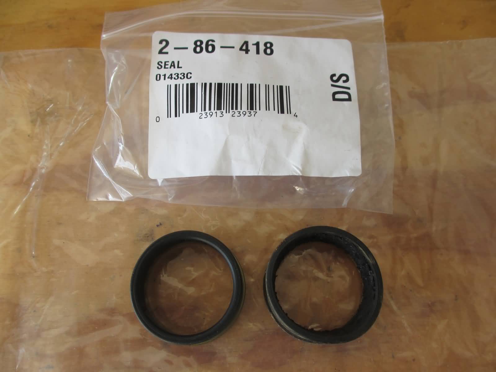

I went ahead and replaced the rubber boot on my driveshaft – this is optional, and actually turned out to be one of the most frustrating parts of the whole install. The rubber boot has a metal collar at the bottom – you should be able to simply slide the boot on, but in my case it just wouldn’t go. I ended up destroying one boot by trying to use a screwdriver to tap it into place. My advice is to take your time.
The new boot is on the left, and the original is on the right
And the boot / seal installed

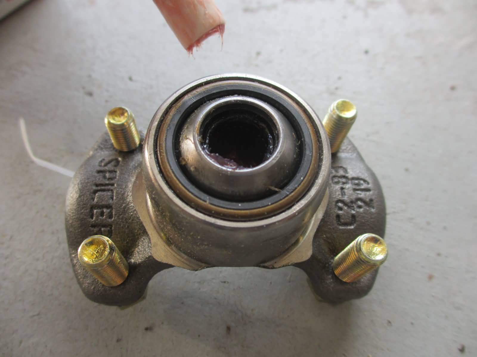

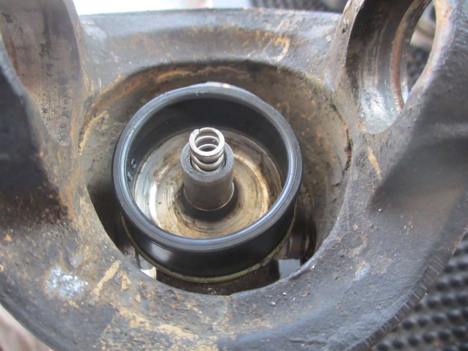

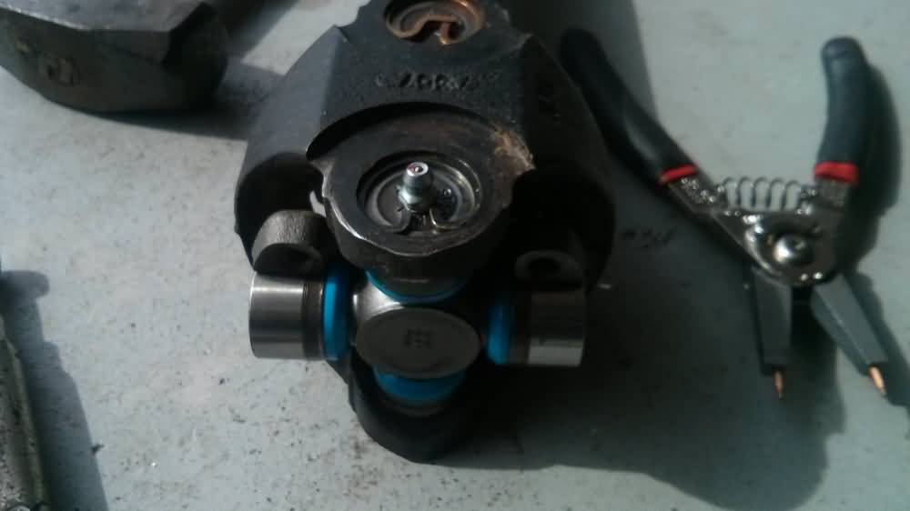

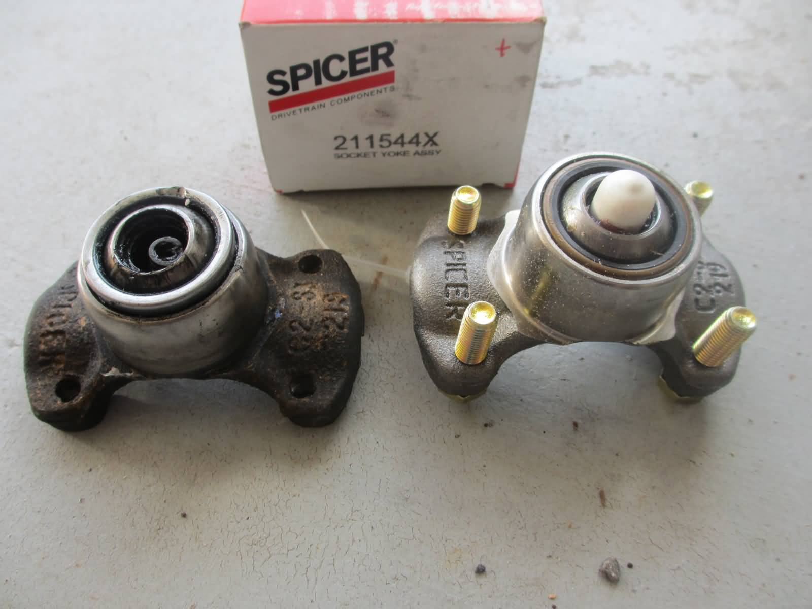

Next comes the ball centering unit / socket yoke assembly. I went ahead and replaced mine. Here you can see the old and new ones (the new one came with new bolts.
Just pull out the white plastic plug – it’s there to keep grease in, and debris out.

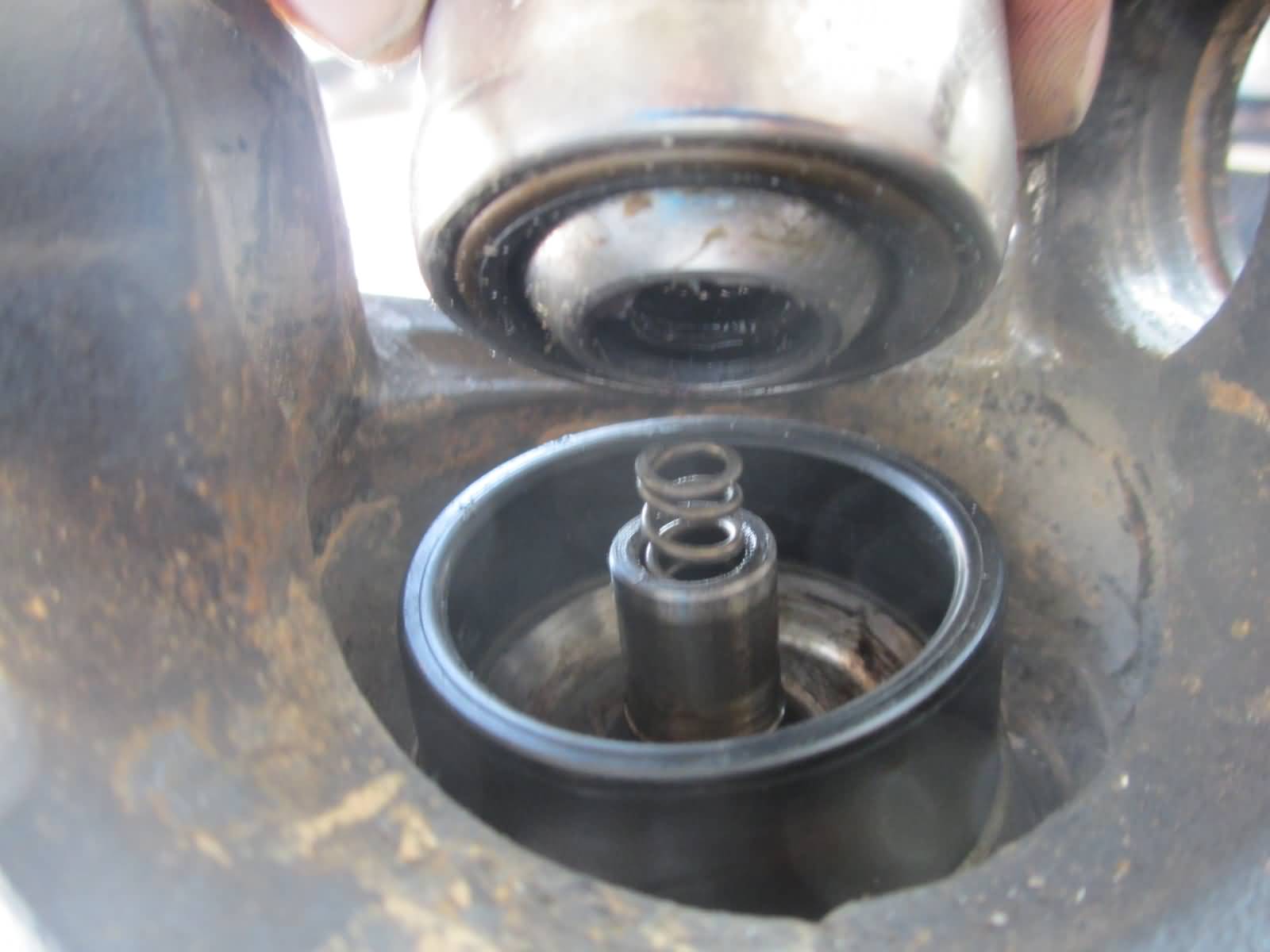

With the spring sitting in its spot on the driveshaft, put the yoke assembly in position.
It isn’t actually bolted to anything – the final (outer) u-joint will hold it into place
Now, put the u-joint clips in place for the outer u-joint
At this point the rebuild is done, and you just need to re-install. I started with the axle end, then moved onto the transfer case end.

A run of the mill Jeep will have two driveshafts – a traditional driveshaft in the rear, with a ujoint on each end, and what’s called a dual cardan driveshaft in the front. A dual cardan driveshaft has one ujoint on the axle end of the driveshaft, and what amounts to two ujoints at the transfer case side.
