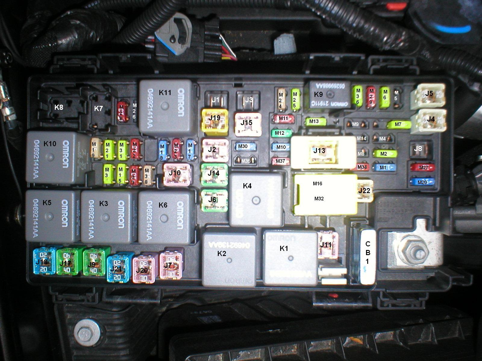

This is a repost to correct two minor cosmetic errors in the original thread. (I don't have edit permission on the original thread, so moderators, please delete the original thread so as to not clutter up the board... sorry for the hassle).
Since the fuse layout map on the inside cover of the fuse box is tough to read for those of us with older eyes, and since there have been several threads requesting such a diagram, I thought I'd go ahead and post this for whoever finds it useful.
See attached image below... if you click on it twice, you'll see the large version.
I've also included the fuse listing from the owner's manual for convenience.
If anyone sees any mistakes, let me know immediately and I'll fix it. Note that this is from my 2-door JK 2009... I don't know if there are any differences between the 2-door and the 4-door, nor if there were any changes between 2007 or 2008.
