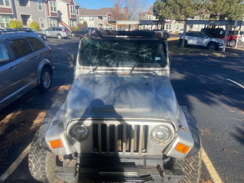

The jeep doesn't look horrible, except the windshield frame and two broken windows. Fenders are bent and hood is bent but not enough to rub the wheels or anything so hopefully this is a cheap fix.

Vacuumed all the broken glass out and other than the windshield frame and glass being destroyed, not to bad.
I just pulled the fenders straight and made sure everything works. It needs an alignment very slightly but I have to d I've straight down the street and make sure the wheels aren't all wobbly now, make sure no bent axles or axle flanges, or anything.

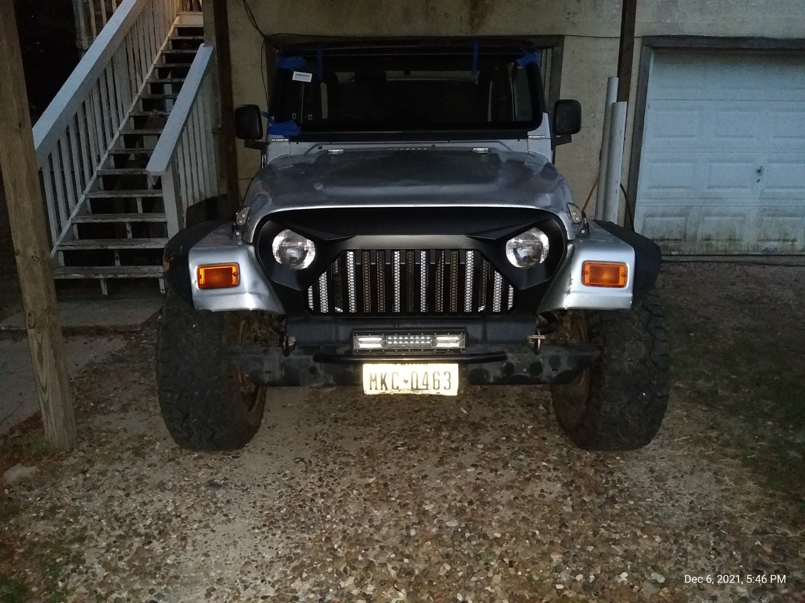

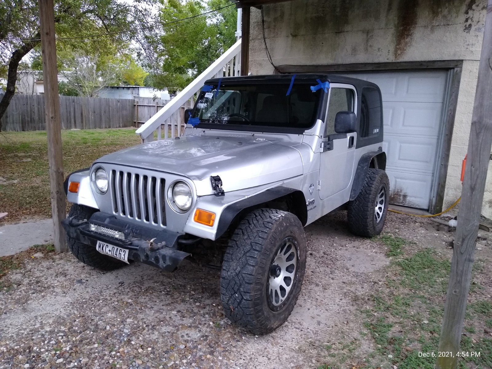

Well, Changed the windshield frame and now the hard top doesnt let the doors close. How weird is that? I am going to unbolt the spreader bars and let the top decide where it wants to sit and hopefully the doors close. The tj isn't as easy to adjust as a yj is
It took all day to adjust the windshield, doors, hinges, and too to get stuff to close properly but it's done. And the new glass was out in earlier so everything is all back to as good as it's going to get for now.

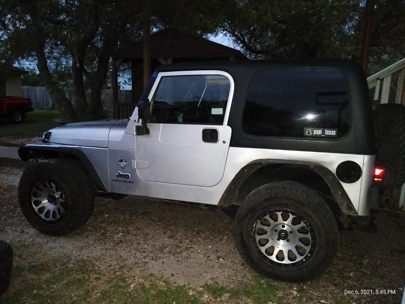

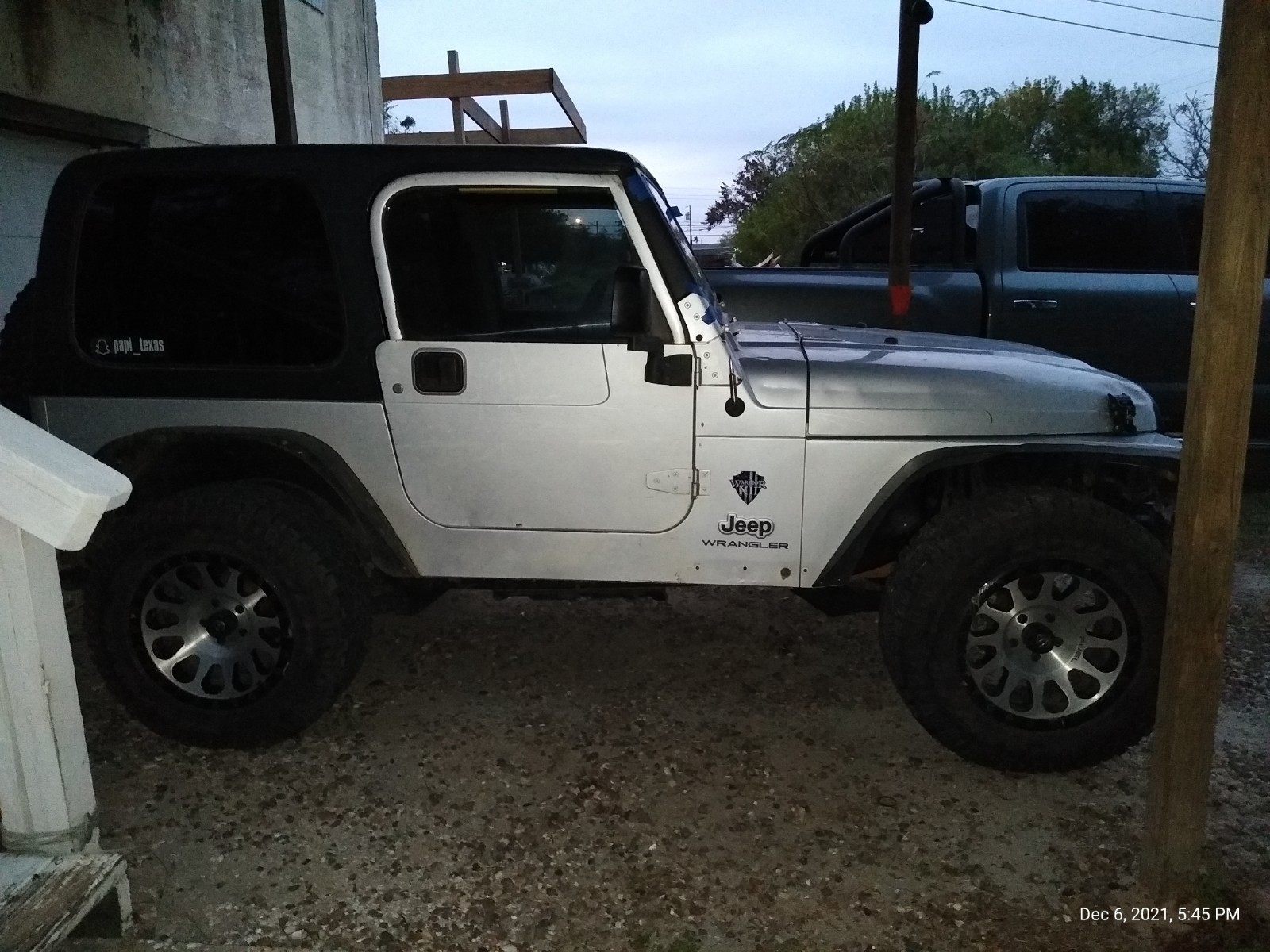

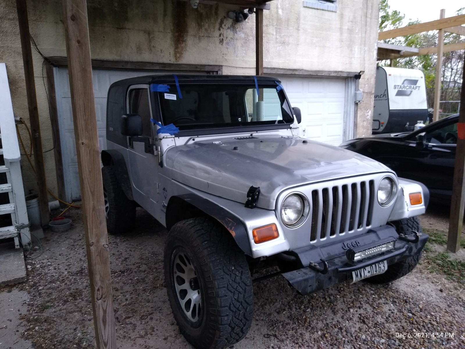

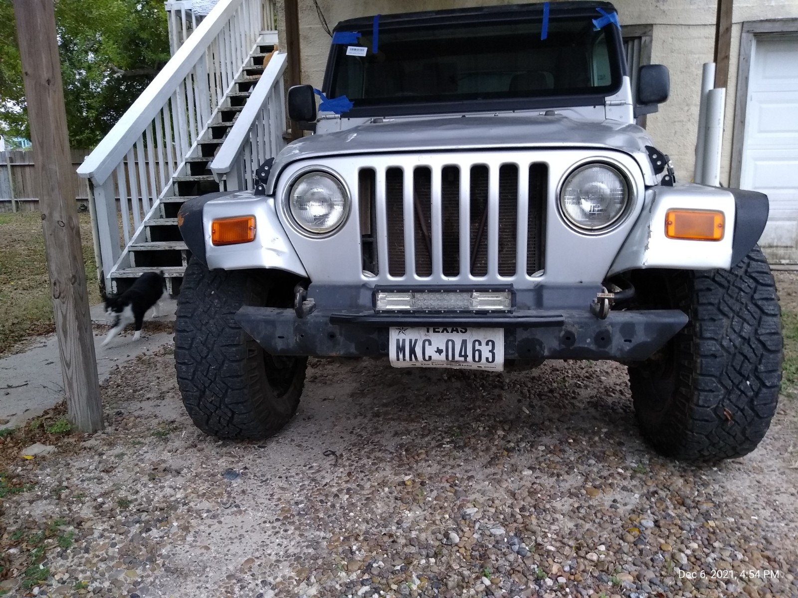

I will post pics after I go outside and take some, ha ha ha
From an iphone on the app?
If so load the pic from the phone. The link from external websites doesn’t work for me on an iphone.
no, it was from my android phone. i am going to try from my work computer now so lets see how it goes

I don’t know the cost or replacing over dent removal. There are shops that can roll out the dents to near perfection.
Of course trail wounds are sometimes looked at like badges.
i think he is going to leave it the way it is. he is about 7 miles from a really good jeep junkyard, fnjeeps, and they have all the parts he needs. he just has to drive over and pick some out. he wants to put tube fenders on the front and will for sure have to get a new hood because this one sits crooked now. but other than that, the rest is still ok. the tub only got messed up in front of the fuel filler door
