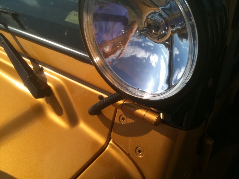

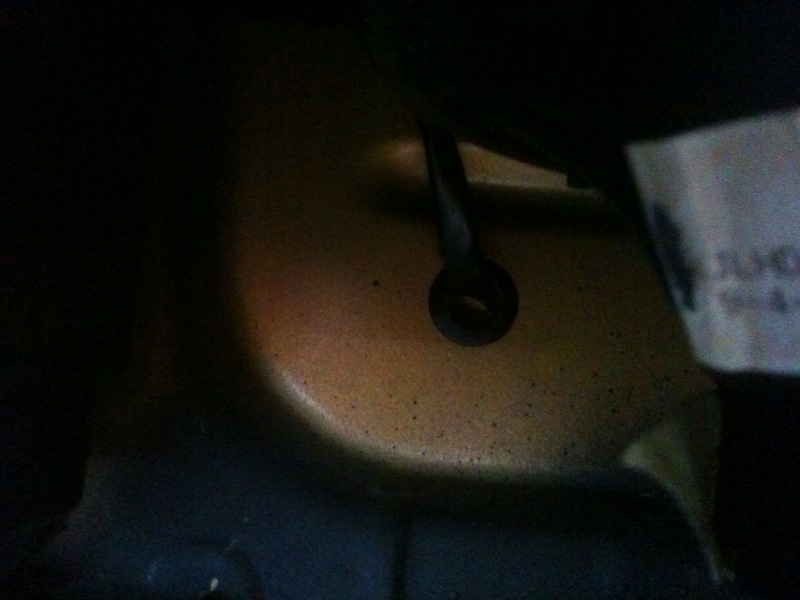

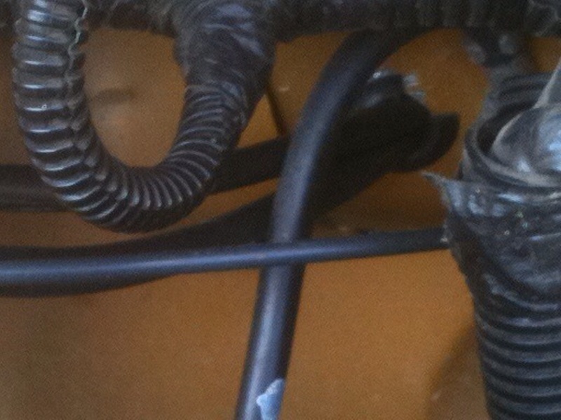

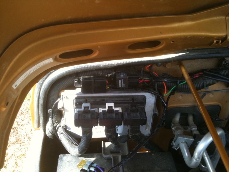

Here are some pics of mine-i am not 100% on this yet,so don't slam me on tidyness just yet!i am outside working on this in spurts as weather allows,but these pics should help!i took tons of pics,not sure how many can be posted,if you like,e-mail me for more!i placed relays(temporarily)above ecm behind battery on passenger side.i drilled a hole to left of huge ground bolt in center,to pass wires from windshield cowl to engine bay,and drilled slightly above/behind heater blower box in passenger footwell area to get inside the tub.again,this will be straightened up some,with grommets done better,and holes sealed up with silicone caulk when i get another decent day!just thought you might benefit from these pics!

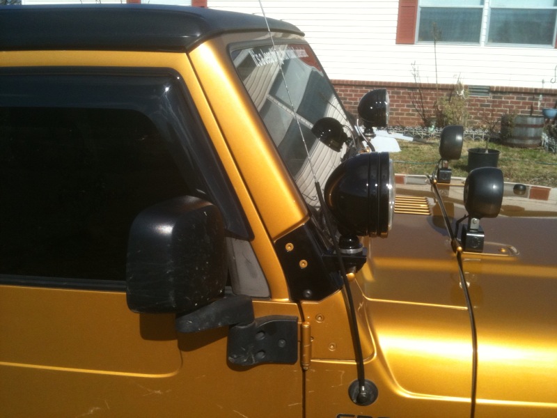

p.s.-to adjust the antenna,just carefully grab it with your left hand at the lower base,then just bend it with your right hand!sounds cheesy,but it worked for me!for good measure,i slid vacuum tubing on the lower part so it won't slap around and beat up the light!eventually i will do a cb style whip in the rear and ditch this one.they do sell short rubber antennas,but they really don't work very well,so i ain't gonna go there!standard antenna length should be 31",or reception suffers!hopefully the pics will explain it!i originally covered the entire antenna in rubber tubing,but i created some kind of aerodynamic nightmare which resulted in the antenna flapping like crazy at highway speed!cutting it down to where it is now alleviated that problem!

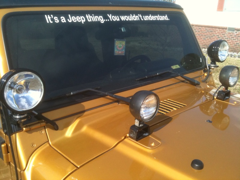

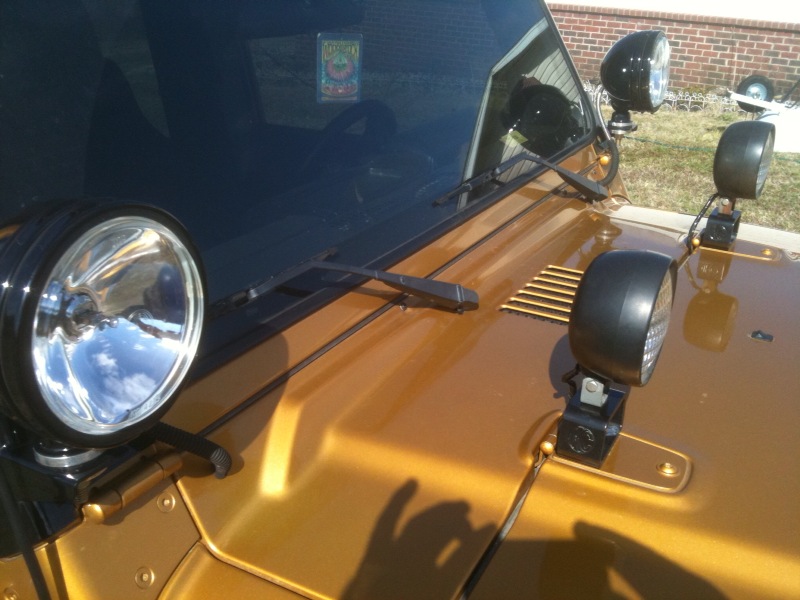

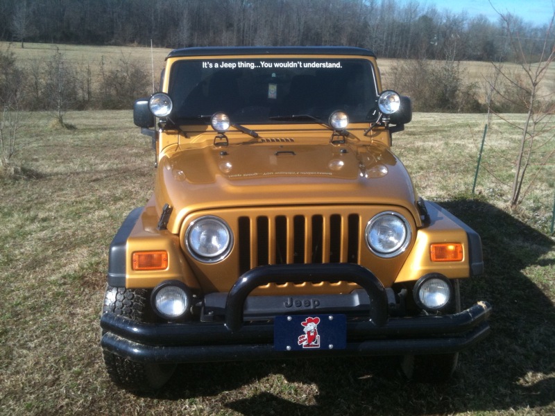

I got them done today, just lowered the windshield and ran the wires through there. Nice hoodmounts, dont like the reflection off the hood though.
i don't either-you might notice i used tractor lights instead of standard KC's-they work well,but are smaller(read that less vision obstruction),and also don't glare so much,but still shoot out some nice light!thinking about building a bridge across the two hood hinge mounts and mounting a total of 8 across there,as well as accomodating mounting of a hi-lift jack!i'm creative,and want to try it!
Goldtj,

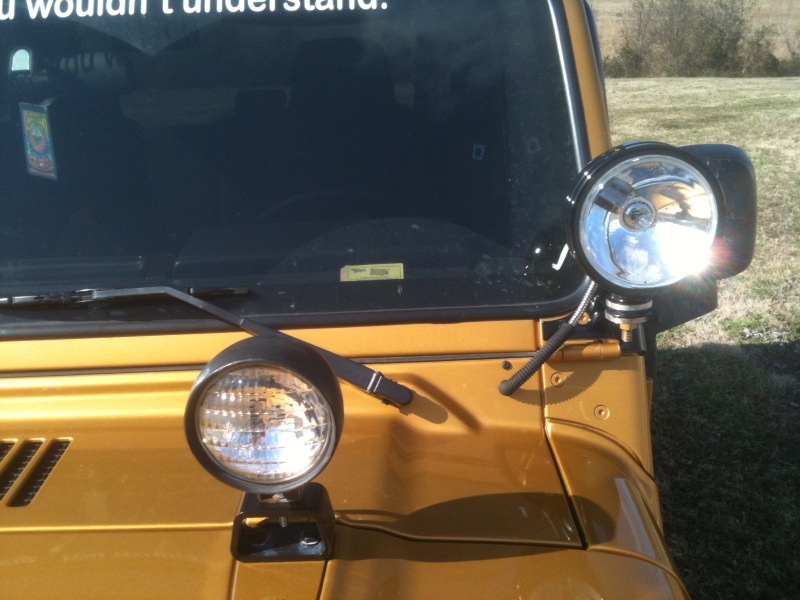

I would just ad one more grommeth to the hole in the last pic to avoid shaffing the wires... Other than that, looks great!
yes,that was done temporarily and it was cold,and i was in a hurry!it will be disassembled and redone as soon as the weather breaks!i am going to do some 4 gauge wiring with power distribution blocks and all soon-i just had to get it going for now!will post some more pics when the final product is done!i am very anal,and did pro car audio systems for almost 20 years,so you can rest assured it will be 100%,and show-worthy when finished!i will seal all the holes with silicone,as well.just put that up to help a brother out and save him some time and grief!i don't have a garage,and i did that in the dark,holding a flashlight in my teeth in 28 degree weather!just had to make it shine!one warm Saturday,and it will be dialed in!
