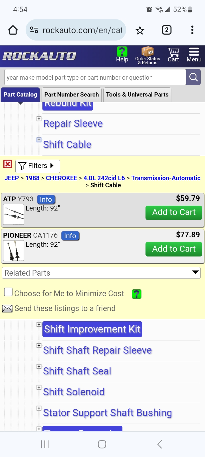

All the cables i find are 92 inches. This is from rockauto.com
It will unhook at each end and you swap the whole cable assembly out, sheathing and all

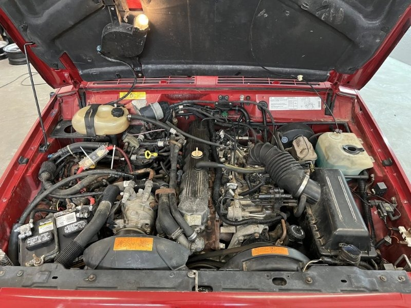

on your throttle body, you have two cables connected? or three? laredo should have three since its a higher trim
1st: accelerator cable from the gas pedal inside the jeep. should be short
2nd: kick down cable to the transmission. should be longer
3rd: cruise control cable. should go to a little black motor in the engine bay.
the black cable just above the yellow oil cap on hte valve cover is the one you are talking about? that should be your kick down
