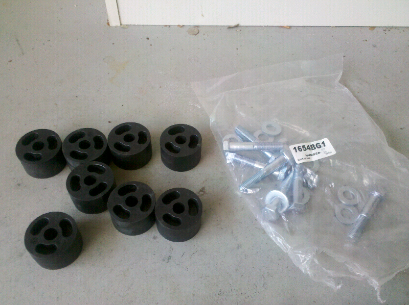

If you're interested I can look in my garage, I may have a TJ transmission drop that came with my lift kit (that I didn't use).
nice, should save 40$ right? thank you any way Terry. the only difference i noticed was after i put 31" tires was an extra whine in the idle,but there is no rubbing. or shaking..thank you so much
This is what I have. If you think it will work then you are welcome to it.
Its a rough country drop. Part number 1654bg1

how much are you looking to get Terry?even if i couldnt get them on the xj,i have a 89 yj in the garage for restoration and modification that they would be useful.
