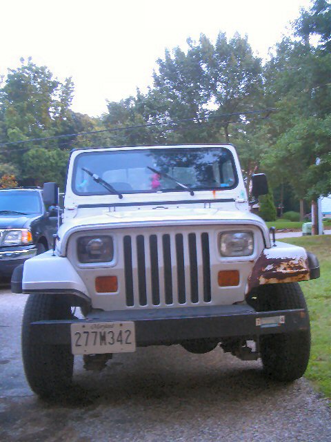

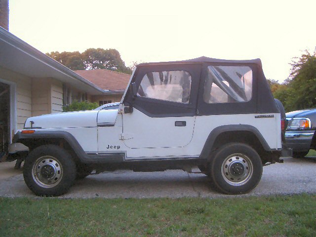

I just inherited an old 89 yj, 2.5L that needs some work.
i don't have tons of cash but are willing to spend enough $ to do it right the 1st time...i was thinking about a 4" lift(skyjacker) with 33" tires but i'm not sure what else i have to beef up, such as regearing...ect.
also have to fix some rust spots...

4 cylinder = 4.10 gears. Leave the gears alone and save up for a six cylinder.
You can roll 31's if your not in any kind of a hurry and are not overly fond of 5th gear. The 4 banger is my most favorite motor in a jeep for the type of wheeling I do around here. 4 wheel low the little 4banger is a monster and if your in the lead you can drive the six's and eight's crazy putting along so nice and slow. go any where they can and not have to rev so high to do so! But then that is just me. tug
Congrats! I ran 32's on a 4 cyl with 4.10 gears and loved it. 33's might be pushing it if you plan on driving it every day.
DOn't be discouraged by the 4 cyl doubters, and enjoy that new Jeep of yours!!!
