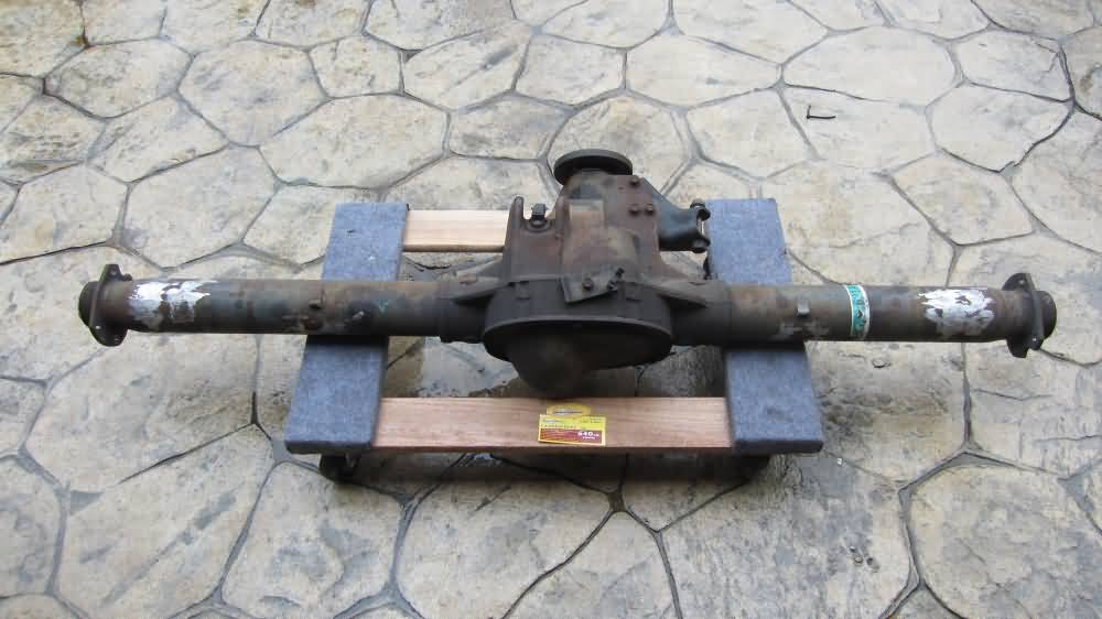

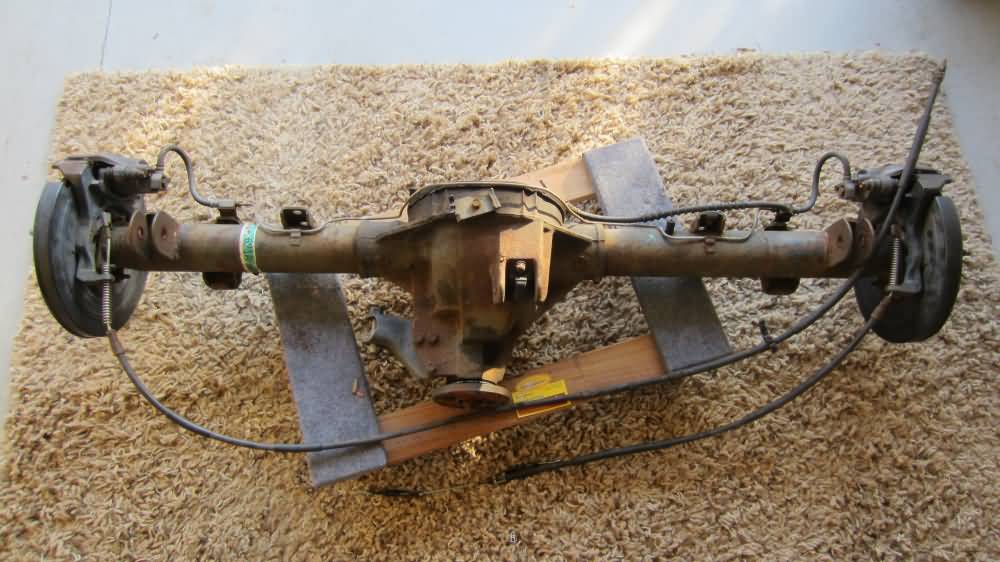

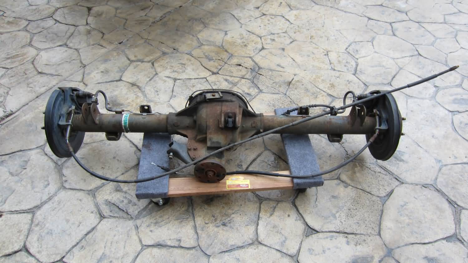

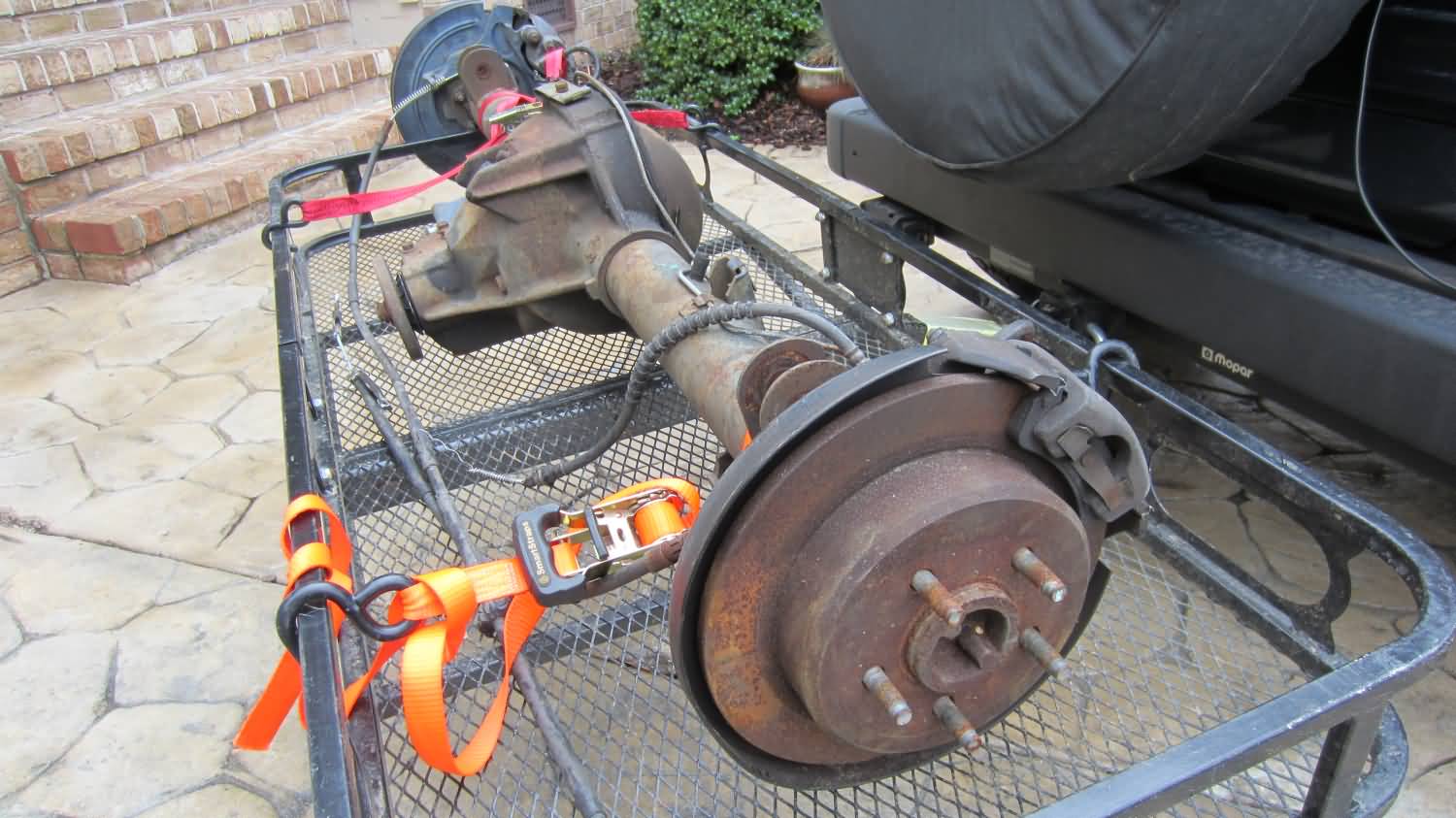

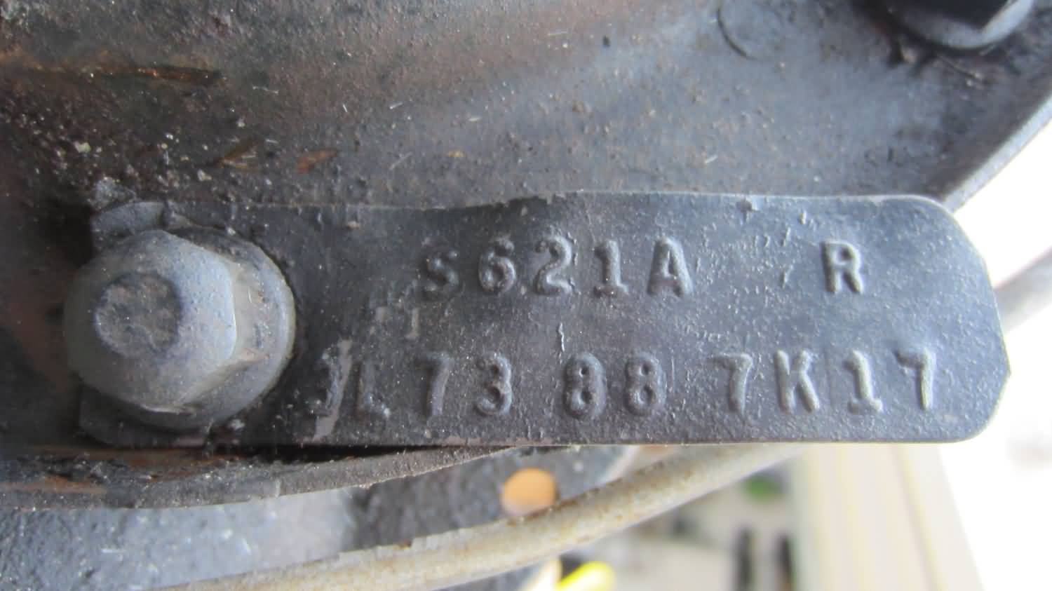

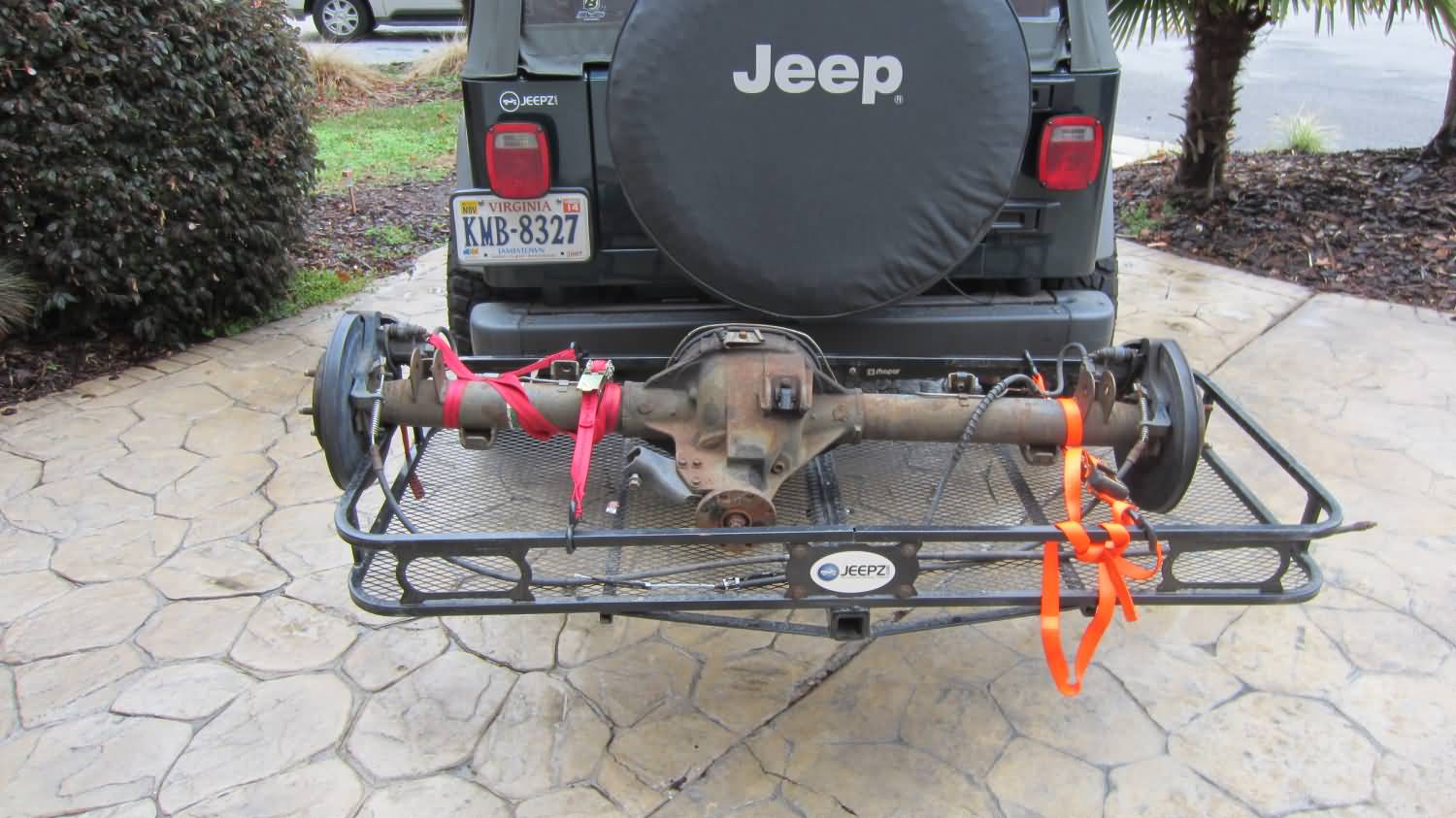

It just couldn't stand being under that Ford Explorer any longer, so this little 8.8 came home with me.
I picked it up for $175 - It's got 3.73 gears and has a limited slip. I've got 3.73s in my Wrangler now, and will probably end up running the limited slip for a while, until I can save up for a real locker. I'm pretty stoked to get this project started as it's the first serious upgrade that I've done - it's been all body lifts, longer coils and the like until now.

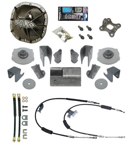

Is East Coast Gear Supply the best place to pickup the brackets? They're the cheapest I've found so far.

Great find for a good price, congrats.
I just worked on a TJ yesterday with the ECG brackets on the 8.8 and it's a very nice kit, I recommend it.

you will need to address the flange yoke on the 8.8, and the kit you posted has the conversion flange included. Simply swapping axles will not neccesitate a SYE. the 8.8 diff is off centered slightly and the pinion is longer than the d35. You may have to shorten the driveshaft, but that really will all depend on what you currently have, and what's going in. best bet it to get the axle in and do some real world measuring. There are so many variations in jeeps from year to year and vehicle to vehicle you can't really just say this or that. I've pulled a rear shaft out of a jeep in the junk yard to put into a nearly identical jeep (same motor transmission axle) and the driveshaft was about 1.5" too long.

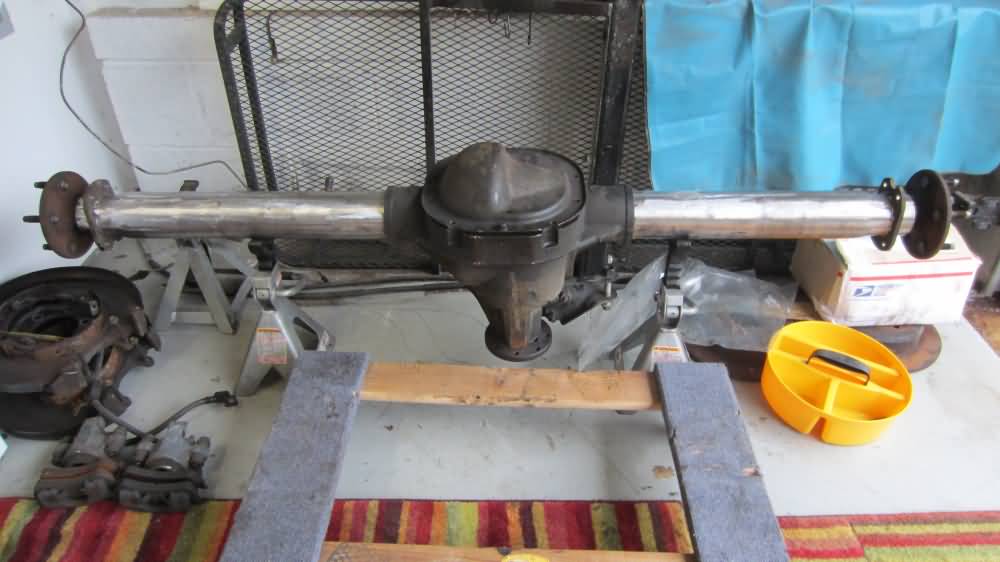

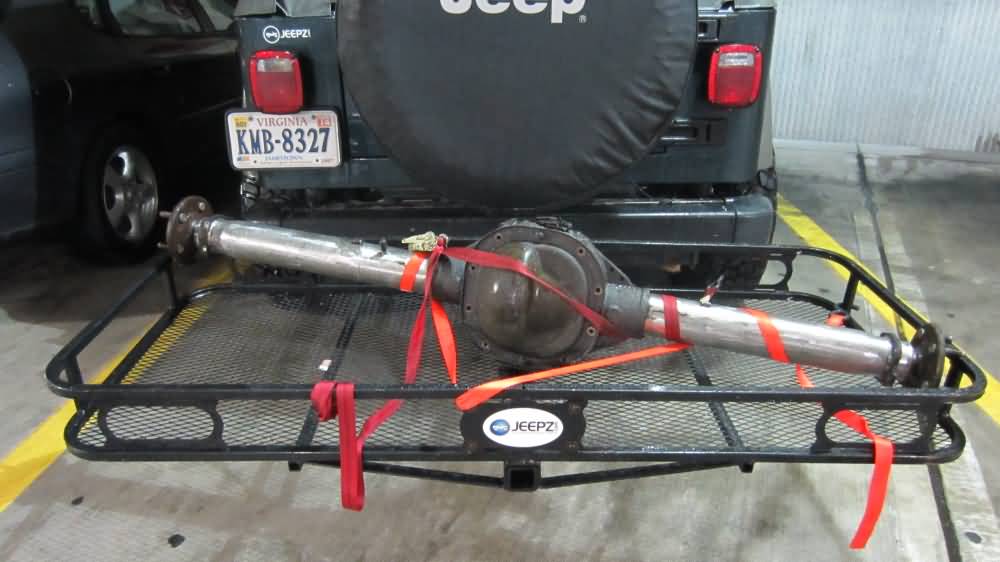

I've made some real progress
When I started:
Brackets cut off:
ground off all the rust:
Loaded up to go to the machine shop. I found a guy that would weld on the brackets for me for under $200.
