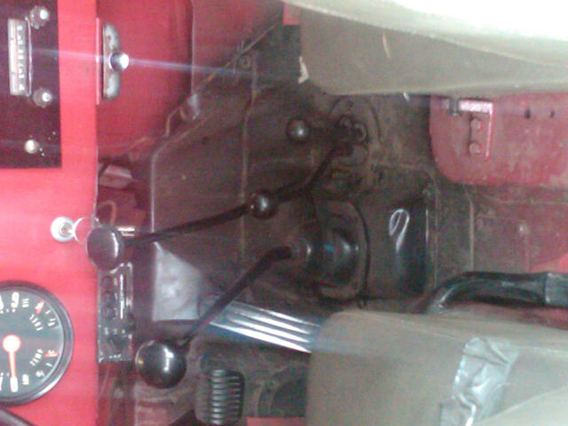

I will take some pics and post them when I get home today. The warn winch is electric and not PTO driven. most of the pto's I have seen the lever or shifter was in the middle of the seats. this one is in line with the transmission and transfer case shifters. But I will take photo and send it out. Thanks so far.
Here is the picture shortcut of the layout on the shifters

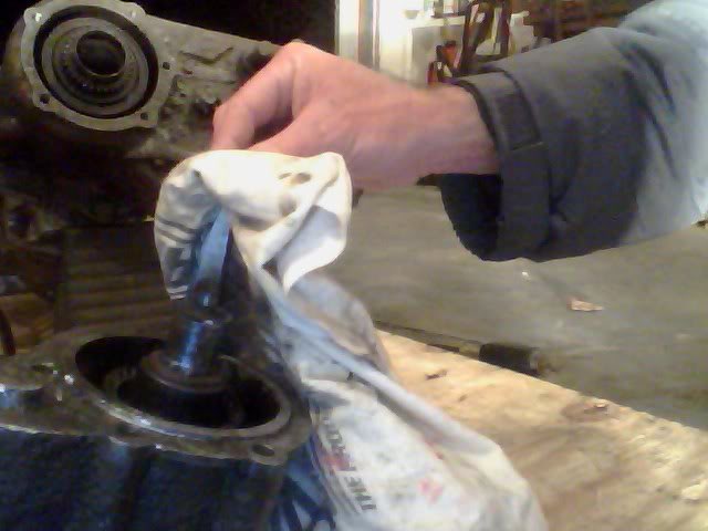

The two short ones are def twin stick d18 shifters. I have never used one, but one is for the front and one for the rear, from what I understand you can engage only the front or only the rear in hi or lo, or both. The other tall shifter I believe is a OD shifter. towards the dash is OD on, and back towards the seat is OD off. Use it as a extra gear, like a 5th gear. It can be engaged in any gear, 1st to 2nd, 3rd to 4th ect.., it gives you a 25% gear reduction. My od shifter was in the same spot only a little closer to the pass seat. Here is the only pic I have of my OD, but will give you an idea of what it looks like and where it is at. It don't have any driveshafts or anything attached to the back of it. If you look at the end of the main shaft you can see where I stripped the slines on the main gear

Thanks for the info, I appreciate it. now all I got to do is go through everything and change all the fluids. other than that she runs great. Thanks again
