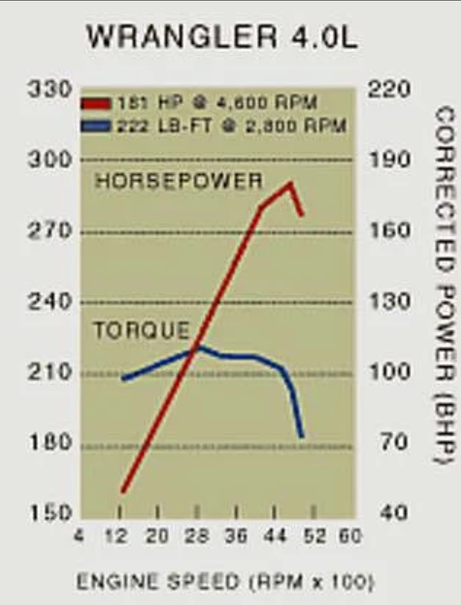

How fast do you need to go on the highway. Or in general? You could calculate engine RPM to rear wheel rpm through the gears. Running 2400-2700 rpm is a sweet spot for power and efficiency on the highway.
Too low and your screaming down the highway. Too tall and you are low in the engines power. Area and lugging the engine.

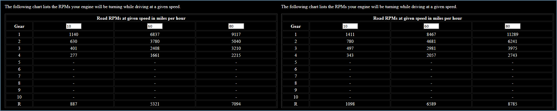

I've been running 3.73s and 33 inch tires for so long that I grew used to how much the engine lugs. I am doing 60mph or so at about 1600 RPM - I shake my fist at the tractor trailers as they blow by me. I've needed gears for a while.
I used this site to figure out my new speeds and RPMs, it's a great tool.
3.73 (current) gears on the left, and 4.88 on the right. Looks like this would put me right where I'd want to be.
I've ordered 4.88 gears, bearings, etc for the rear axle. I'll get that one done then move to the Dana 30 front.

Bearing Wear: Lugging puts high pressure on crankshaft bearings while they are receiving low oil pressure, potentially leading to premature bearing failure.
Internal Damage: Continued, severe lugging can lead to damage to piston rings, connecting rods, and can even crack pistons.
