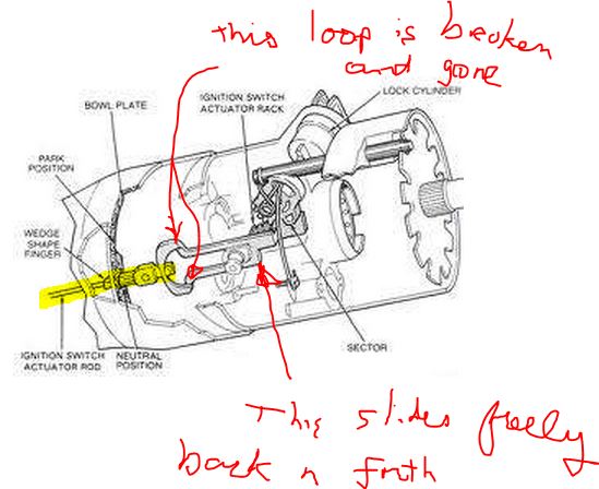

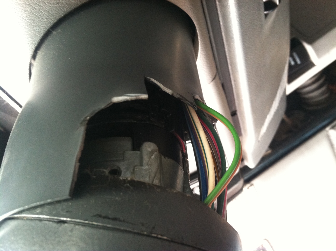

My son has my old 92 Jeep Cherokee at college and it was broken into. The attempted thief tried to hot-wire it to get it started but it looked like he was interrupted because there weren't any wires cut. But he did drill out the key slot and the pushrod mechanism going down into dash is no longer spring loaded, although it does move back and forth when I pull/push on it.

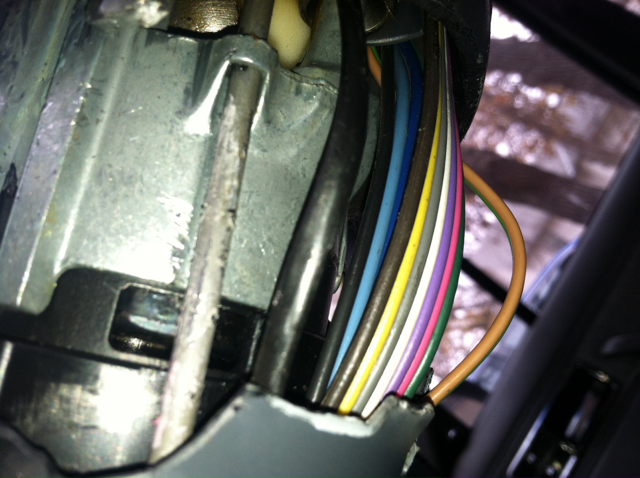

I used "Just Answers" web site a while ago to learn how to get it started (essentially I learned need to hot-wire it myself). The mechanic on that site (which I paid for) told me that I needed to connect some colored wires up under the steering column (which I did, following his instructions). But it didn't work. The plastic around the steering column is busted and I do have access to the cabling.

Someone on here ordered one of those a little while back (the circled piece). I don't know where they got it from though. Seems I remember greg being in on that discussion. As bounty said, it may be easier and less hassle to just get a new column out of a salvage yard. I got a Cherokee column for my cj, it was 100.00

This is a picture of the entire broken piece. I need to know the name of this part so I can try to find a replacement. Thanks
It's a GM Tilt Wheel ignition actuator rack, as the photo link shows. You can get the repair kit made by Dorman at Advance Auto or Auto Zone or you can search Ebay.

I heard my name ! Yes , there was a discussion recently regarding a column rebuild involving a forced entry into a cherokee. These thieves just got no respect ! Can't they steal something without causing so much damage ? I'm in agreeance with Bounty_Hunter and 69jeepcj over searching for a replacement column since the swap is easier than breaking it down for repair . Of course price is always weighing in on the decision . Cannot retrieve my posts from what thread we had this discussion ( so convenient) but I recall mentioning the need for tilt pin extractor as well as the lock plate compressor should the tearing down go to that depth. Point is , after spending time dismantling the existing broken column to,find what's damaged for replacement and spending $$ on tools you may not have ( you won't find that tilt pin extractor at autozone for rental ) , it may add up close to the price of a replacement column from a junk yard , er excuse me , auto recycler. Got to be politically correct or offend the legal folks. As far as ordering parts on line , I hate paying shipping. If you opt to get the parts from a column from the yard of choice ( if they let you dismantle it ) there is still that list of expenses of tools if if you must buy them and parts plus time lost. I know your trying to save money on a jeep that you don't agree in sinking money into but give it a shot and see how much a column is at the yard. Heck , you may decide to part the jeep out after your son graduates and gets another jeep or a Honda or what he's into. Just thought I would help give quick insight on some options to save time. Also wish I can find that thread . Not in my subscribed column. Dang it !

BTW , those wires exposed in the photo are for horn and signal lights . The "hot wires " you would want to jump out are lower on the column on the ignition switch . If you went that route , why not just free the rod from the ignition lock and push it with pliers to select ignition and start to get 'er going ? I realize security is compromised with a broken ignition lock but that is the cheapest way I can think,of until a permanent solution is found. Heck , you know anyone who will lend out their pit bull to keep,it in the jeep while your sons in class ?

In the photo supplied by "just answers" , there is the ignition switch actuator rod. If you can access it , that is what you can manipulate to start the engine. It will move opposite of the rotation of the ignition lock. Pushing it all the way down is the accessory position and up one click will be back to off and lock position. Conversely , each click up will be the equivalent of the key rotating through all its positions. Of course , to engage starter it is a spring loaded position. You will have to be firm with the pliers to hold and release when engine starts and runs. Since the ignition switch actuator rack is already removed , I'm thinking you'll have access to the actuator rod to cycle it through its positions. Give it a try to see if this in fact is achievable.
