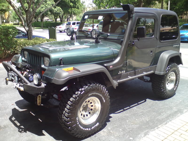

As for lights, IMHO, I use only 2 sets; a driving light set in the front bumper, and a high beam one. Currently, the later is on hood hinge mounts, but I liked them A LOT BETTER when they were on the windshield hing mounts (I had to movre them because of clearance issues with the snorkel on the YJ). There is simply a lot less light reflection from the hood in that position. I went with KC slimlights on the bumper and daylighters on top...

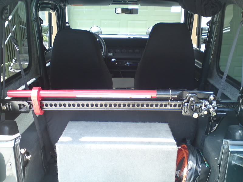

The winch, I recommend either Warn ($$$) or Superwinch. I personally run the Superwinch EPi 9.0 and I am very happy with it. You will also need to have a high lift; a 48" one will fit nicely on the rear behind the rear seat (you can use fence post hardware to attach it to the roll bar).
Regarding the half door, try to find some at a junkyard; it will be cheaper. You can always repaint them and the the inner plastic part new from quadratec or 4WD. I like the Rhino lining part, but it gets expensive to do. I dont have this on mine (want to, but have not done it), but did Line-X both bumpers and the rocker guards...

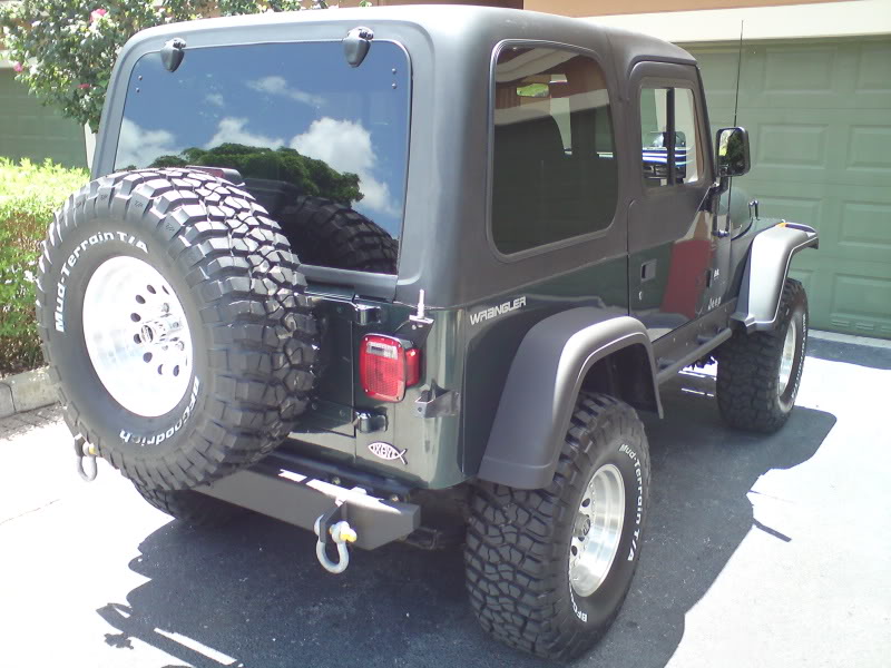

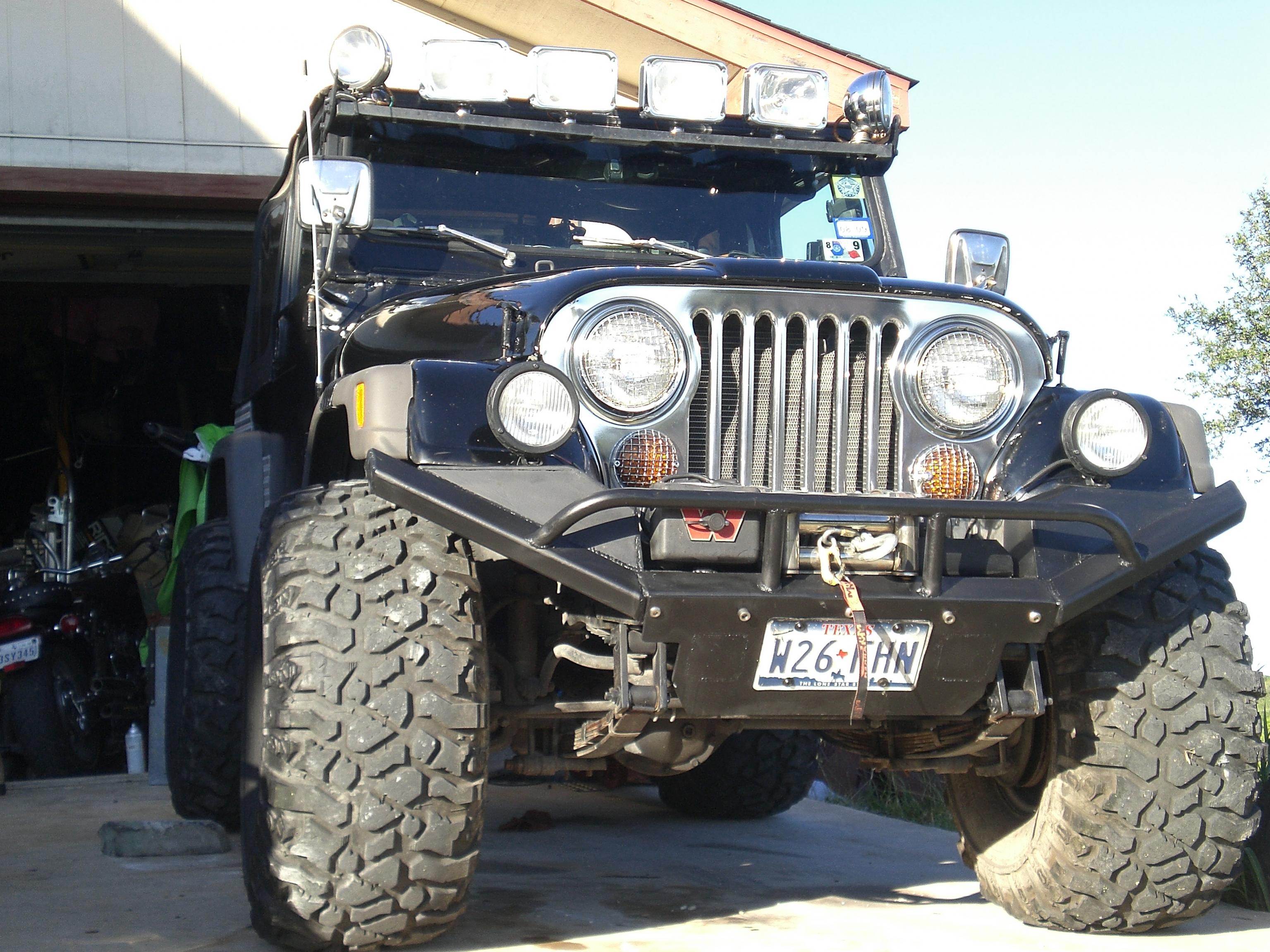

Here's what mine looks like ('94 YJ with 33's on 4" of lift with 2 sets of lights, bumpers and winch):

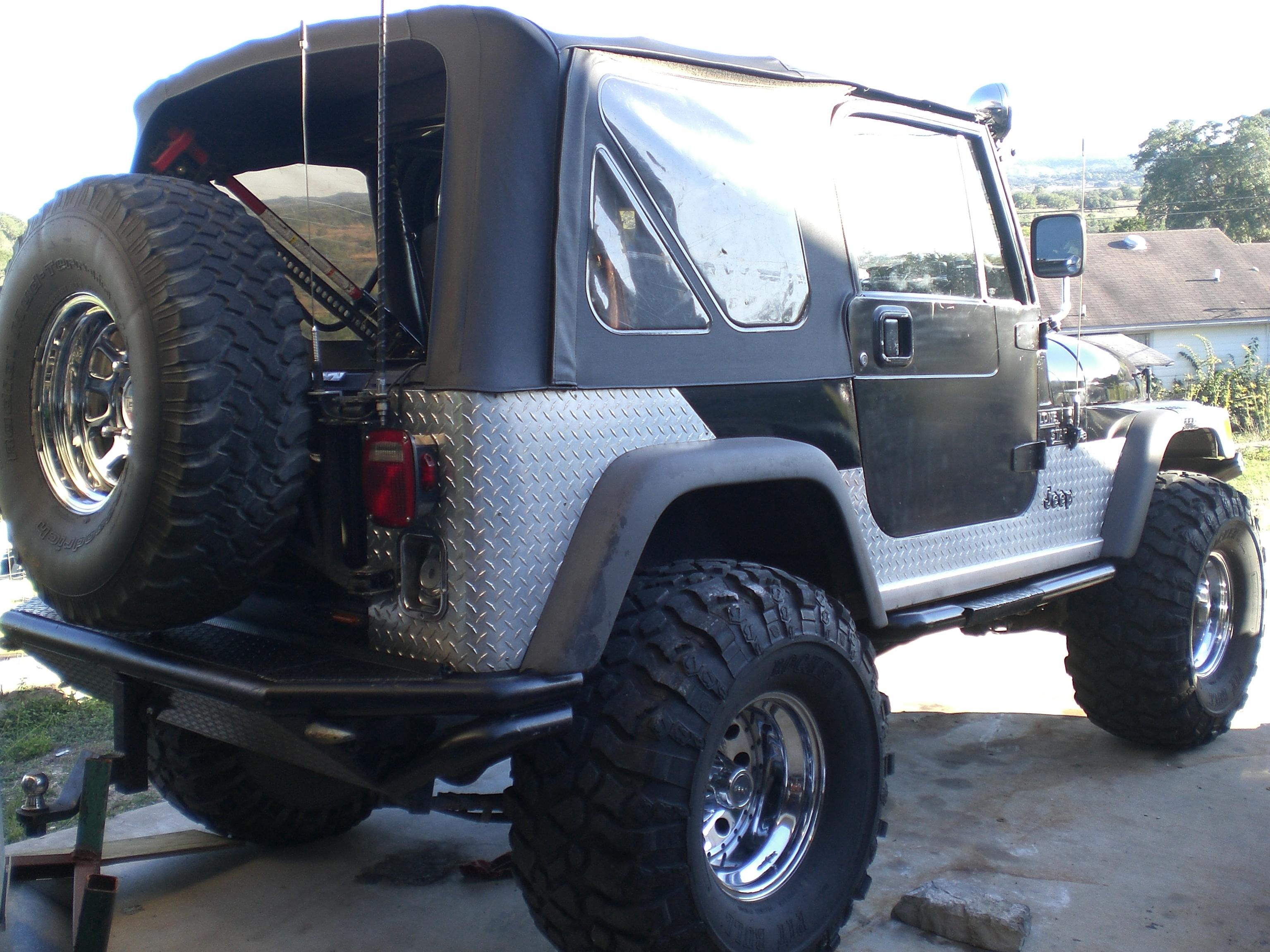

Here's where I have my highlift:

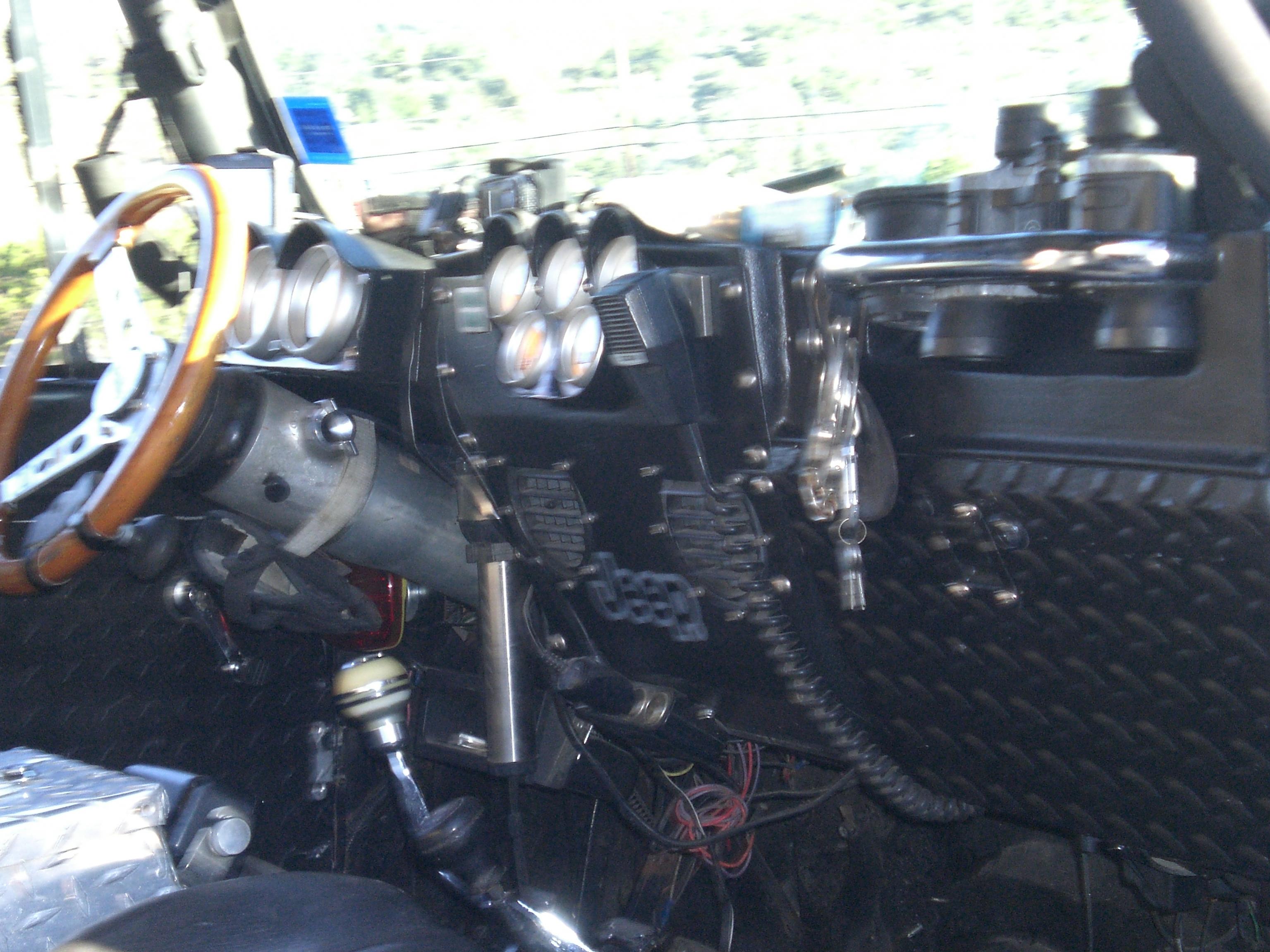

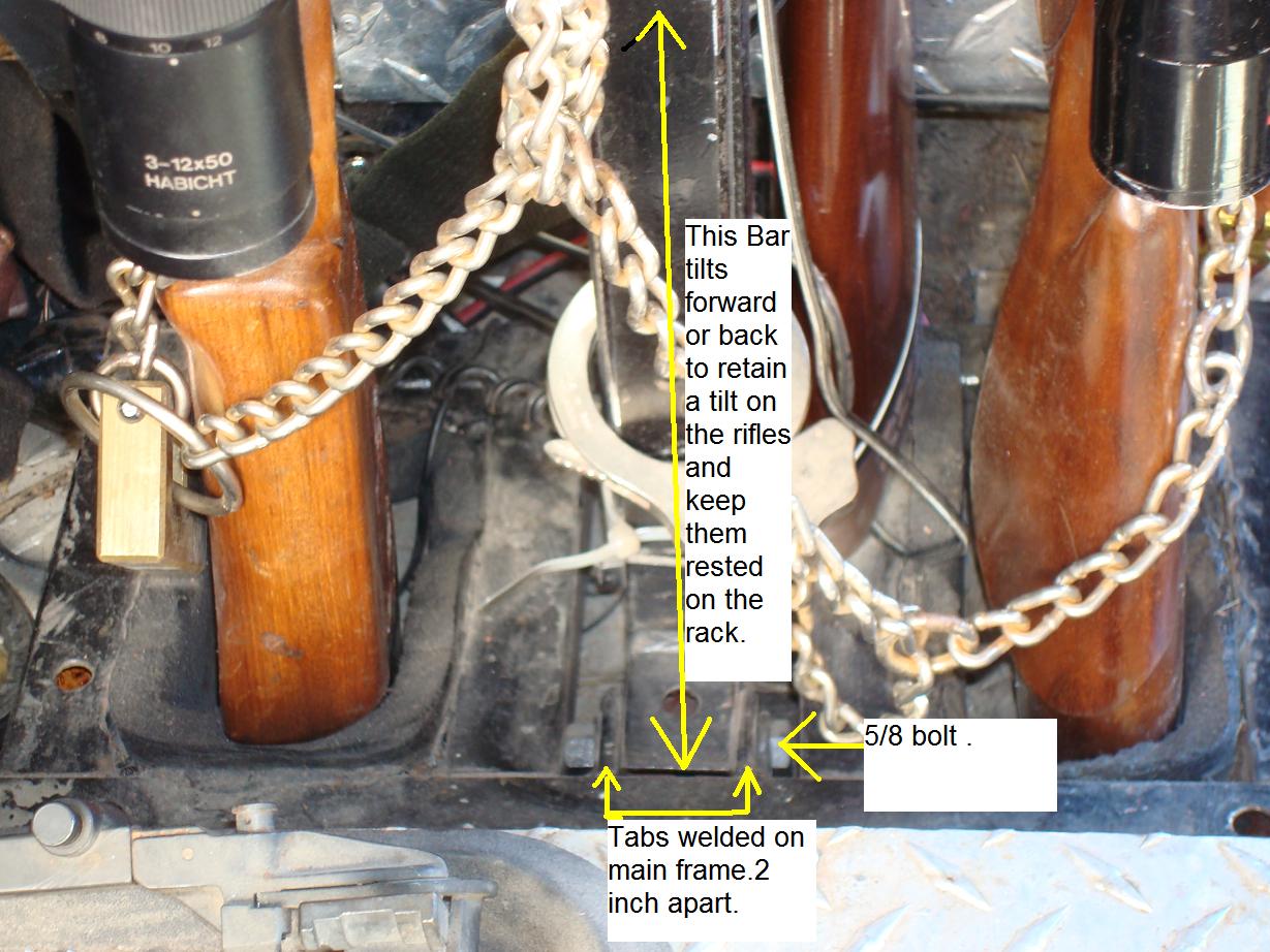

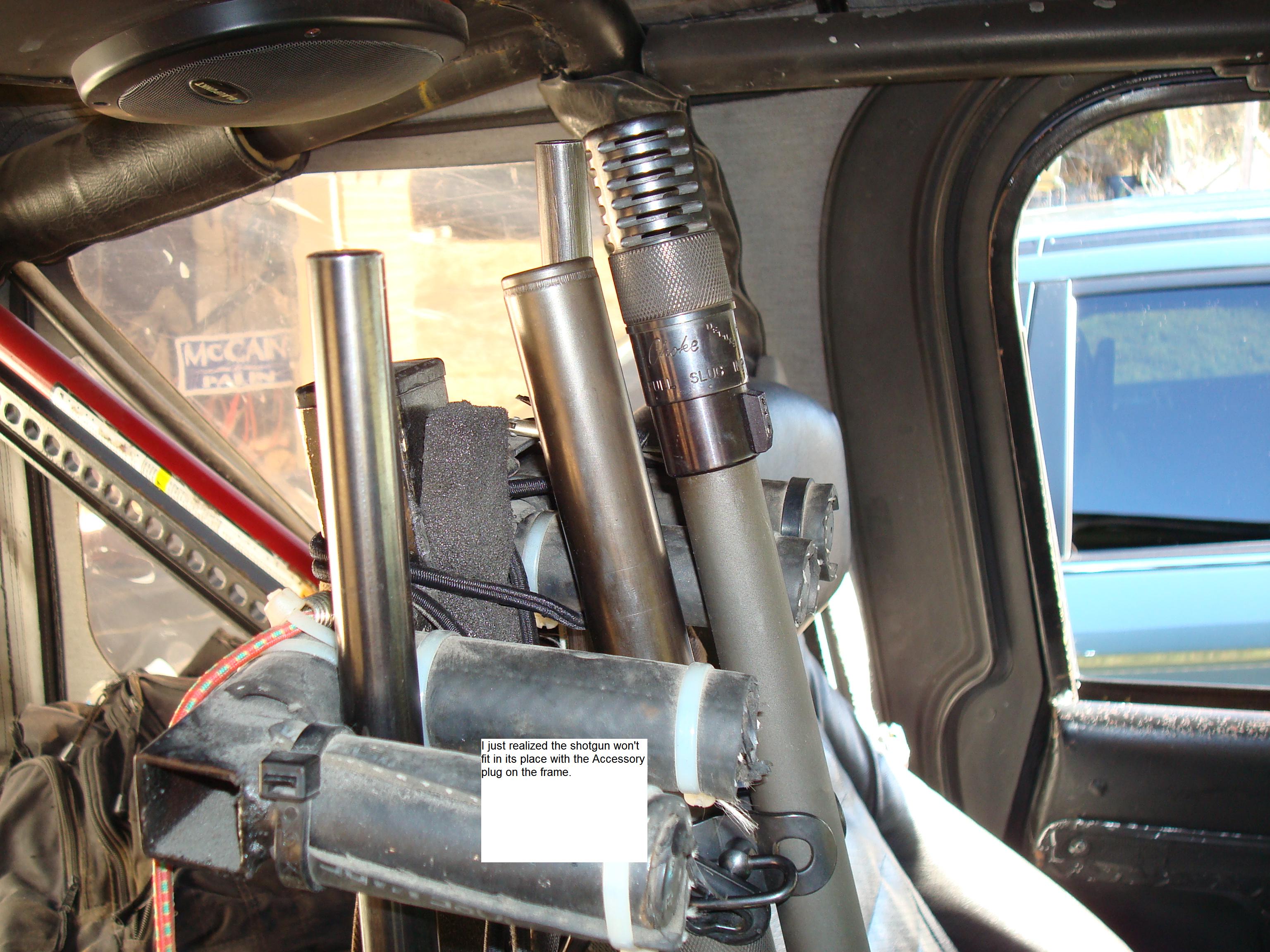

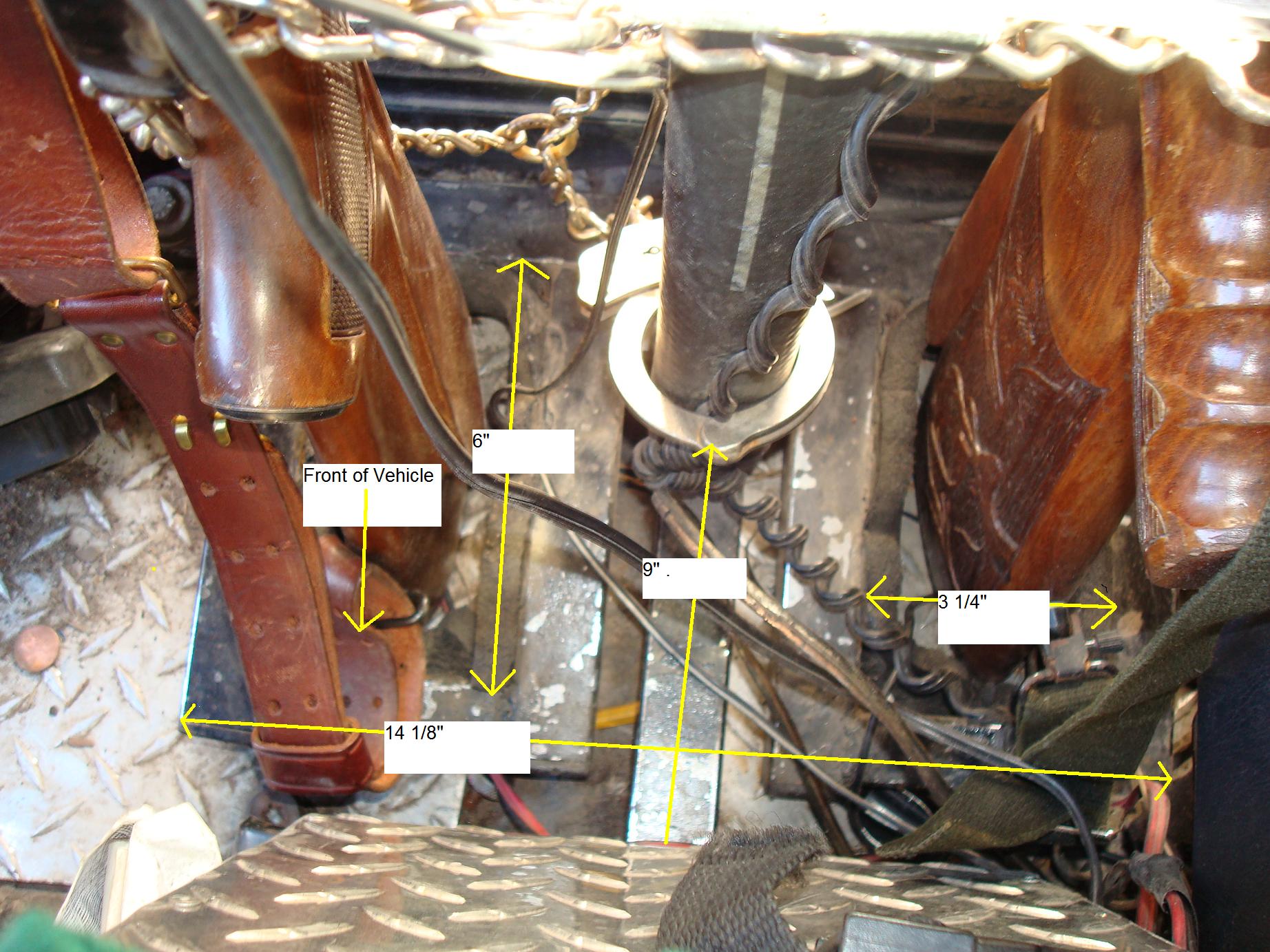

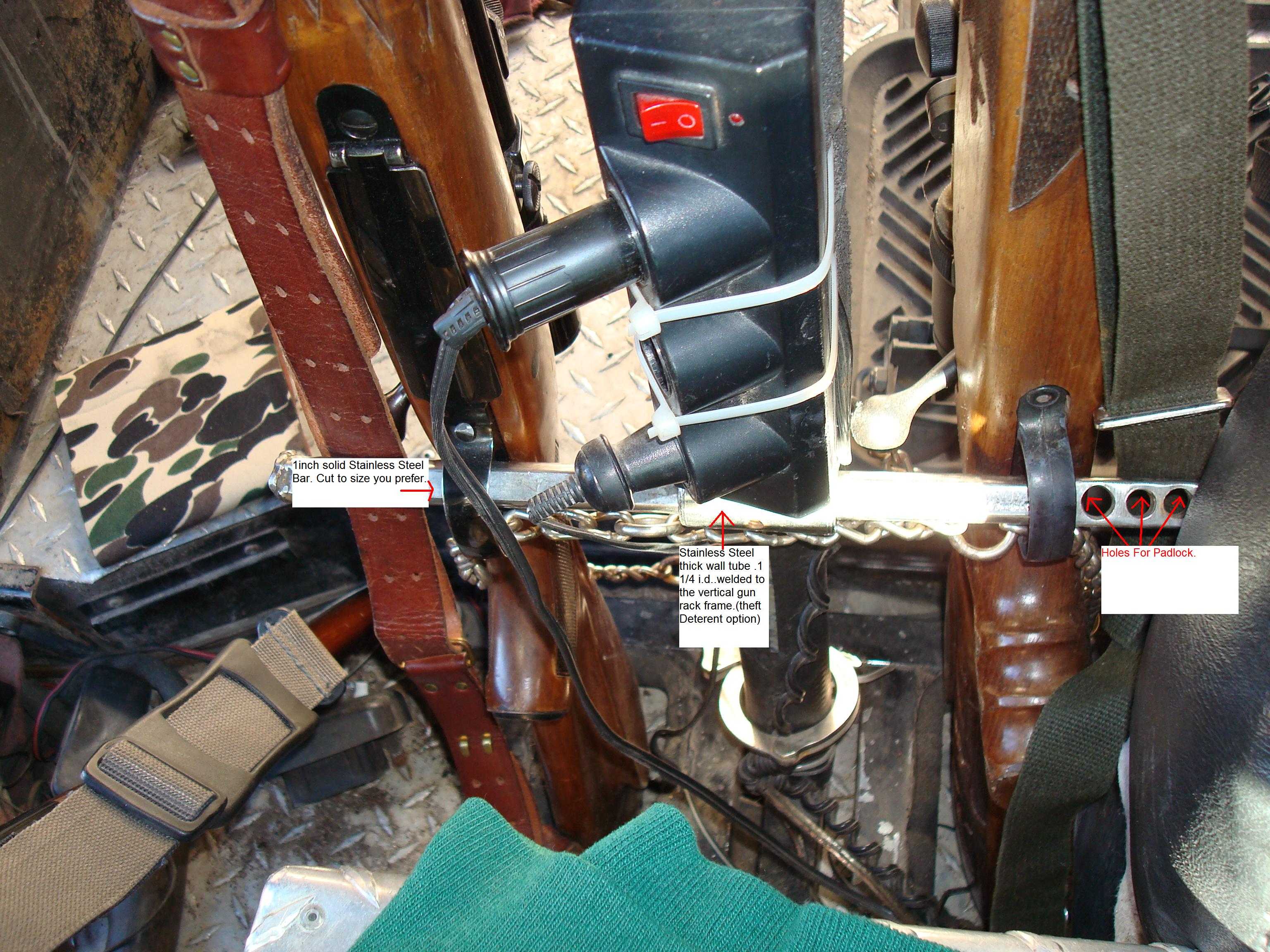

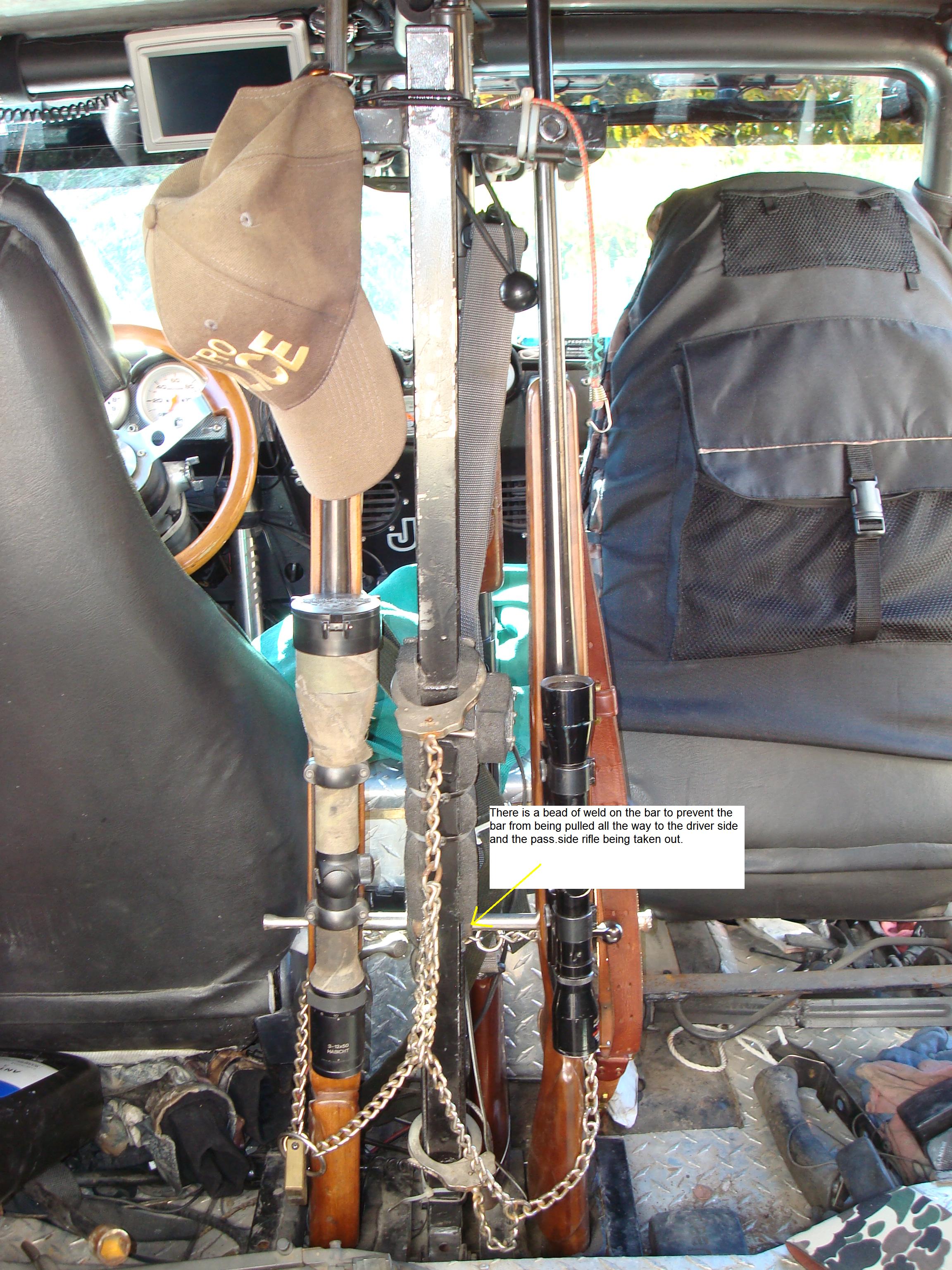

Gun rack and a few ideas. Guns blazing when you exit the Jeep. No tales here, it's all real.:shades::D

Mikey, you've got one impressive setup there - awsome rifle rack. ( but we already knew that! ) . - John
I need the gun rack where did you get it. Tired of the one gun one I have hanging from the seat.

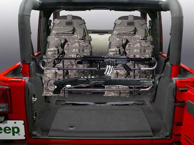

thanks for the sweet pics man. you've already got alot of the dream. i like your gun rack, but i was thinking something like buying like a pet separator (one of those cage walls that goes behind the front seats, to keep that dumb dog of mine where it's spose to be) cutting it in half (so i can still reach into the back, i don't have the bench seat in, and plan on keeping it that way) and mounting it low. sound like a sweet deal, but i'm sure i'll screw up alot of things before it turns out. why i'd go with the pet bar is because it seems like it'd be easy to mod into a gun rack. i bet i could get an assualt rifle and a tactical shotty on there without much issue. then basically, with my molli gear seat covers with the right pouch set up... if anyone was to look into the jeep from the back, they would **** themselves because of the awesome

Sweet setup for a gun rack. Hope you don't mind be scabbing off your idea (cause I'm gonna!). I like the power bar in the front too. If there was only a way to put a cupholder for chicken wings on it! Here's a pic of my Zombie killer.

so heres my twisted idea for the gun rack. ignore the sizes cause this is obviously a crappy shop job. but thats the idea
