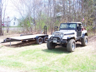

Steady.foot,, dont tease us!! That pic u posted isn't near big or close up enough to check it out.. IMO you have made a awsome combination, I love the looks of the cj,s the comfort and modernties of the wrangler. You have solved the rear axle problem of both models as well. You have good power, reliability and hopefully good fuel ecconomy with the 4.0. I have always wanted to combine the two models myself but have not as of yet.. More pics please!!

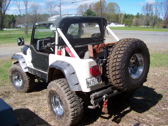

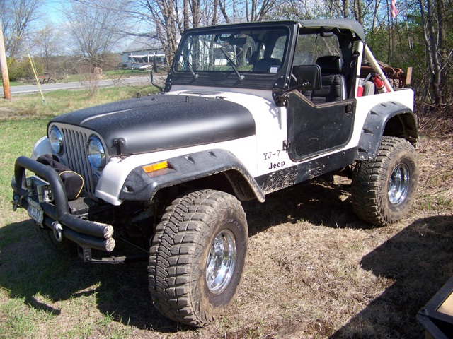

Here's a couple more pic's a little closer up and better quality.
The previos owner did the 4.0, AX15 swap so i'm not sure if he got another transfer case fron a wrangler or put a new shaft in his old one.
I'm finding that the 4.0 is gutless with a carburator and plan on doing a stroker next year if finances allow.
