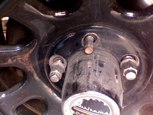

there is the damage :x:x:x
I am a little confused. How did your hub bearing going out wallow out your lug holes? Seems to me that the wheel mounts to the hub and even if the bearing goes out the wheel should still be tight to the hub.
