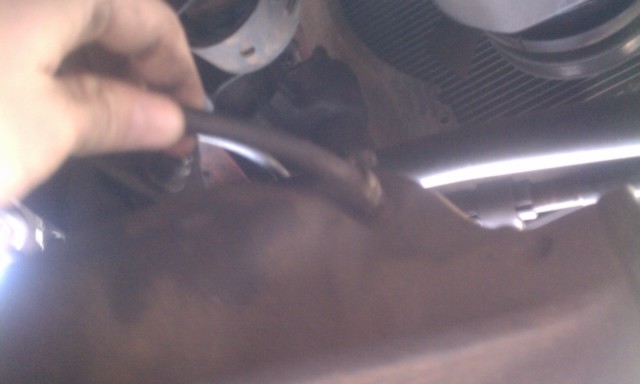

I'm in the middle of replacing my steering box on my 98 GC Laredo and found this just sitting there. I can't find where it goes. Its coming from my front differential and just laying by the gear box.

That is a vent hose for the front diff. It should be running to the firewall with a plastic check valve in the end.

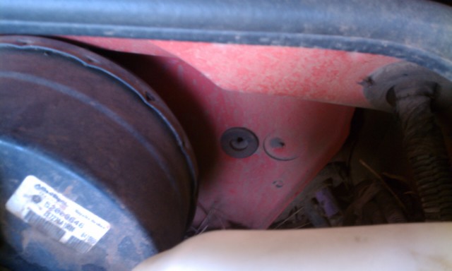

Any idea where. I don't see anything resembling that. Is it up top or under the exhaust manifold. I do see a hole with a rubber seal behind the washer resivuar.

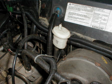

Here you will see it attached to the firewall near the brake booster, this specific Jeeper installed a valve to help keep water out of the hose.
I hope in not retarded but I'm at a loss here guys. Nothing at the radiator and because my grand has a 5.2l visibility behind the engine is slim. Also i don't think the hose will reach there

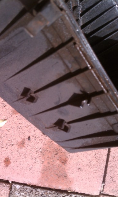

Is possible it just clips here on the side of the air intake?

That looks like a possibility...it just has to be up high to keep water from getting in to it. As the temp changes condensation can build up in the diff...this hose lets the moisture out. They usually came from the factory with some kind of check valve on the end,but many get lost.
