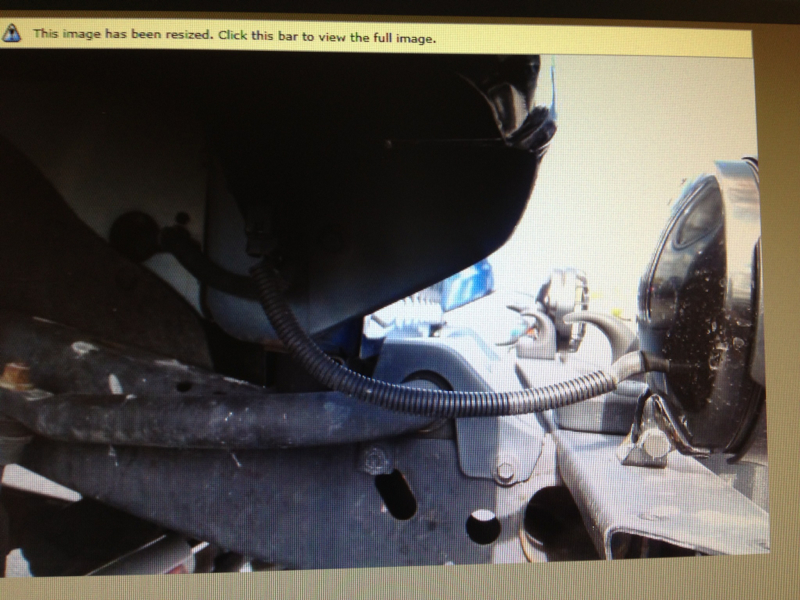

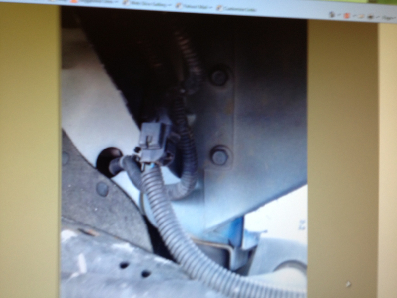

Are all 06 TJ's pre-wired for fog lights? I checked under the wheel well but not sure what I'm looking for. I will have to wire it to a dash switch. I would greatly appreciate a write-up.

I just went out and looked on my 2005, and there's a fog light connector in the wheel well. It looks the same as the ones in your photos.
I'm surprised that it's there - I've got the base model TJ without fog lights.
My 2002 has wiring for a rear window wiper (switch connector and connector at rear tailgate), but from what I can tell, it never came with one. Maybe they use a standard harness to simplify the line. Anyway, I'm trying to figure out what I can use that wiring for.
