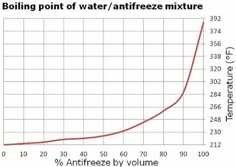

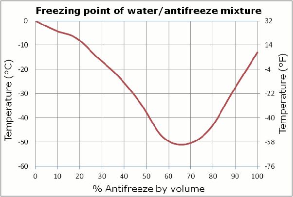

The two below charts describe a lot the first one shows ~65% coolant is optimal for max and min temperatures. However it doesn't show how water is a better heat conductor and absorbs heat with less coolant. So 50/50 is better for areas you dont get down to -30 or below.

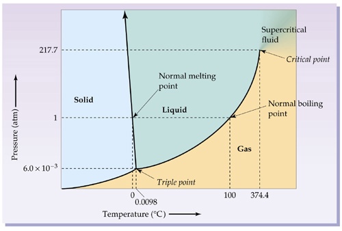

The second is the triple point of water. I don't have one for a 50/50 mix. But the idea is the same. More temp, higher pressure until something gives or boiling occurs.
