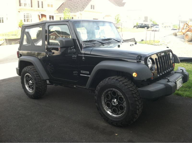

I'm going with the 35" MTR with Kevlar next...
