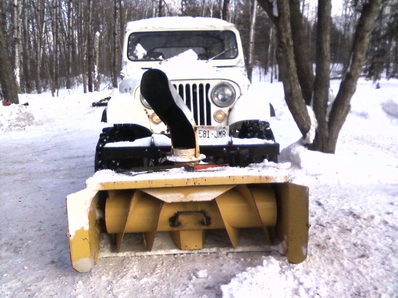

new use for the cj
i got board over the weekend

ya it blows snow about 60 feet and its powered right off of my 383 stroker v belt to a pto conversion then a drive shaft out to the blower hydro up down all consealed under the jeep lol
i was sick of freezeing my butt off out on the rideing lawn mower useing the blower on that and at least with the jeep it is now really a multi purpose vehical lol and to take everything off of it to go wheeling will only take about 30 mins to remove and store away till the following year
Looks great!!! I know what you mean about freezing your a** off on the tractor. I bought a plow on E-bay a few years back...it's so much more fun to clear snow from the cab of a Jeep than from out in the cold.
How is the blower mounted? Can you lift it to drive?
i mounted it useing a snow plow under cariage and i have a hydro pump mounted on the motor with a valve body in the cab and a hyro cyl mounted underneithe it will lift it abour 2 feet off the ground so ya i can still drive it with it on the jeep we are getting 3 ta five inches off snow today lol allready been out playing with it
