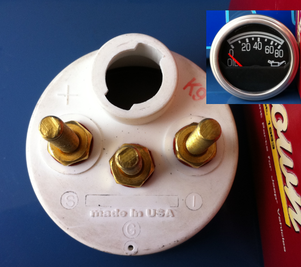

I recently change the oil pressure gauge from oil line to oil sender...but I can not put it work...

The gauge is a crown make...and have three things:
1. S
2. G
3. I
I suppose that S = sender, I = Ignition, G = Grown...but near to S have a positive symbol (+) so I´m confuse...
Thanks
See Attach
I would hook up the "S' to the sending unit switch, "G" to ground and "I" to ignition positive. I'm not sure why there would be that "I" terminal.

Just for clarification. You have the gauge hooked up as follows; I= key on ignition 12V , S= sending unit circuit, G= ground. While the ignition key is on and you momentarily grounded the "S" circuit, no movement on the gauge needle= bad gauge.

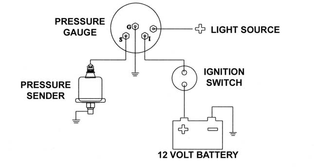

QUICK- CHECK TROUBLE LOCATOR
NO INDICATION AT FAR RIGHT
1. No current to ignition terminal because of
broken or disconnected lead.
2. Grounded wire between sender and
receiver.
3. Receiver not grounded.
4. Sender defective.
EXCESSIVE POINTER FLUCTUATION
1. Loose wire connections.
2. Defective sender
LOW READING AT ALL TIMES
1. Wire to sender broken.
2. Sender not properly grounded.
3. Defective sender.
INDICATES IN ACCURATELY
1. Incorrect sender.
2. Low voltage at receiver terminals.
POINTER FLUCTUATES WHEN LIGHTS ARE
TURNED ON
1. Engine not properly grounded.
