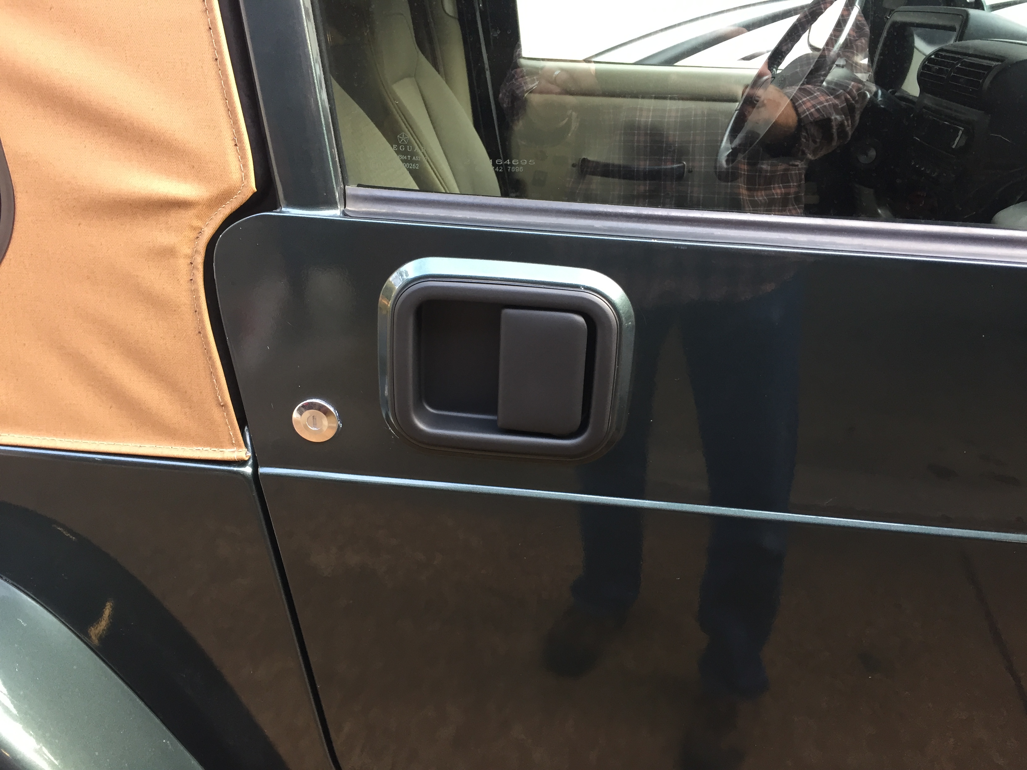

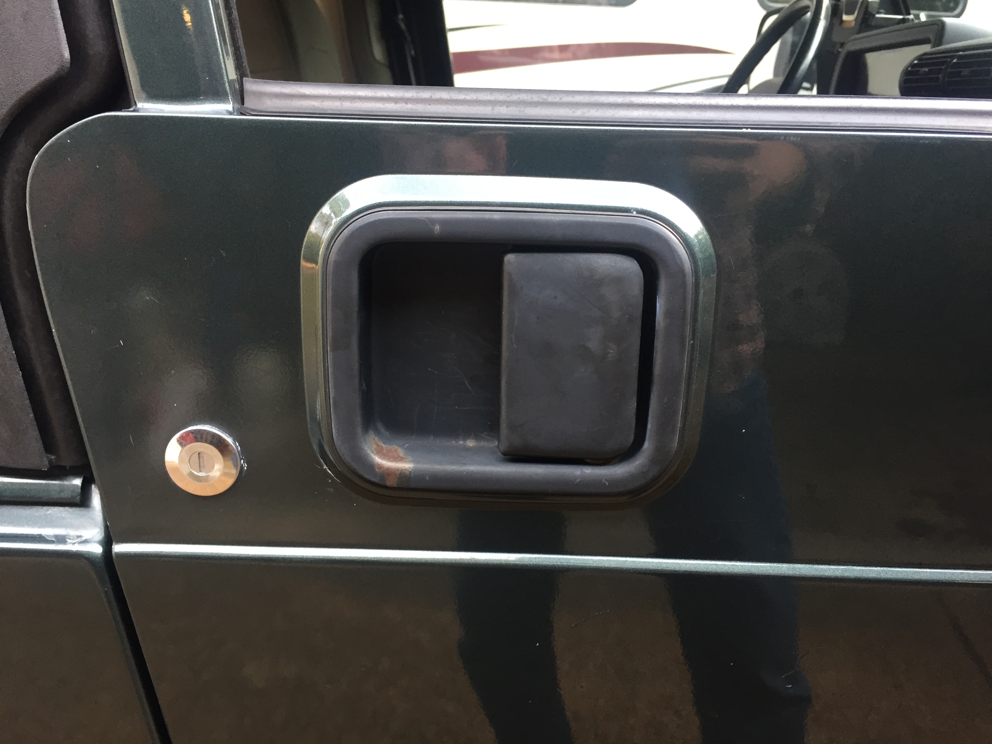

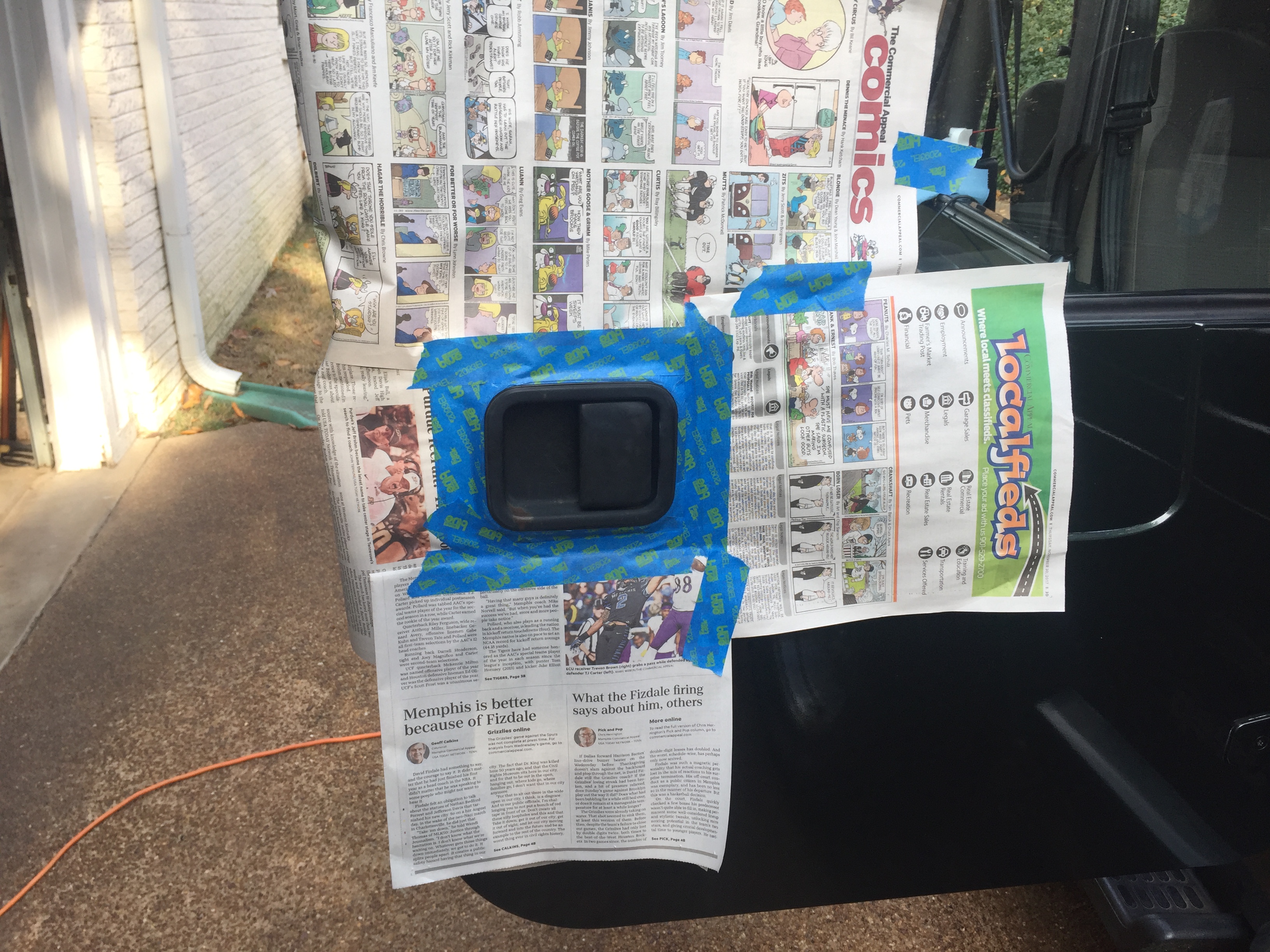

Over the weekend I decided to paint my door handles and I think they turned out pretty well if I do say so myself. I had looked at replacing them since they are not very expensive but it looked like a lot of work to remove the door panel and do the swap. If my paint job doesn't last long I still may replace them or I may just give them another spray. It really didn't take long. I taped them off, quick wire brushing with a dremel and 4-5 light coats of flat black rust oleum.
Before:
During:
After:
I did all three and recommend doing it yourself if yours are as faded as mine were.
