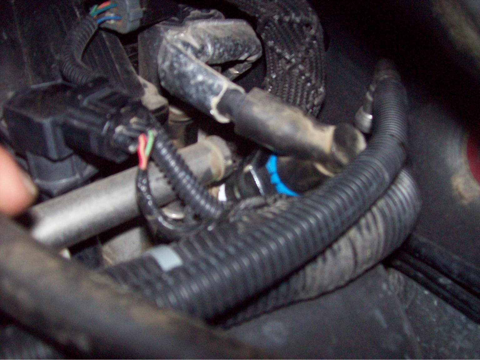

I can't find the PCV valve on my 2006 Jeep Commander 4.7 V8
The repair manual says it is on the side of the oil filler but there is nothing there.
Which repair manual?
Some have lots of bad or misinformation

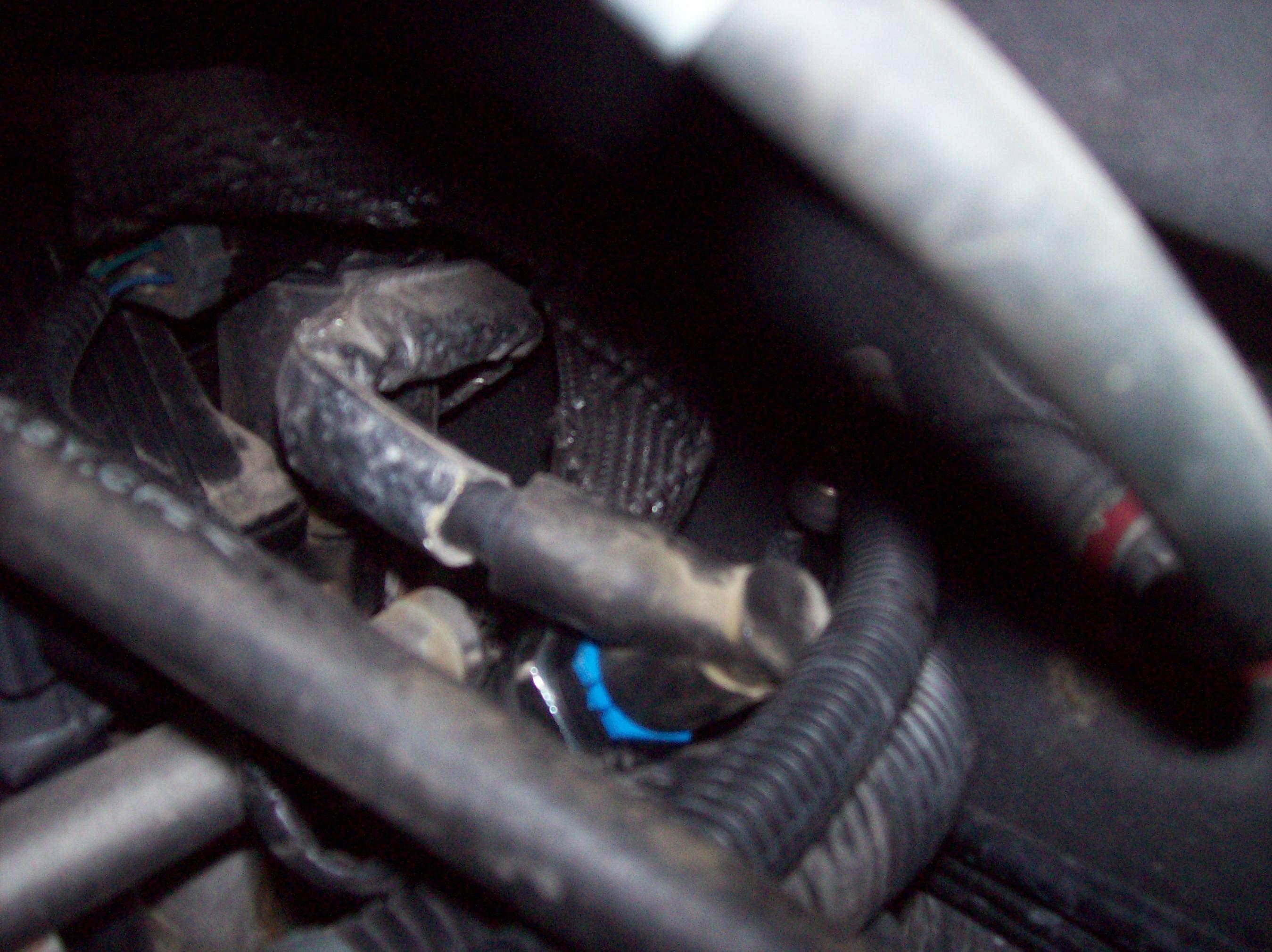

Driver side near firewall

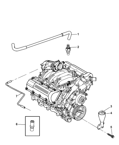

Looks like this:
cacheJeepzImage.php
Thats two different locations between the diagram and pic you posted.
Thought the 3.7 is on the side of the oil filler neck.
