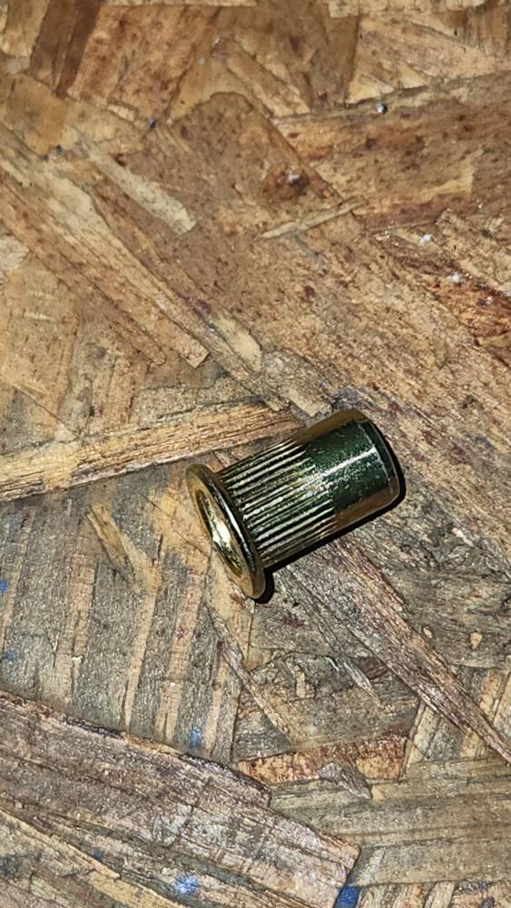

First off, anyone who has dealt with these know they can be a pain in the ass. BUT... these after market fenders use them, I don't know... do stock ones?

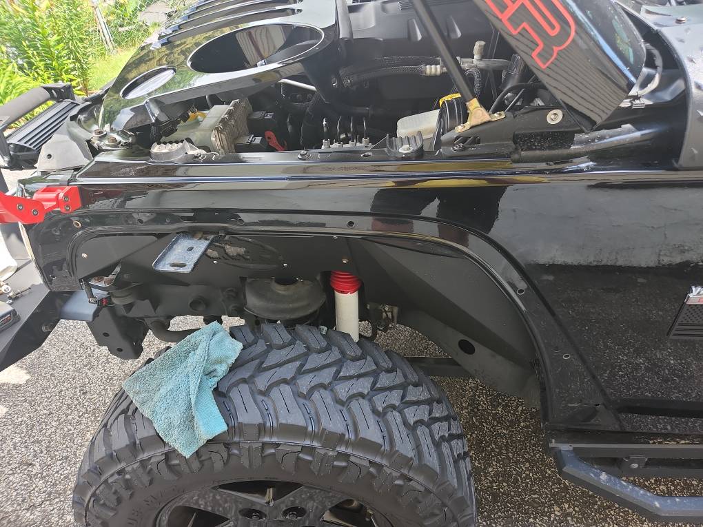

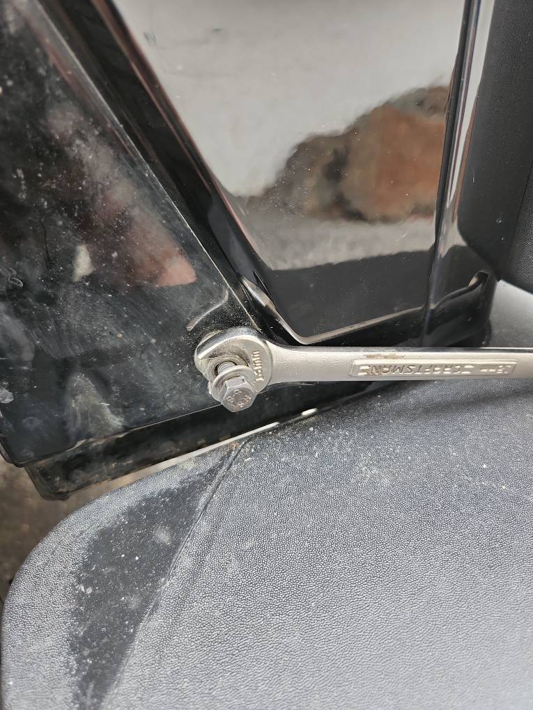

I am in the process of finishing up with my metal fender strip/prime/paint project and NOT ONE SINGLE NUT WAS SET! None... neither on rear or front?!?! If you can see a gap and notice the knurling on the nut (pictured) then yours are not set either!
I am amazed... if it had not been for the previous owner putting a few screws/nuts in, probably because he lost or damaged the original rivet nuts, then these things could have potentially came off at any time?!
