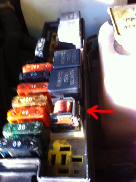

I have to turn the key on and get under the hood and push a broken starter relay to get my Cherokee to start. I have tried a new starter relay and that doesn't work. I have also had a neutral switch replaced. I have been told that it is probably wiring somewhere between the key and the relay. I have also been having trouble with my battery gauge fluctuating. When I am driving it shows the battery fully charged but when I am stopped at a stop sign it drops down into the red. It also drops when I turn on the a/c or the heat. I don't know if these two problems are related. Any suggestions?

Oh boy! Sounds like a. COUPLE of Electrical Issues going on with this JEEP! Problem # 1 - - The Starting Issue. Problem #2 - - The Battery gauge Fluctuating (Charging) Hmmmm - - Let' start with the Starting Issue - - You DID replace the Starter Relay - But that DID NOT. Fix the problem? Correct? This could be a wiring Issue - BUT- It could also be an. - - Intermittent BAD connection! Start at the Starter RELAY SOCKET! Pull starer relay - - INSPECT SOCKET carefully - - Check for - LOOSE or Corroded contacts!! Contacts may need to be cleaned and\OR Tightened - - This is to ENSURE a GOOD Electrical Connection! Also-- You may want to Check new starter relay with a DVM -- Just to Verify it is working OK. This TYPE of problem - we need to check ALL the Possibilities! To Check-out starter circuit wiring - you need a HElPER -- They sit in the JEEP. - - While you - Pull Starter Relay - - With a DVM (multimeter) you VERIFY the 12V signal is getting to the correct PIN of the Relay socket - - (some RELAYS on your Jeep need a 12V signal to work - - SOME relays NEED a GROUND) Good to remember that!! Wht YEAR. JEEP and what Engine? To check Wiring Diagram! On the Battery Voltage Issue - Start with the. Basics - Verify BatterY OK -- Verify batter connections CLEAN and tight! Verify. CHARGING VOLTAGE. OUT of. Alternator is within SPECS - - 14 to 14.5 Volts - - Check with a. DC. Voltmeter! Is it Steady ? Within specs? Could be - - Alternator or Voltage Regulator - - - - That should do it - You did say you Replaced the - Neutral. Safety. Switch? Right? Should be unrelated issue. Good Luck! Keep us Posted. JB
Update: One more thing--- Is your JEEP equipped with an AUTOMATIC Trans?? This can be IMPORTANT in the event your Park\Neutral Switch gives you a Problem! You stated that it HAD been replaced - So I. Discounted this possibility! If you have an --- Automatic. -- and if the Neu.\Park. Switch does not give you a. GROUND to your Starter Relay. -- Jeep will NOT start. THUS: One Terminal on your Starter Relay should always be HOT (12V). One Terminal. Should ONLY be hot (12V) when you CRANK the Motor(Solenoid wire to starter). One terminal will be HOT only when your IGNITION Switch is in the START position (12V signal to starter relay COIL). One terminal on Starter relay will be. GROUNDED. Only when Automatic Trans is in either: Park or Neutral! (On Manual Trans - this is always grounded) That is the way it is-- JB. There should be 5 terminals on starter relay - one terminal NOT used_- By the way - your picture showed the RELAY with NO cover?
@ jimbob2001 - Thanks for all the advice. Yes I did put a new starter relay in and it actually started for about a week and then wouldn't again. I had to put the old starter relay back in because it was missing the cover and easy to use to push start. Yes my Jeep is an automatic. I will do some checking on all the wiring. I sure appreciate all the help and advice.
