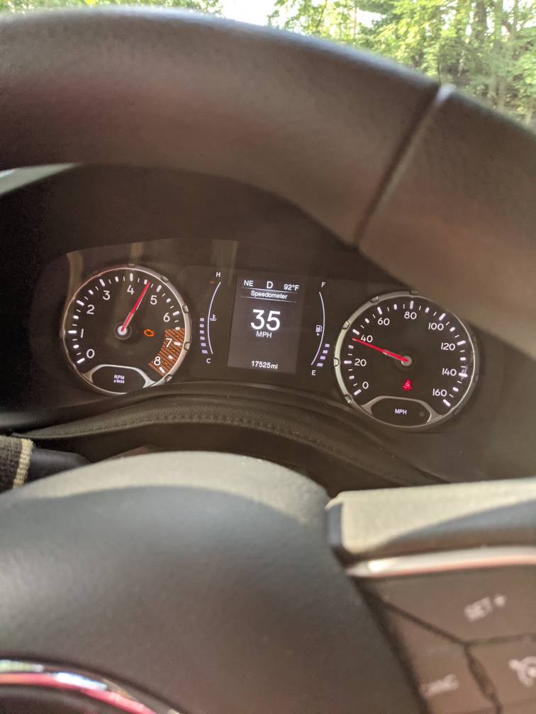

Does this cause you to "lose your transmission" and not be able to shift? It revs to 6000 rpms and stays in first gear (yes automatic transmission). I don't know how to add the video. PXL_20210627_222241281.jpeg

If it is not shifting out of 1st and no traction control or AWD or 4x4 lights are on. It may be the transmission or its controller.
