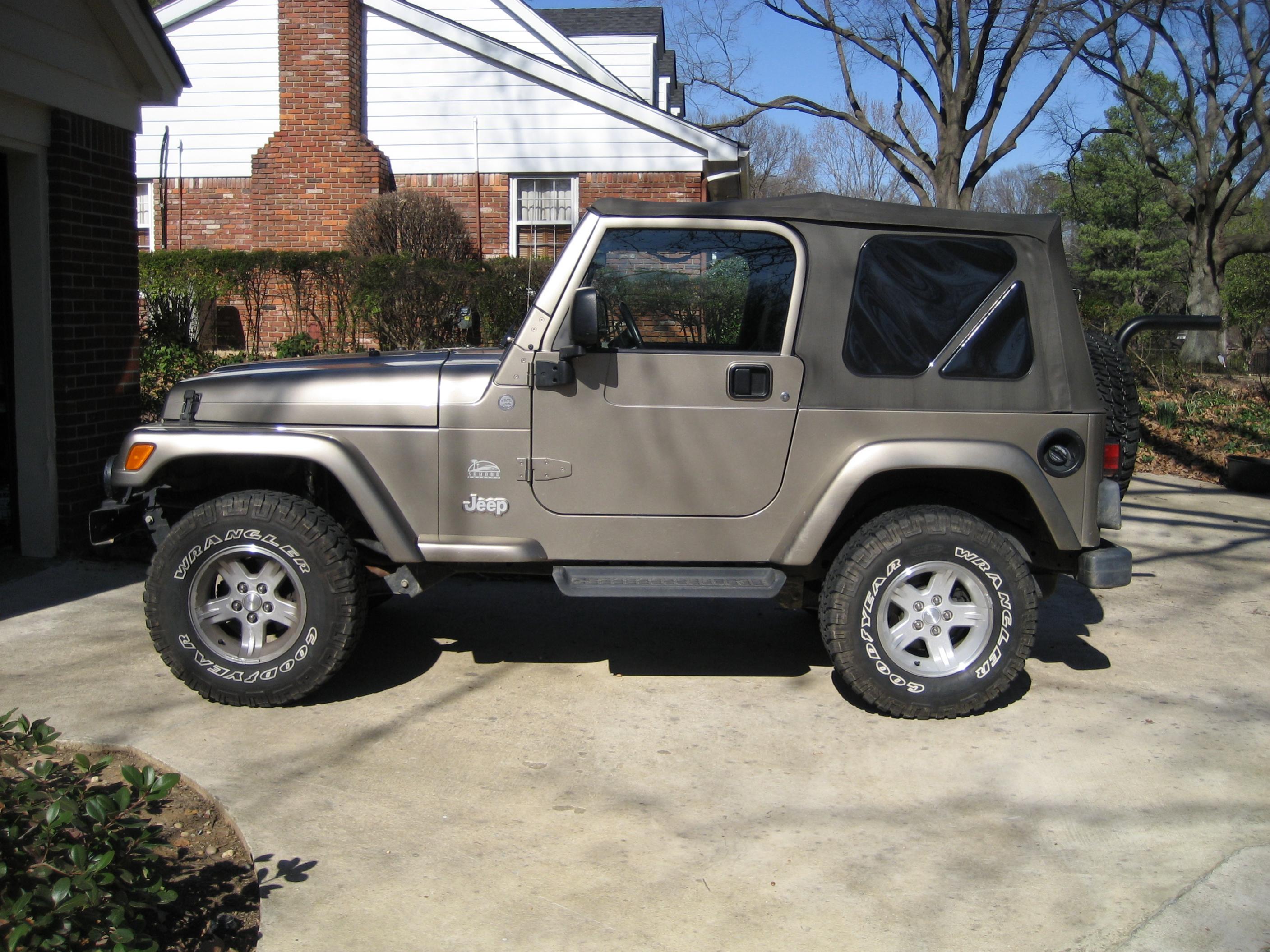

I got the RE kit with the monotube shocks and love it. I don't have a ton of skills or tools but it was pretty easy to install by myself. I definitely recommend an alignment after install. Here is a pic of mine with 31s and 2" lift.
