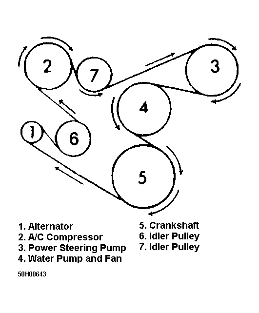

I bought a 1995 wrangler 2.5l missing the serpentine belt with AC and PS  The belts they pull up at the store are to small   I’ve even tried to skip the AC and put 71 inch belt on just to get it running and it was too small.   Yes I check to diagram and had someone double check me. Need some help. What am I’m missing
