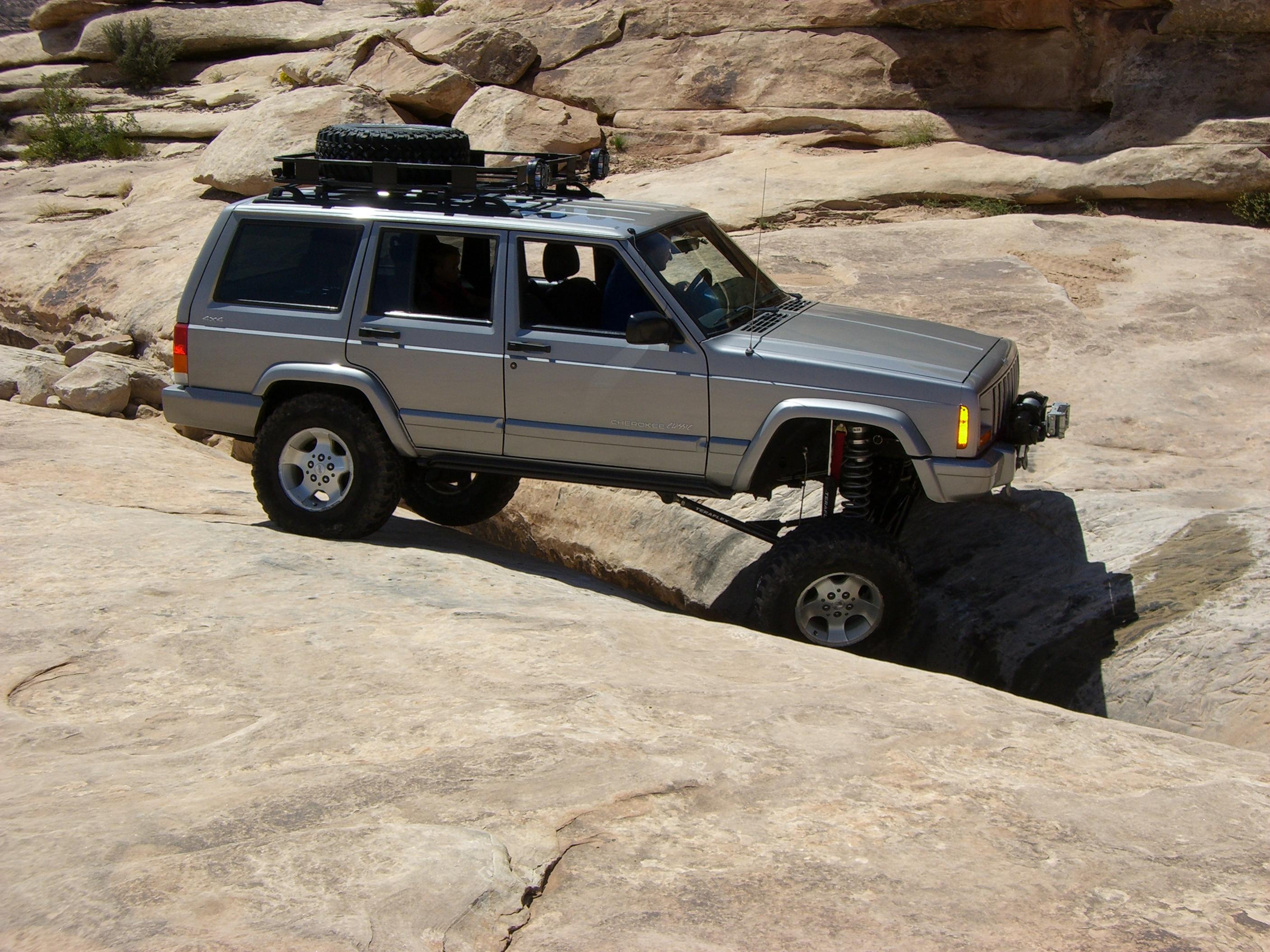

I run 33s no problem on 5"lift also ran 34s in past
33s in pict

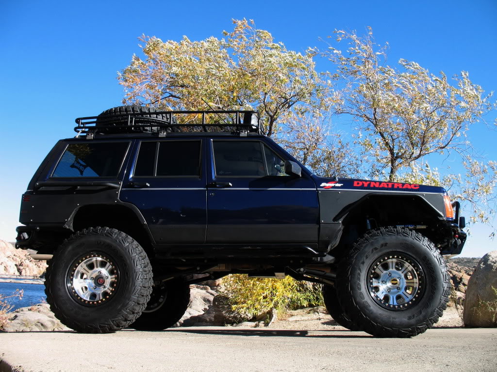

I run 33/12.50 on 4.5 inches of lift... the fenders are cut up really high but the rear hasn't been touched
I ran 33s with 4.5" for years and the only trimming I did was to the inner plastic liners on the front. Rear was stock till I got 35s. I rubbed the flares a little but not too much.
