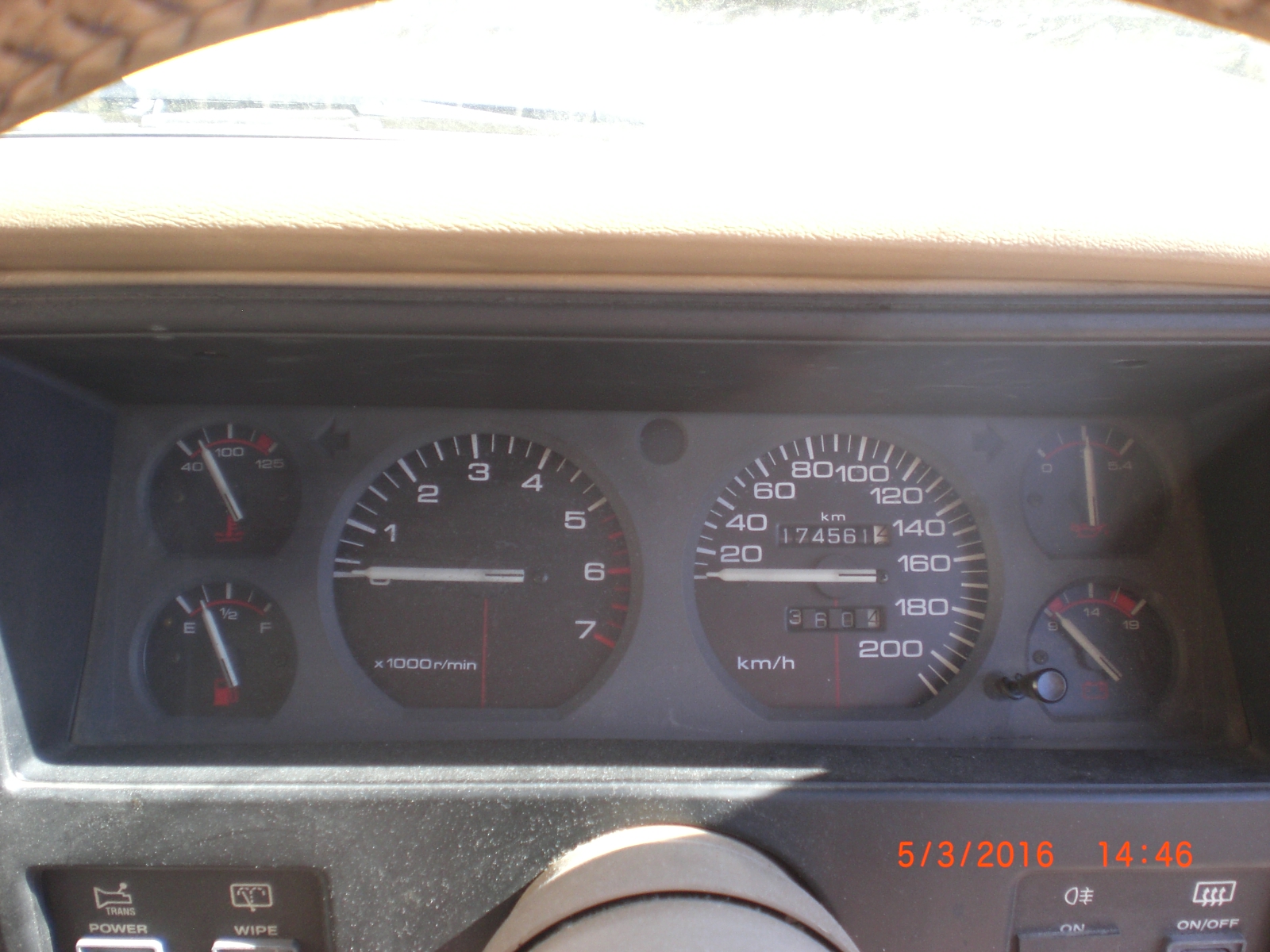

On my 1994 XJ RHD my speedo has sometimes started jumping up to 80kmh irrespective of what speed I am doing. (It came with KM/H rather than MPH). Sometimes it is fine.
If I continue to drive with it stuck at 80 it may suddenly start to give the right reading. The needle is steady and does not flap about like the old cable driven ones did sometimes.
To be honest I am not sure if it is mechanical or electronic, though my bet is electronic.
Has anyone had this problem and what can be done to sort it?
If I have to find a second hand head, how can I clock it to match the car's original mileage? The mileometer (odometer) is mechanical.
I'm looking forwards to your suggestions. Thanks all. Mike.

Things have taken a turn for the worse. After my last post things went back to normal so all was good. The other day I pressed the trip reset button and it stuck partly reset. I pressed it a few more times but did not manage to get it to reset. What has happened now is the the main mileometer (odometer in American) has also stopped working.
My thoughts are that there is some sort of mechanical failure in the cogs that rotate the thing. The actual speedo part still works but sometimes still sticks at 80.
I think I will definitely need a new speedo head now.
Are there any suggestions that could be useful?
