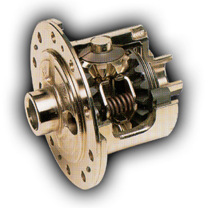

here is a limited slip, you can see that the springs between the spider gears help bias only one tire from spinning, while not fully locking they can be of aid in many situations. they are practically unnoticeable on the road because they do have a point of direct differntation, that is to say at some force the springs are over come and it acts like an open dif, but all in all they are a good selection for moderate trail use. some use clutch packs in the gear sets to do the same things as springs and they usually require a special oil or additive to function correctly

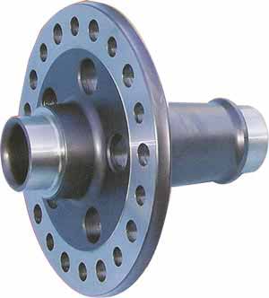

here is a spool for a dana 60, the ring gear just bolts on the flange and the axle shafts slide into the two ends, simple and effective but you can see how it adds stress to the drivetrain. theyre great in rear axles because theyre predictable offroad and wont ever unlock at the "wrong moment" but not very practical for everyday driving.
