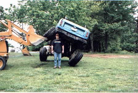

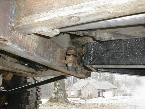

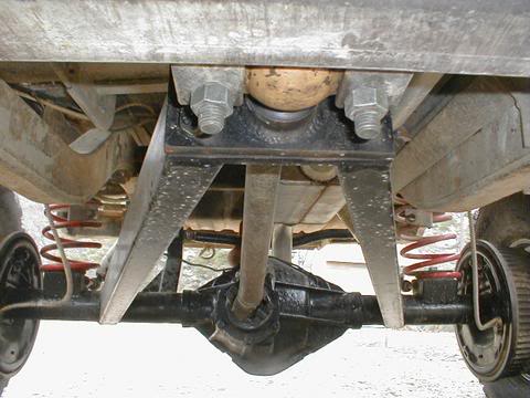

spring over pros: 5-6" lift, fit 35" tires w/no fender trimming, have flat springs that have lots of flex, improved ground clearance under axles, is hard core 8)
spring over cons: really top-heavy/roll over waiting the happen, handling is impaired b/c of increased height, increased wind resistance, no use for 35" tires with stock axles, need cv driveshaft, involves welding, requires more steering mods
