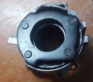

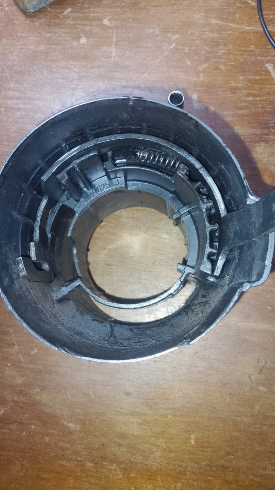

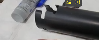

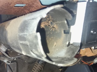

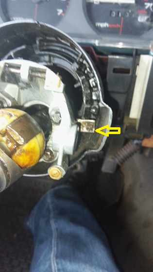

So this is the issue I am having when the column collapsed this all came apart I have tightened the E8 with red loctite and now I do not know how this next area goes together. In the first two images, I have yellow arrows pointing to some tabs and in the last, you see the ignition release I have tried fitting this several different ways and cannot figure it out.

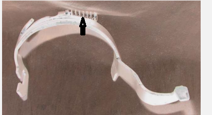

I believe that tab in the first image is supposed to be where the purple arrow is pointing in the third image but not sure it was all apart in there when I disassembled it.
In the third image the Yellow arrow I have no idea what is supposed to go there if anything.
In the third image, the white arrow is where the ignition rod that goes to the box under the dash goes as another point of reference.

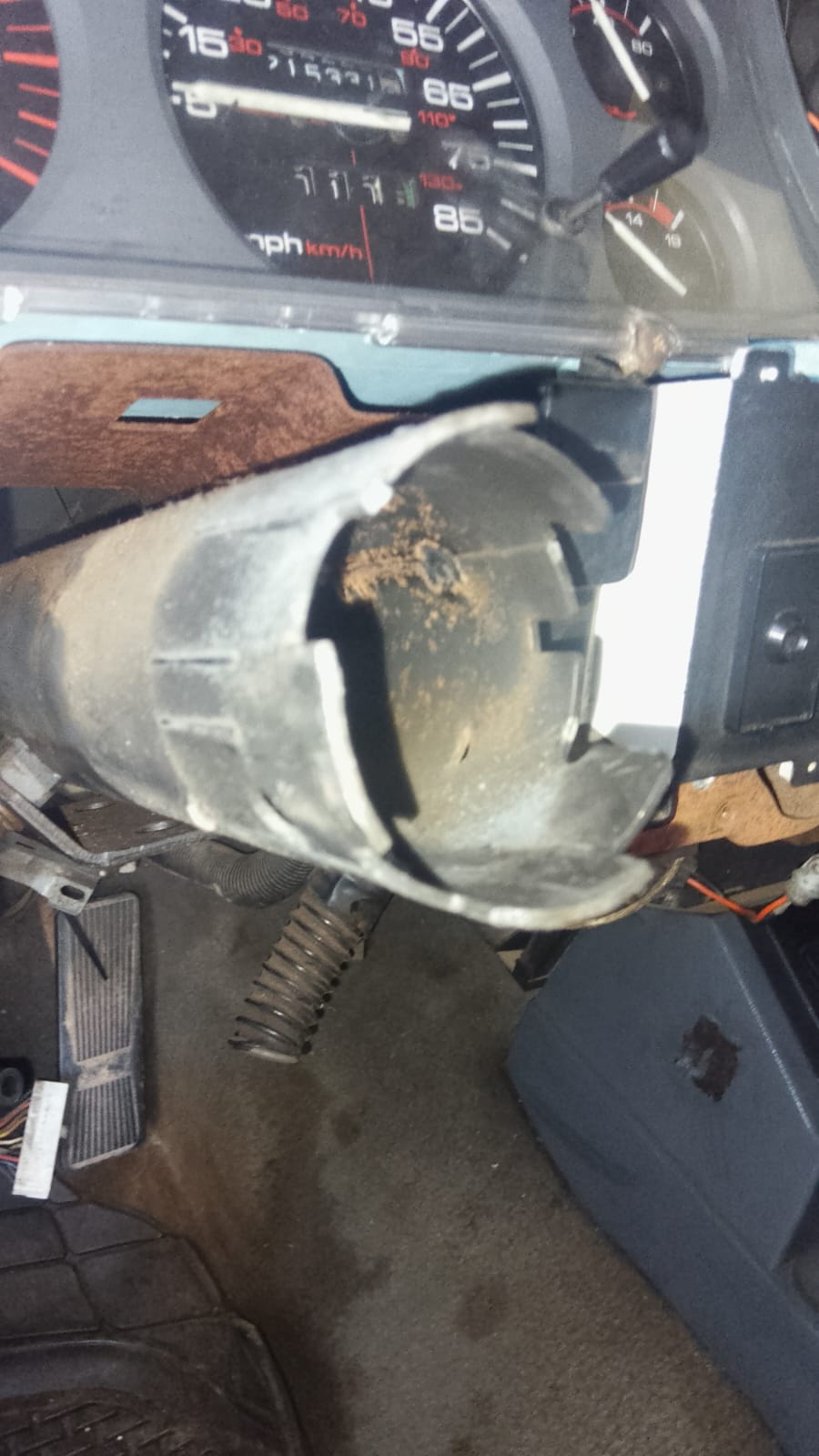

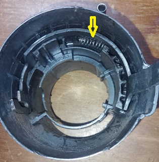

The Yellow arrow in the second image is where the key release is the lever in image three on the right as a reference. I think this is to hold the piece in? In fact my first thought was that both the tabs were to hold the piece in image three in and it only hooked to the ignition rod that goes under the dash but then the center section does not seem to be seated back far enough to not have the gap you see in image four, that image was taken when it collapsed and that gap would still be there so I am unsure how this is supposed to go together?

The key release in this image I see a spring that was not on mine when I took the column down, image in the original post here.

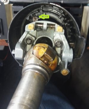

Now my column looks like this
WhatsApp Image 2024-08-04 at 17.27.05_fe39d679.jpgWhatsApp Image 2024-08-04 at 17.27.22_a219cd30.jpg
I still cannot figure out how the plate that takes the E8s goes in?

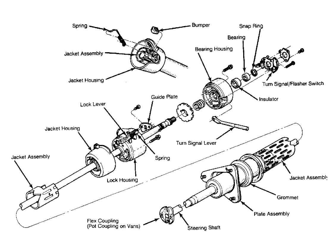

i found an exploded view but i cannot open the page at work, its blocked for me
i just typed "1987 jeep cherokee exploded view diagram steering column" into google

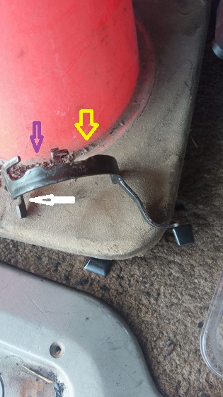

Solution: When I posted here looking for help my steering column had done this.
When I took it down thinking it was the E8s that everyone talks about I found them tight, but the entire section loose in the column.
I also found some pieces missing or broken one of the missing pieces was the spring in this image for the key release (I have a manual trans) that I found inside the column and had to remove the steering column shaft to get it.

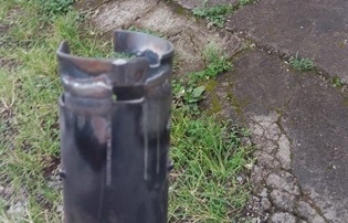

When I did, I found the tube looked like this.

When I posted no one told me this was broken, no one said anything, no one told me it is suppose to look like this.

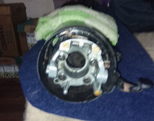

When I removed the Shaft I was able to remove these pieces with the E8s
When I separated them I found this in between
I took this piece and the column tube to a auto shop a few blocks away and 15 minutes late and $20 I had this.

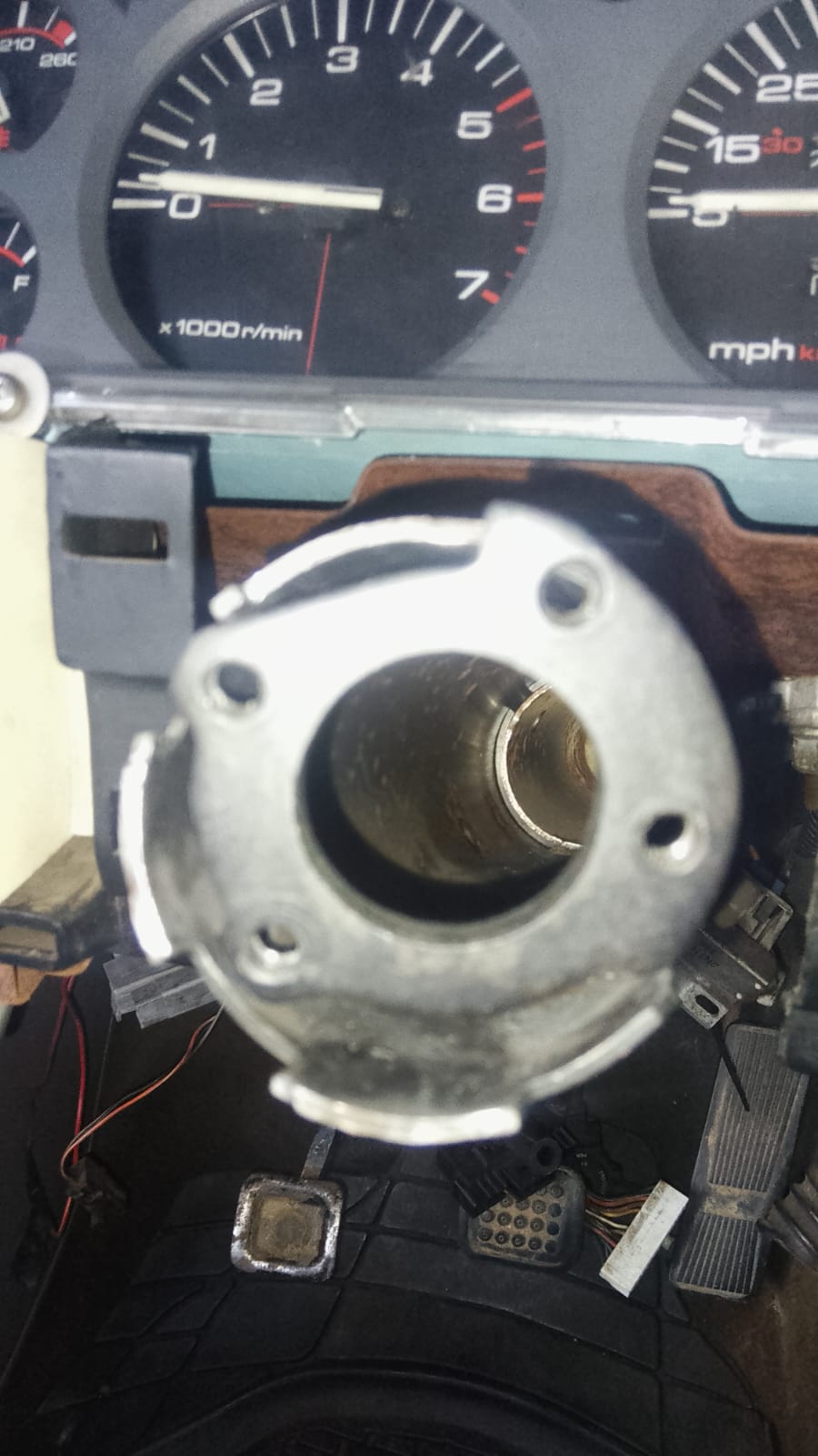

I brought it back home assembled it as far as I could until some parts get here to replace some broken things but I can reinstall it in the Jeep now.
If any of this looks like your issue or if your steering column looks like mine did on teardown this is the solution take the shaft out and separate the two pieces the E8s hold together there you will find the broken piece you need to weld back onto your tube.

oh crap, that weird piece was actually broken off the column metal tube cover? wow, thats nuts.
