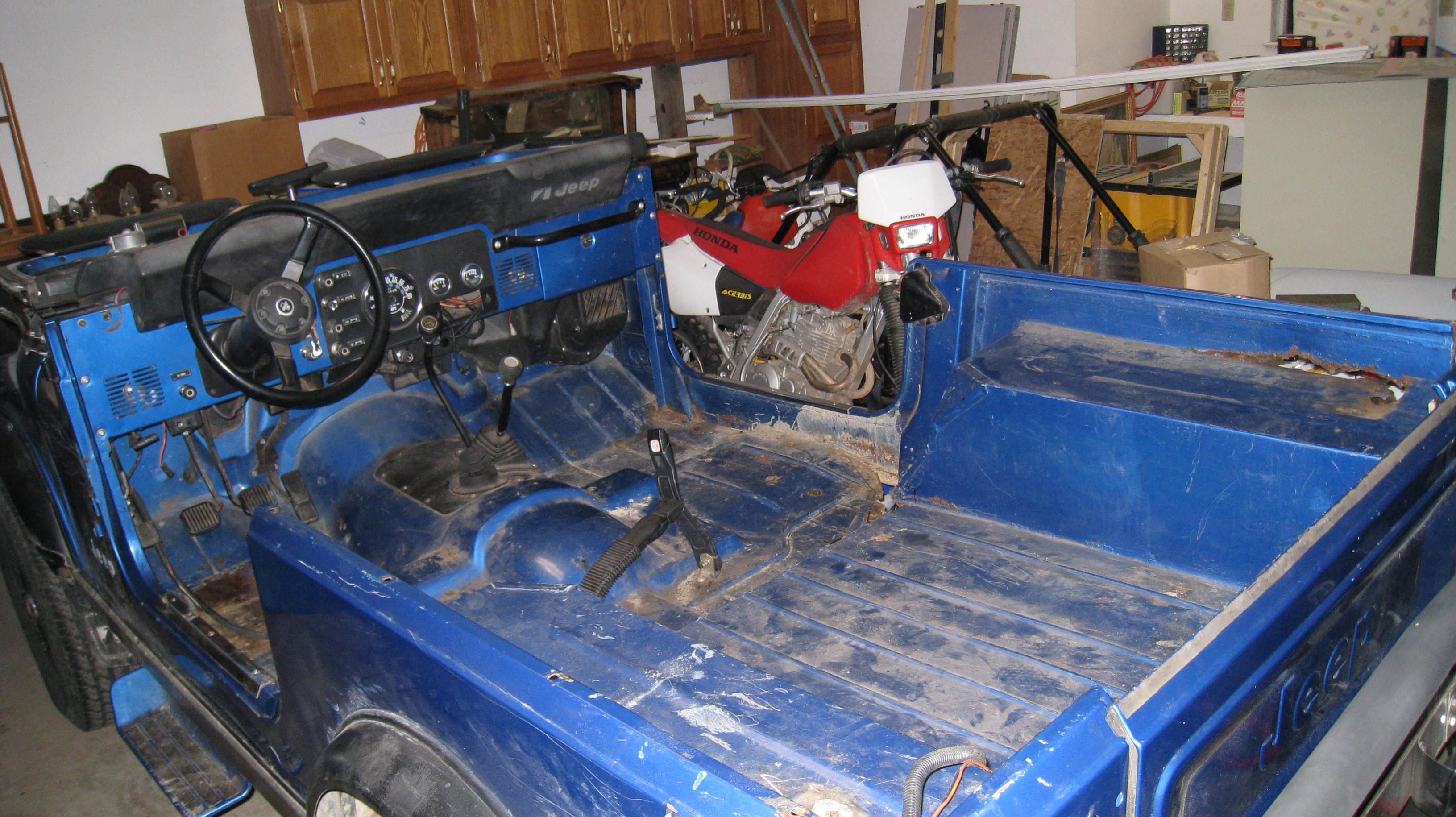

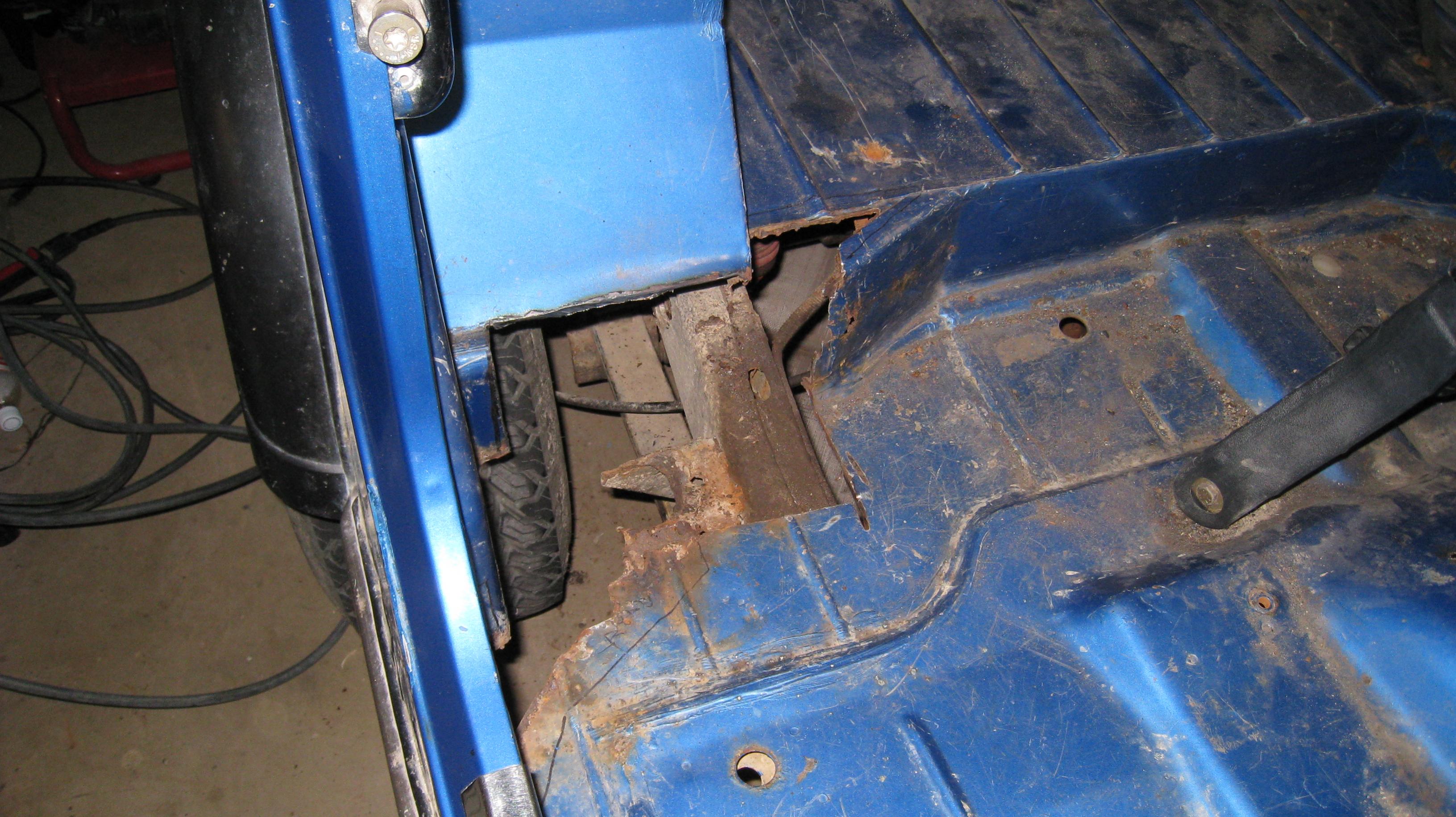

Here's a couple pics of mine right now. I'll put some more up when I get my roll bar mount in (and find the camera). Hang on, it's going to be heavy duty :shades:

Any advise? :mrgreen: I'm open to any comments or questions about my naked Jeep.
I've done some more cutting and torching today. I'll post some pics of my welded body mounts when I get them in.
