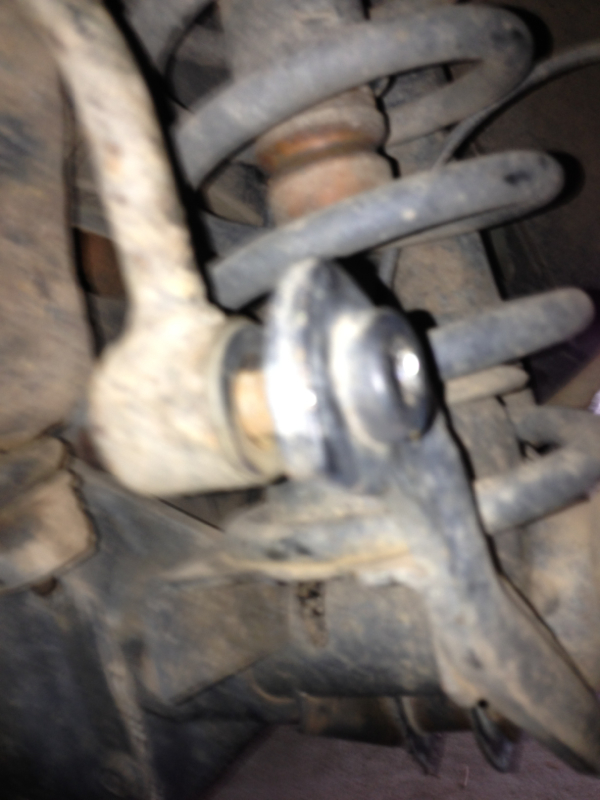

Heeeelllllllpppp the gosh darn hex piece won't budge on either side........ One side is stripped....

Protect the threads and give it a few good whacks, unless you don't care about the threads.

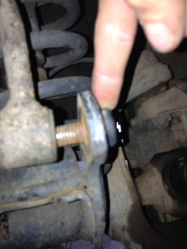

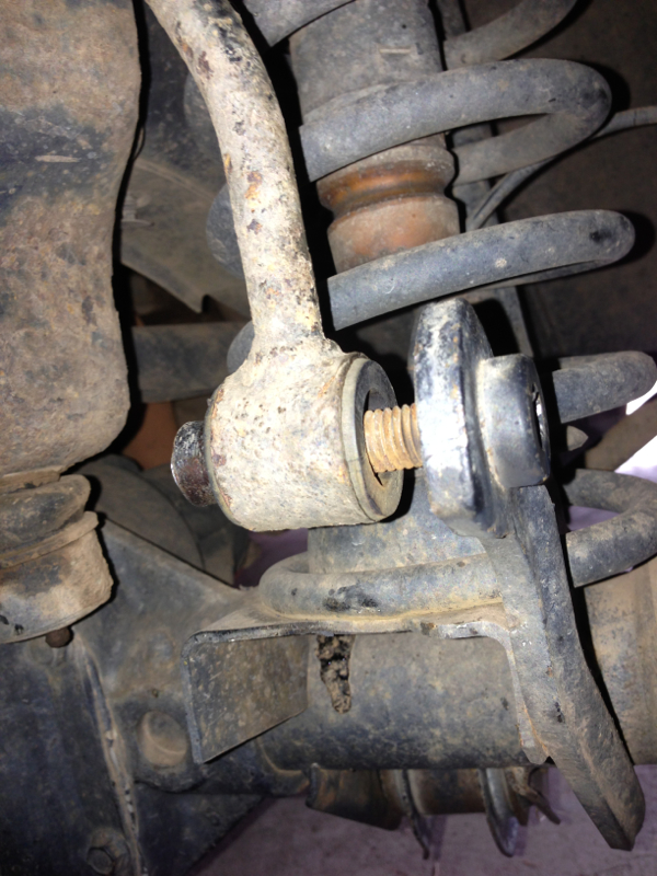

The bolt that's in the mount from the axle is litterally like welded on I don't care about the threads I'm putting in hitch pins I just need these suckers out
What I'm pointing to is what I'm talking about

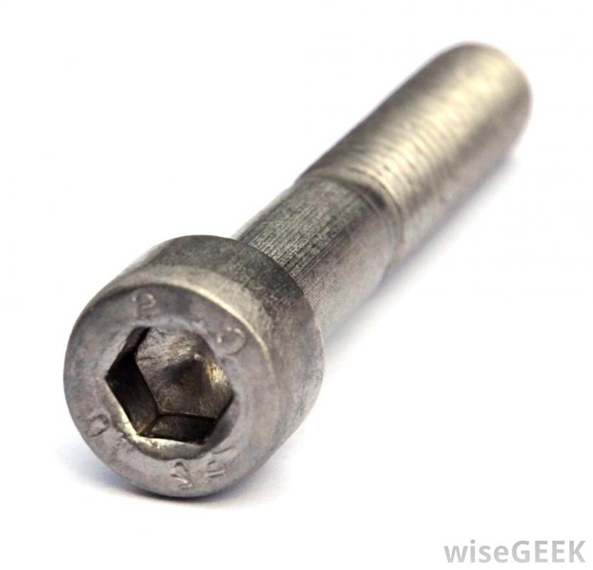

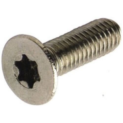

I believe that bolt is a torx, not a hex
Hex / Socket bolt:
Torx bolt:
You'll want to pick up a set of torx sockets in the future (most of the bolts on our Jeeps are torx):
I normally replace these torx with quality hex head bolts as I work on them, because as you've found, it's easy to strip them.
Now, for your current situation, you may have to go a different route if the heads are stripped. You could try vice grips on the bolt head, or if you get really desperate, try heating it up a bit.
