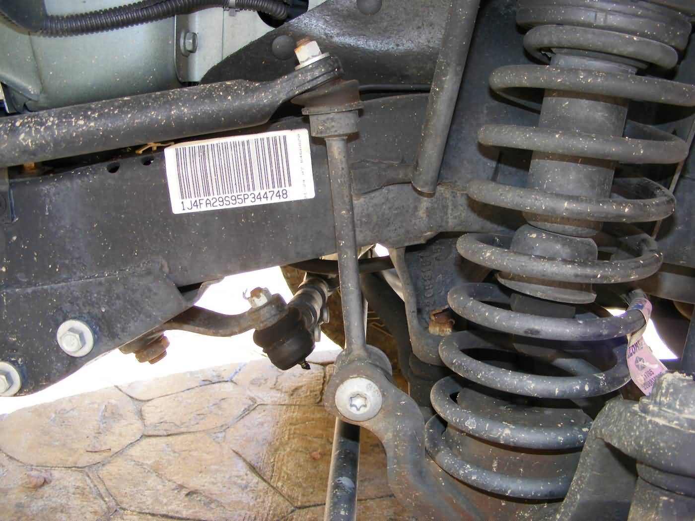

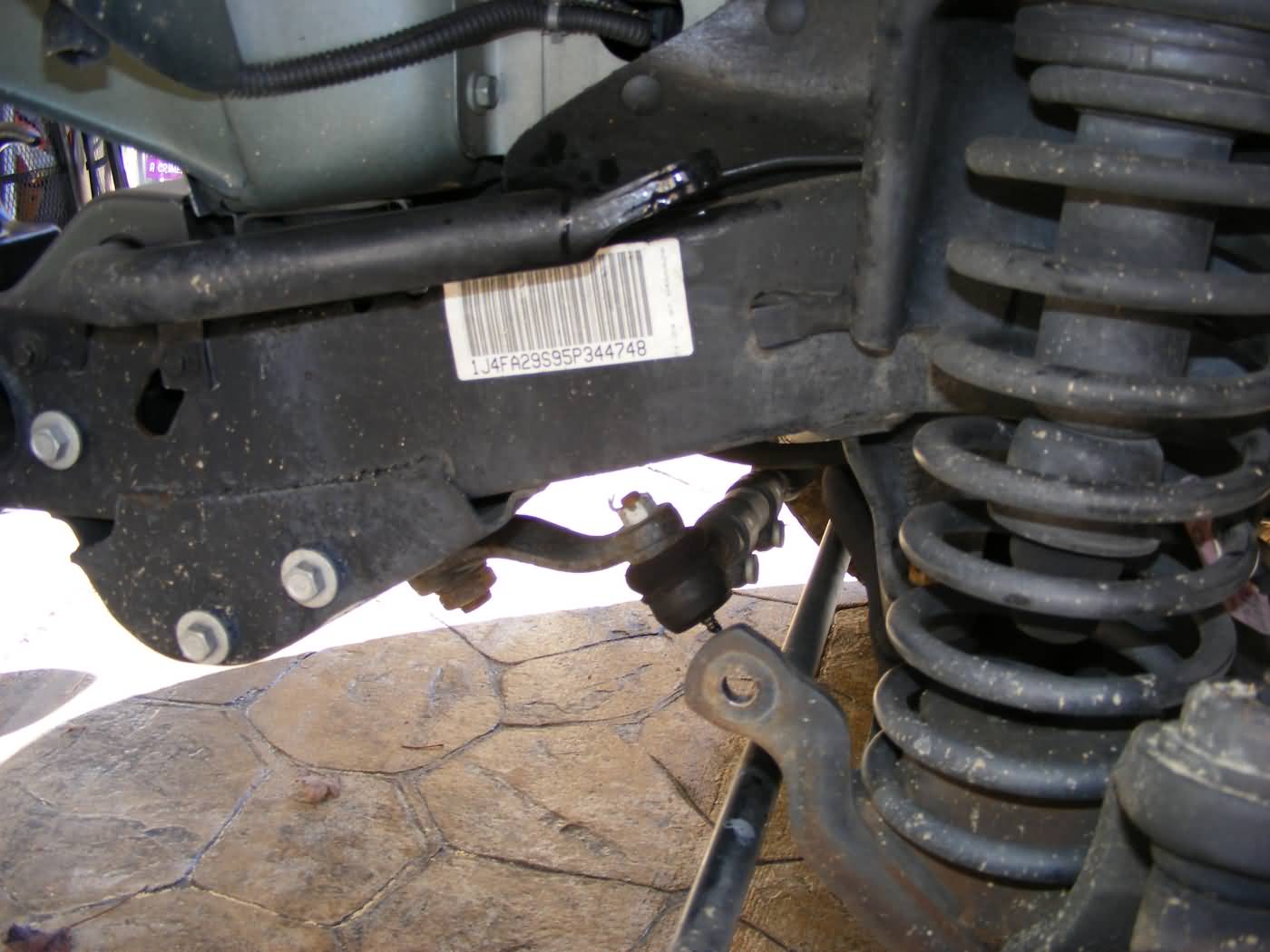

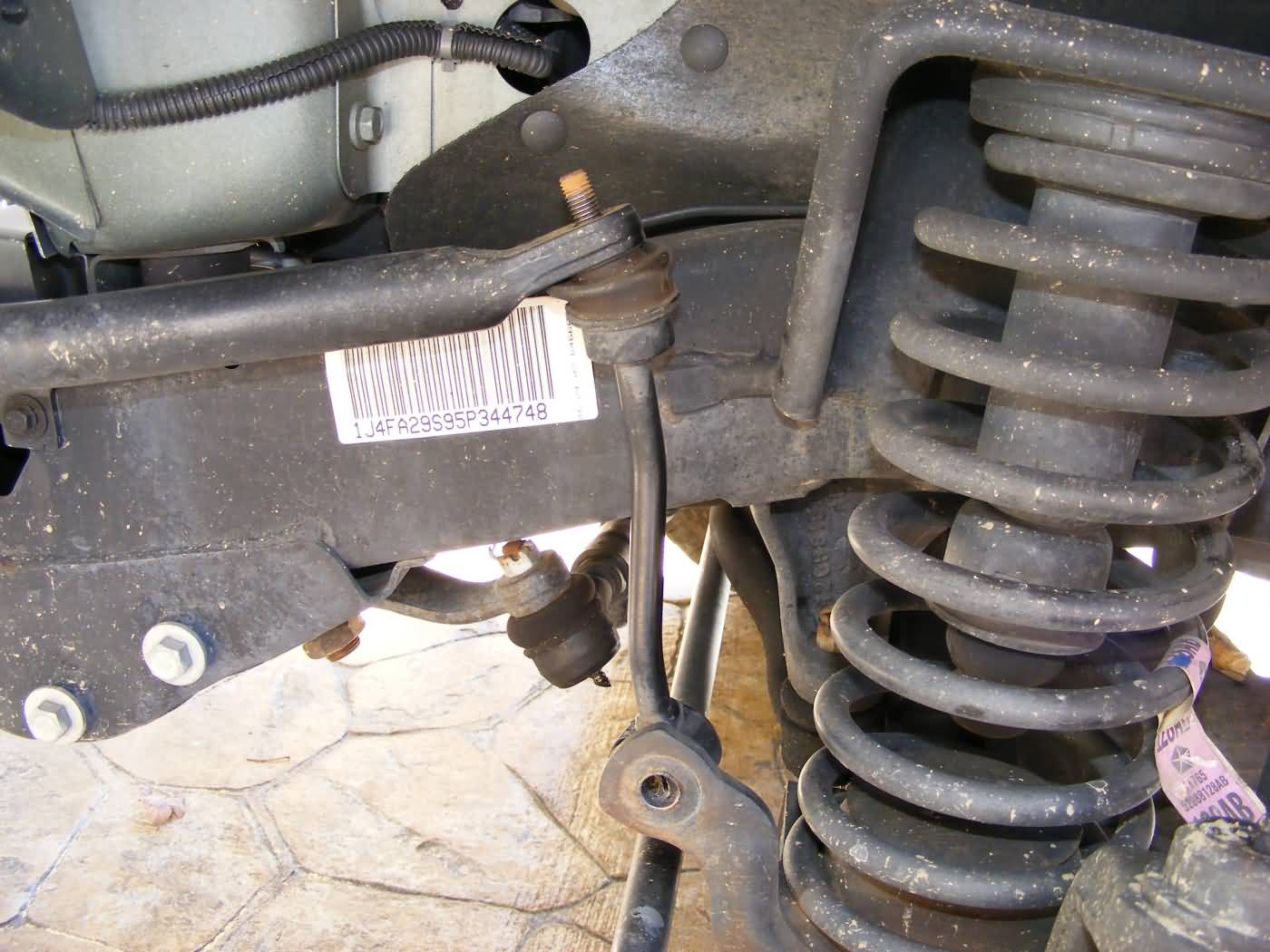

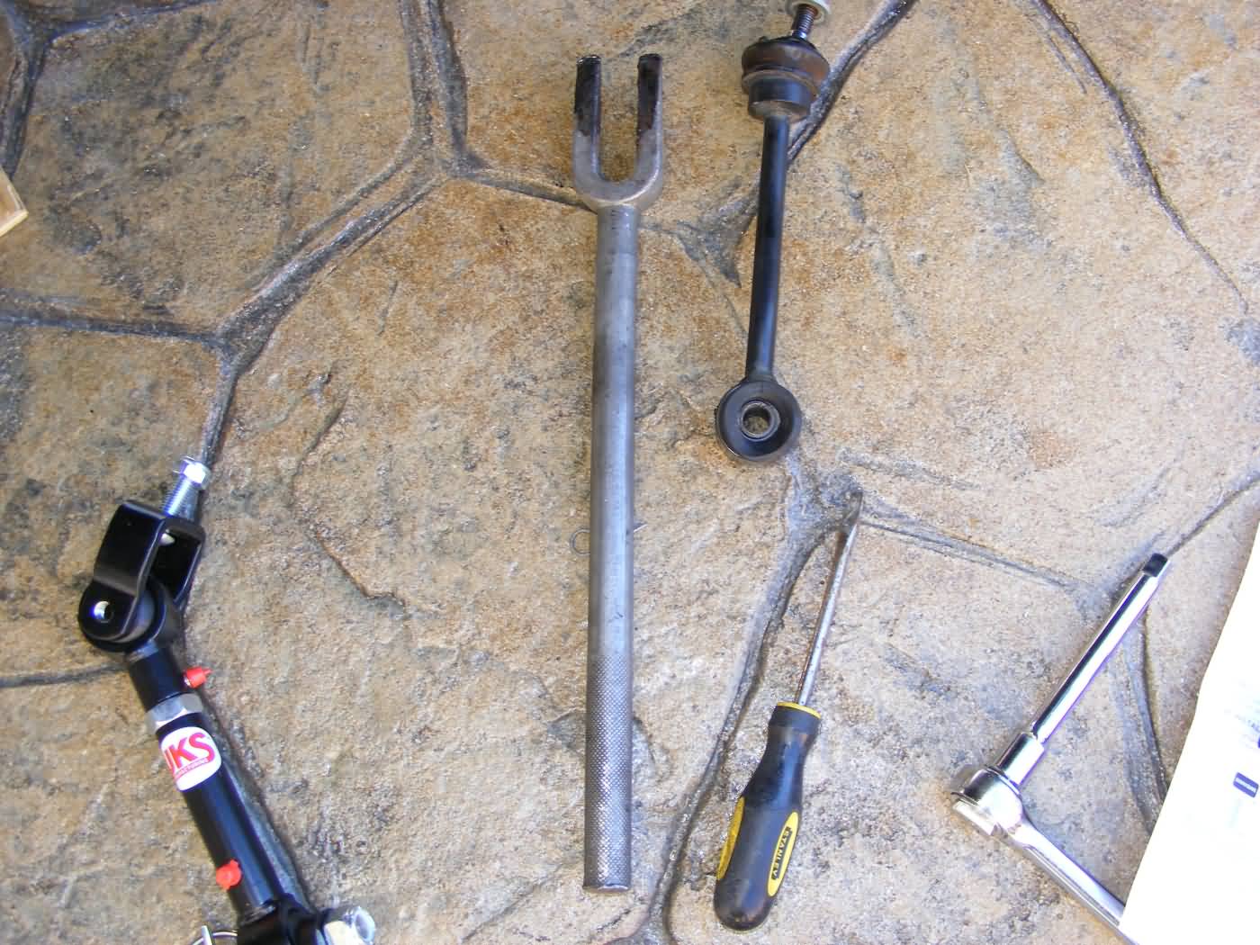

I used a pickle fork to pull mine off. It's the one that looks like a U below - you may be able to borrow / rent it from your local parts store, but it's one of the tools that I keep finding uses for. I just pulled down the rubber boot, and tapped it into place until the link popped off. It's pressed in, now threaded.
