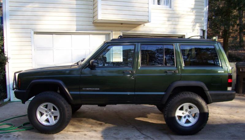

I'm not sure about mine having the death wobble but it's a chore to keep this beast in between the lines, and theres a popping noise from the left front area cant quite pin point it. my bushings are about to get replaced and I also noticed my track bar bushings are so bad that I can slide it side to side without any effort. I'm pretty sure that's not good:( I'm also about to purchase adjustable upper control arms because the guy who lifted my jeep just rigged up some arms that are quite shady looking. So needles to say my jeep looks good but drives like crap.
