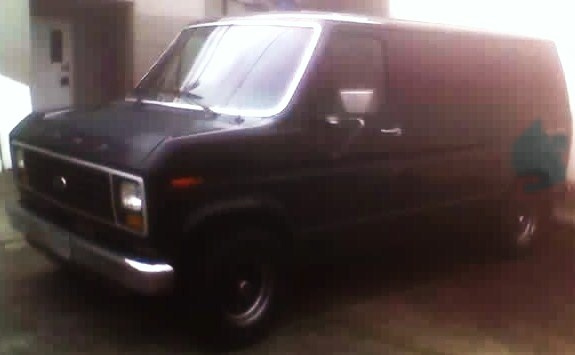

This is the rig I have when I'm working on 'Betty' my '78 CJ5, 'The Oven' an '81 E150 I bought 15 years ago is having headlight issues.

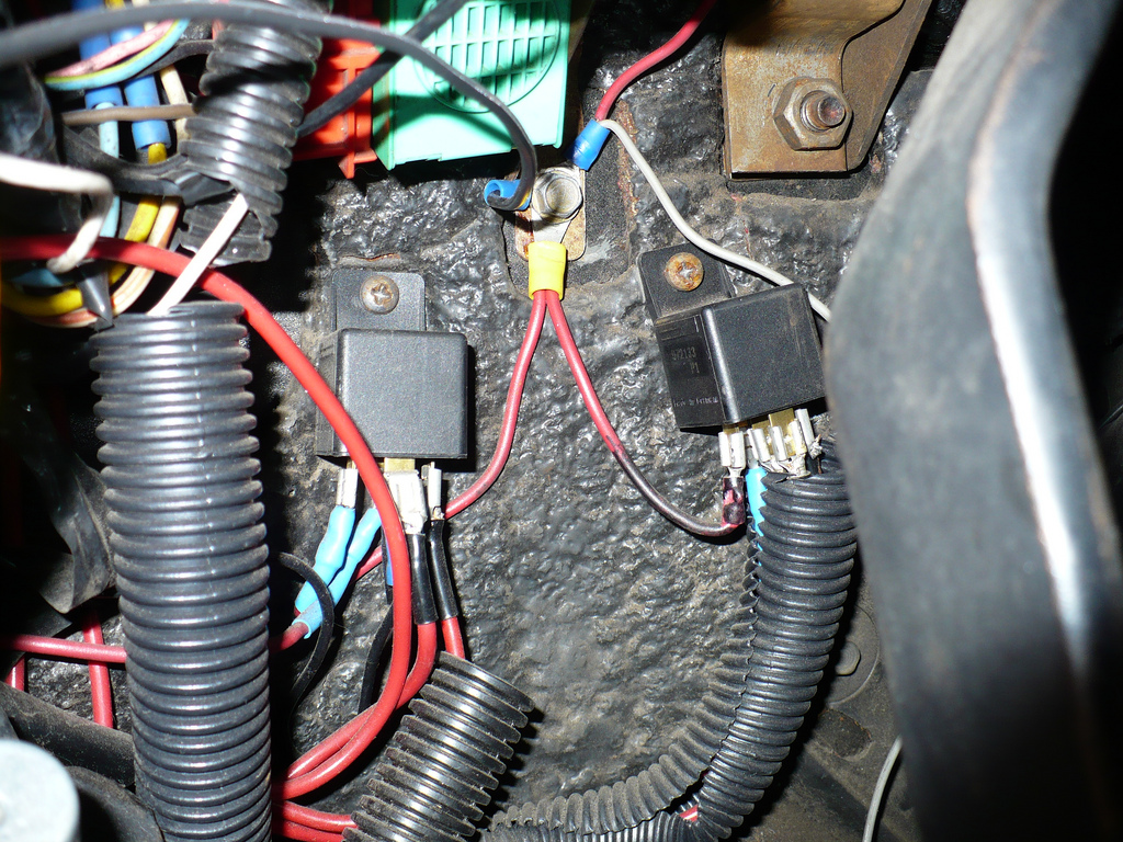

I only became aware of this as I go and return from work during daylight. 'The Oven' is equipped with a 3+1 overdrive transmission and this intermittent flickering is most prevalent when releasing the clutch and the motor speed changes. I'm thinking that perhaps the clutch pedal is contacting wiring to the double relayed wiring for these 190/120 H4 headlights. This was part of a headlight upgrade I performed about 15 years ago using 12 gauge wiring to replace the wimpy 18 gauge to drive these H4 units.
On the other hand it could be simply a ground issue as the climate here in Oregon is condusive to corrosion in all forms.
Hopefully I'll have time to inspect the wiring and relays mounted on the interior side of the firewall and find something obvious. If you all have any other insights please respond.
