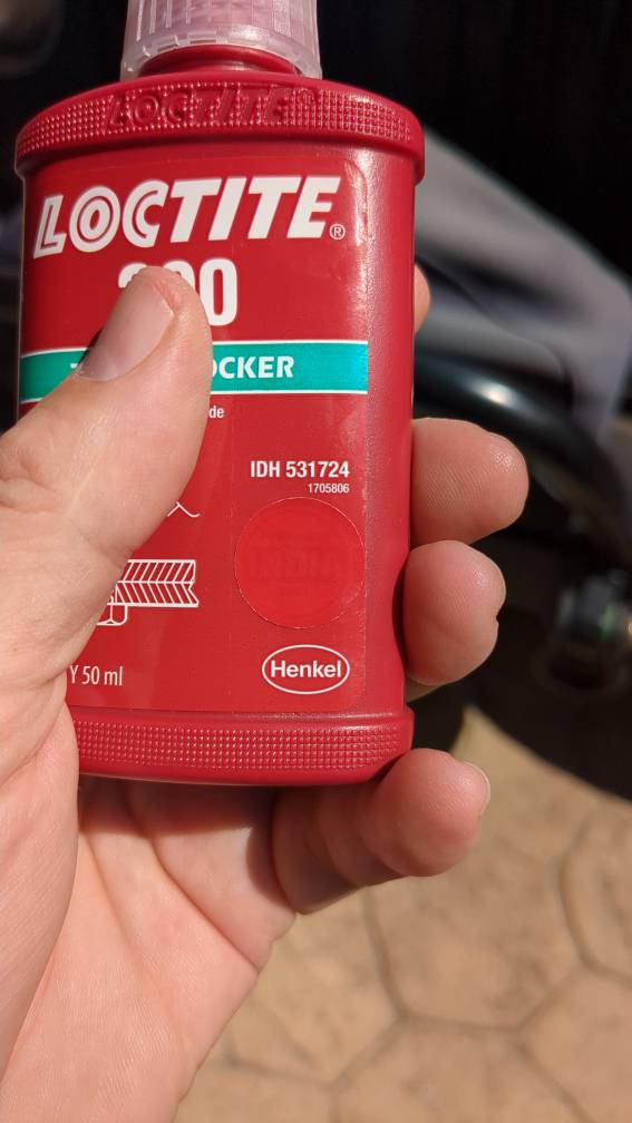

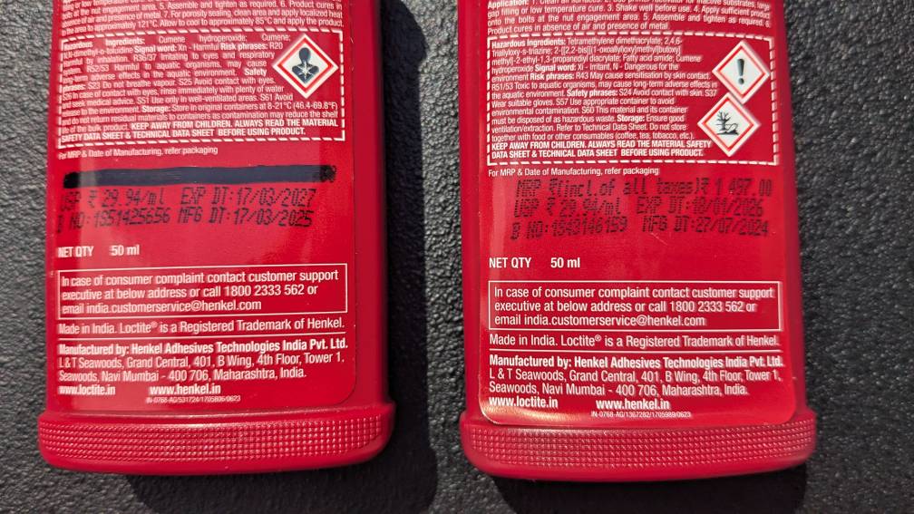

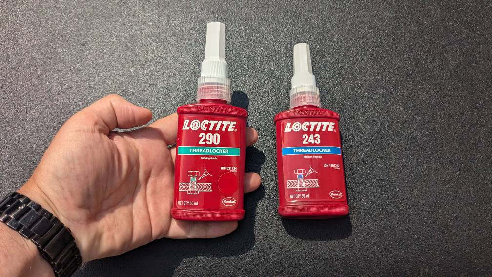

I bought some loctite on Amazon. In hindsight, I probably should have stuck with my local parts store as one of them expires in 6 months. On the plus side, the bottles are huge
I'm not sure what angle they were going with one of the bottles having a sharpie marking out what I believe to be tax details.
they put a red sticker over top the product of India designation.

Reading around, I think these are graymarket things. Made for the Indian market, but brought over here for sale.
Counterfeit! Or brought here for profit. $1 there $ here.
