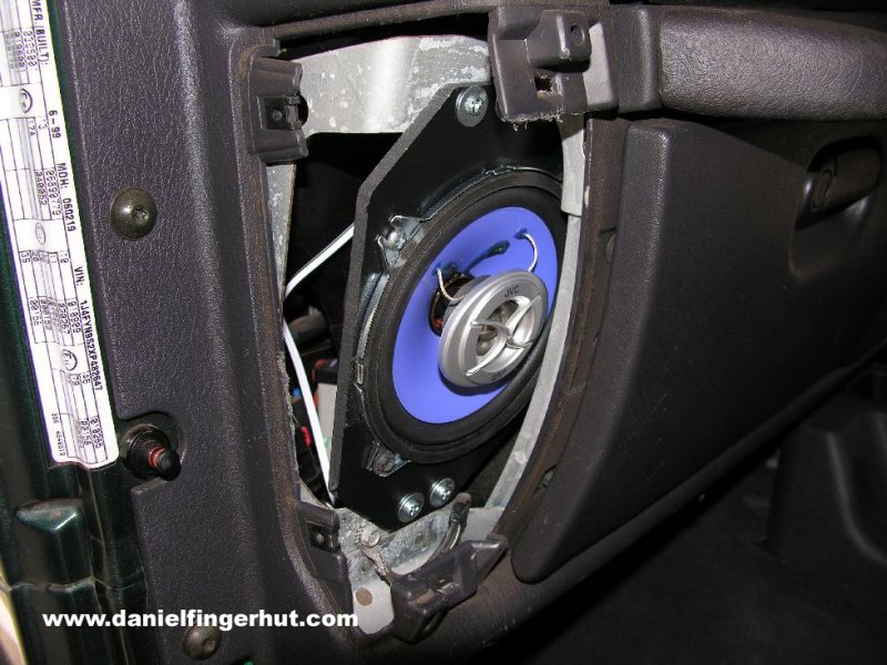

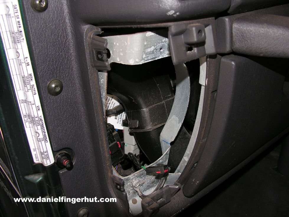

I used the adapter plates in the dash and also went up a size on the roll bar speakers and I think it made a difference. Bigger is always better when it comes to speakers. It's a cheap and easy upgrade.
For the speakers you used in the dashboard adapter plates did you use 2 way or 3 way speakers?

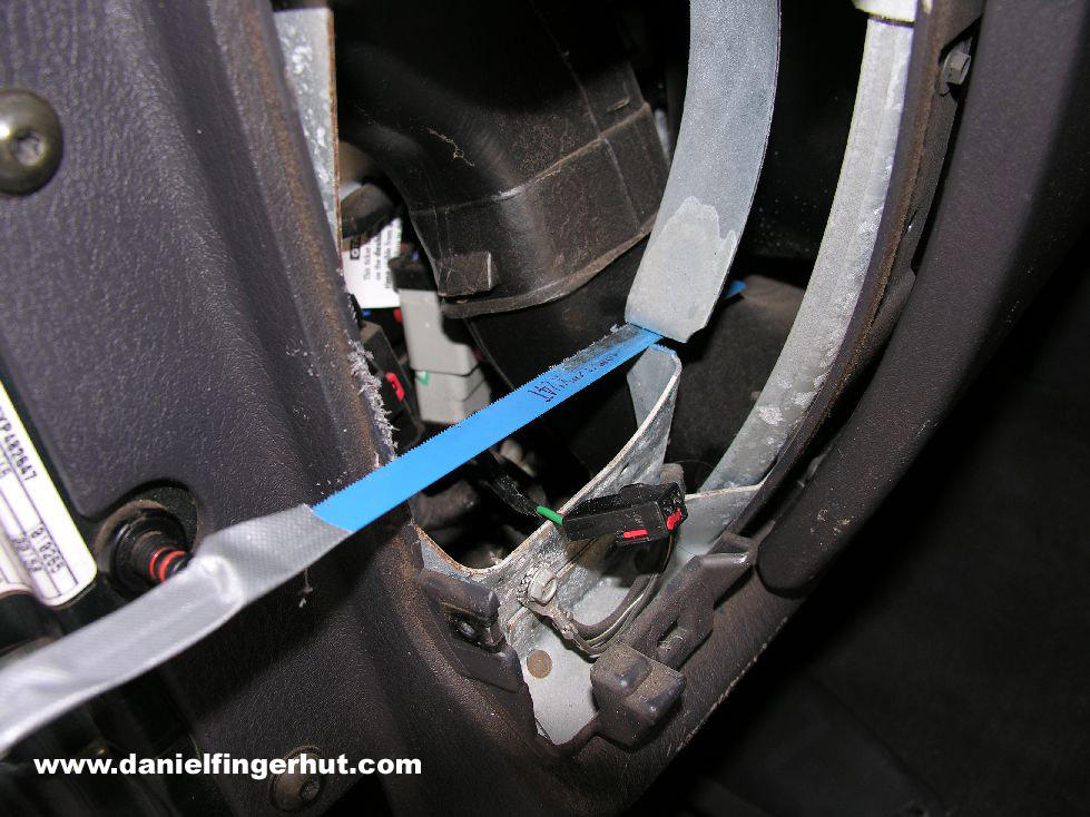

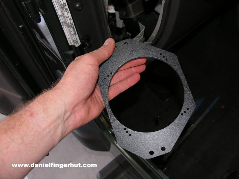

I didn't have to do any cutting on mine and it's an 04 as well so you SHOULDN'T have to either.
so for the front dashboard speakers i simply drilled 2 holes on each side and fit a 5.25 speaker with no problem
haha yea just used a drill and drilled 2 holes for each speaker worked perfectly.
I noticed a little bit it equaled the sound out. One day i'm upgrading the sound bar to 6.5 but theres other things that need to be done like an oil change, 4.88 gears, d44, v8.............. shall i go on? haha

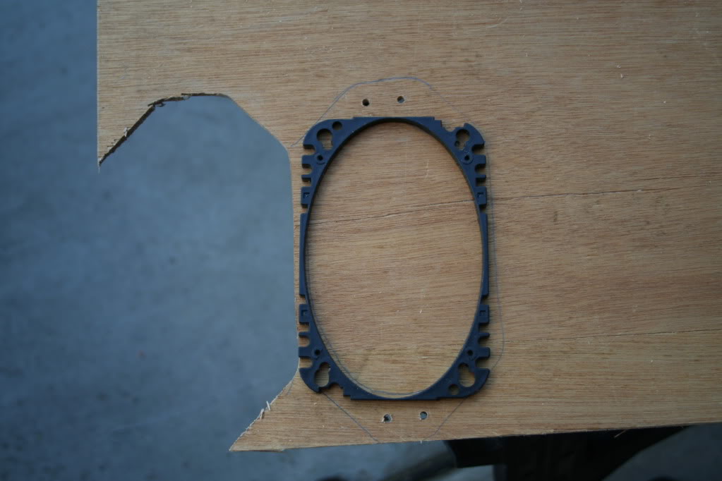

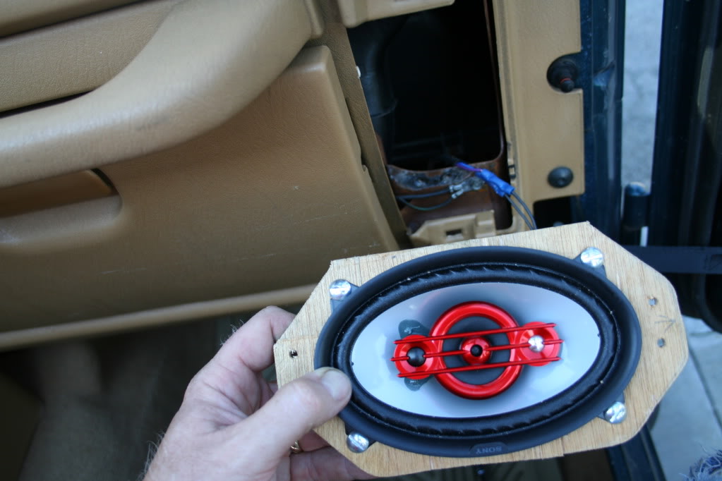

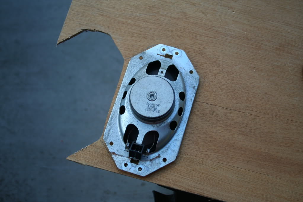

Eh, I just used 1/4" plywood and made my own. The 4x6's wouldn't bolt up stock but this would work on round speakers too.
Used OE speaker as a template.
Used spacer ring to cut the hole.

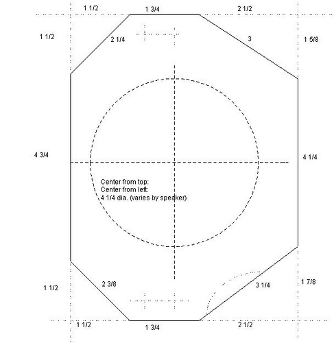

If you want to make your own adapter plate for a 5.25 speaker, here is a template.
