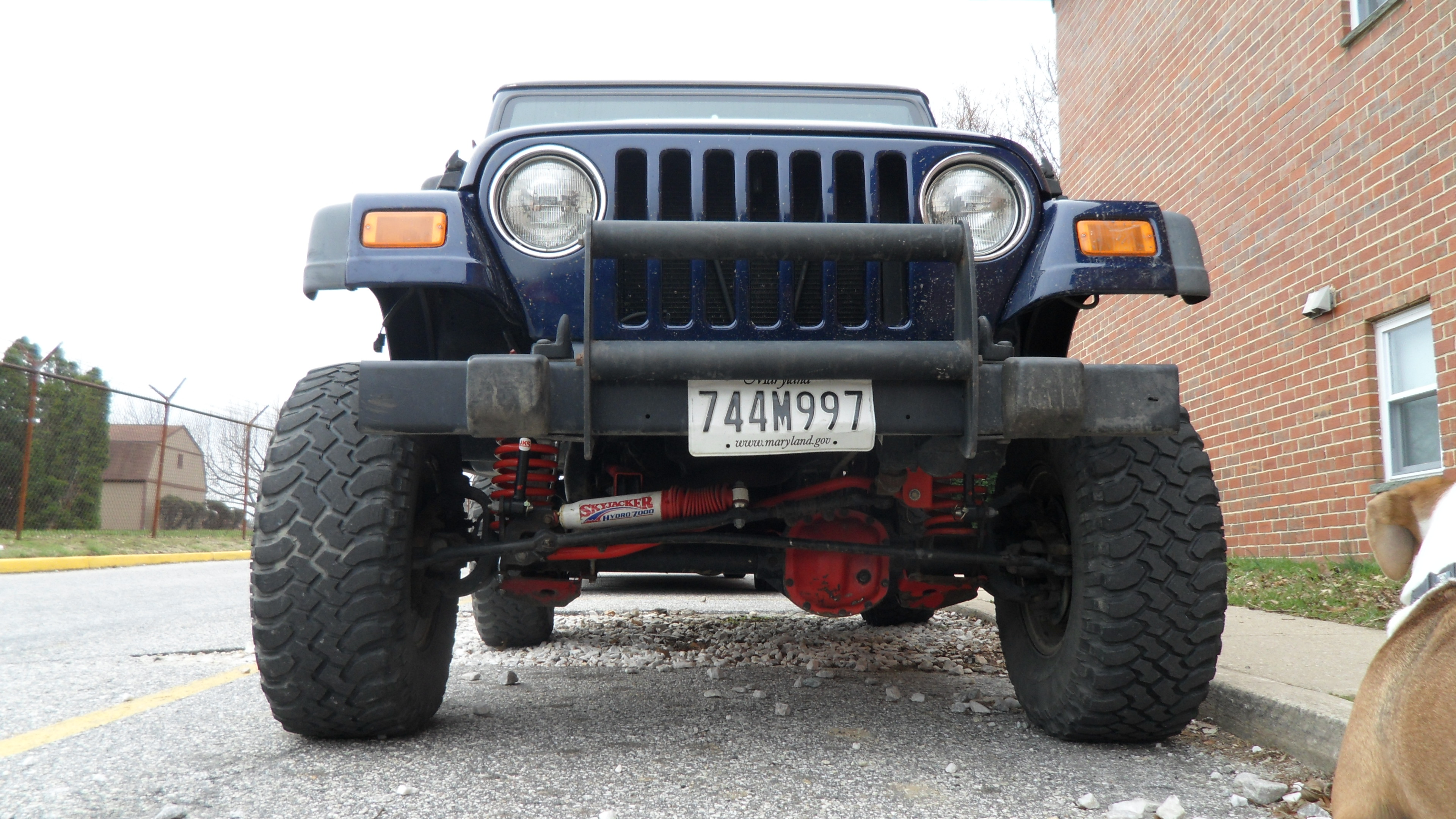

Finally got a picture of the bent tie rod (sorry, sprained my ankle Monday evening and I'm on crutches all week). New tie rod supposed to be here Friday. I'll post an install if I get things wrapped up this weekend.
