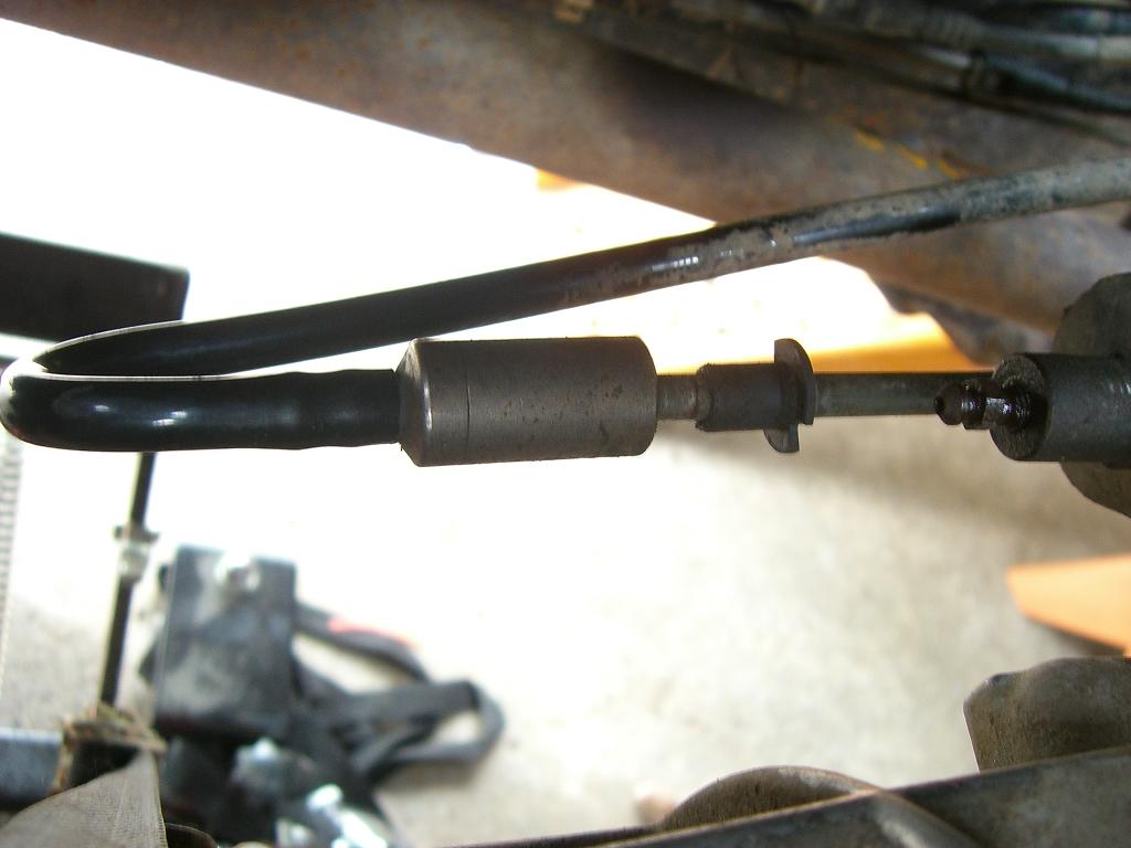

OK I have hit road block, how do you remove the line that comes from the slave cylinder to the transmission? there is no nut to unscrew, it has a kind of clip that slides out of the connector but the connector does not come off the line going into the transmission. Is there a certain way this comes off? the Haynes does not go into a lot of detail.
I posted a pic below
Nick

Thanks for the info dingus I appreciate it. unfortunately it covers about as much as the haynes manual. I think I am going to have to drop the transmission first then disconnect the hose from inside the bell-housing.

OK I got the transmission off and there is no identifiable disconnect on the inside for that F'n hose, I am stuck!!! Theres got to be someone who has taken these off before, I will wait for your wisdom.

OK I finally figured it out, so now I will stop my whining. I am sure I will have more questions though, this is my first time attempting something like this.

So spill the beans! How did it come off?:???:
Well if I was an intelligent being I would have read the instructions that came with the clutch kit first, however I am not a patient person. There is a retaining pin that attaches the hose to the throw-out bearing or what ever it is called.... (excuse me I just finished off a bottle of JACK in celebration of getting the Transmission out), that pin was covered by a bunch of crud. After reading the instructions and finding the pin it was all a piece of cake.... now if I can get the clutch out and the new one in without screwing anything up all will be well...... crossing fingers : )

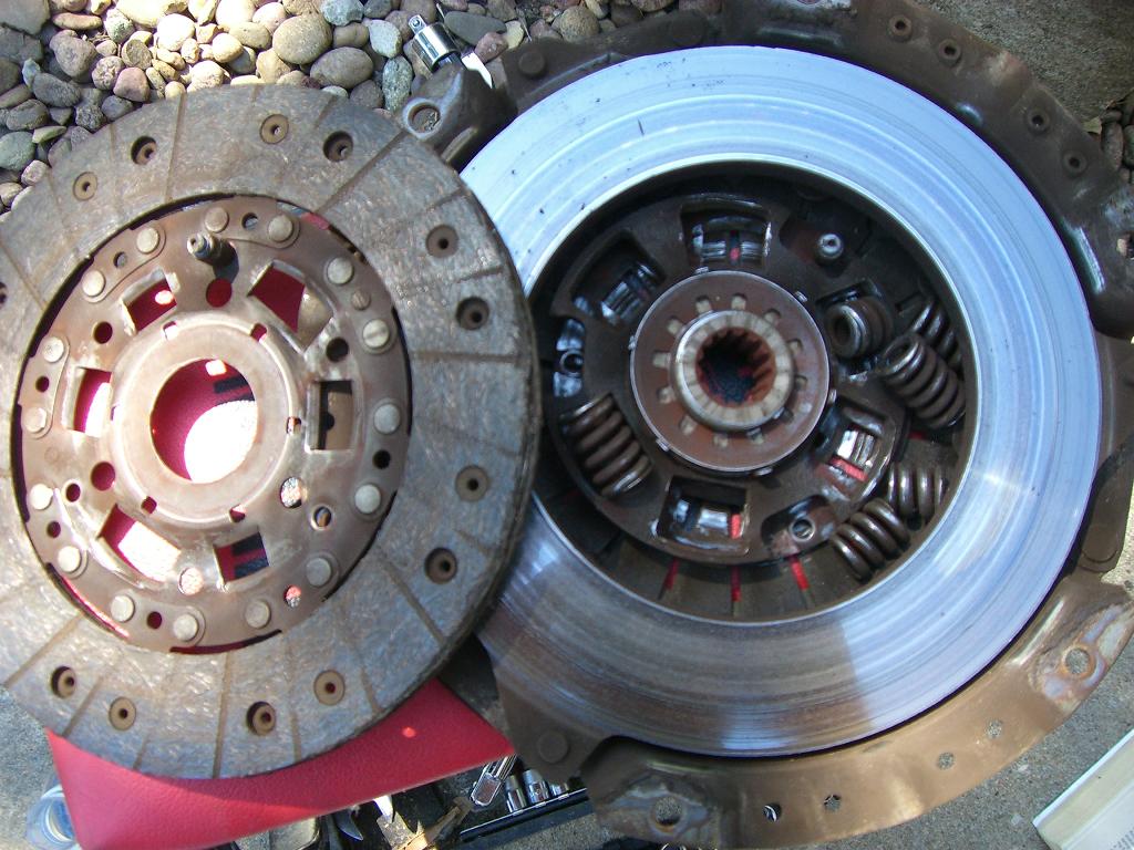

Here is the clutch as it came out of the jeep, as you can tell my problem was obviously in the clutch.
