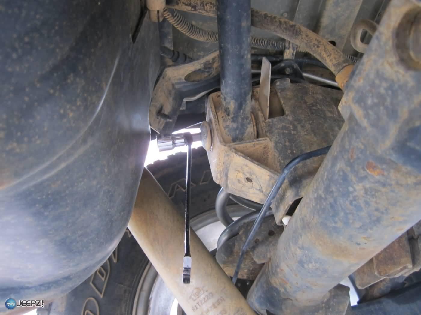

I had the same problem with my rear track bar bracket. I found that you can slip a wrench over the torx bit and turn it that way.
Like this:

The one I got from Autozone was 5 bucks with a lifetime warranty. If it breaks they said just bring it back. I think I might have to try the wrench over the bit like the picture, just need to figure a way to put an extension on it so I can reach it from the top or bottom of the motor.
Use a section of pipe that the wrench will slide into, backyard mechanics do this stunt all the time. I use a piece of duct tape to hold the wrench into the pipe, that way when you reach down to the bolt from the top the wrench doest fall out of the pipe(been there done that!..lol)
