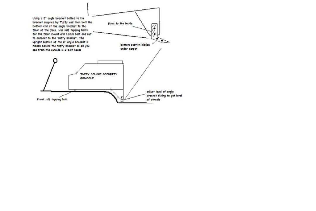

got it in o.k, i used a self tapping bolt for the front bolt and a set of angle brackets on the back fixed to the bracket they supply. This has made the console sit better in the jeep, more level, and is amazingly secure, as it should be. I must confess that i left off the drinks holder as this seemed to get in the way fitted either at the front or the back.
Once it was all in i looked at the gap between the transmission and tunnel again and realise there's a lot more room there than i thought, but still prefer my installation method.
Cheers Stew:mrgreen:
Pics or more detailed description please.

No photos of the installation as it happened but have attached a drawing showing the method
