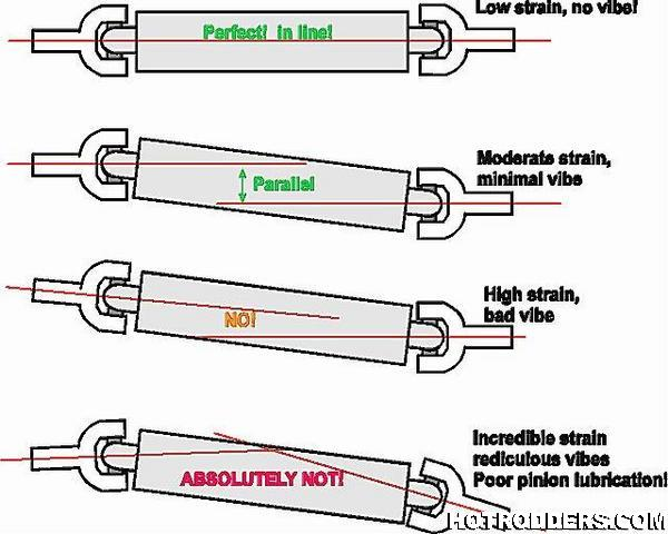

Also measure your driveline angles. Make sure they are ok
