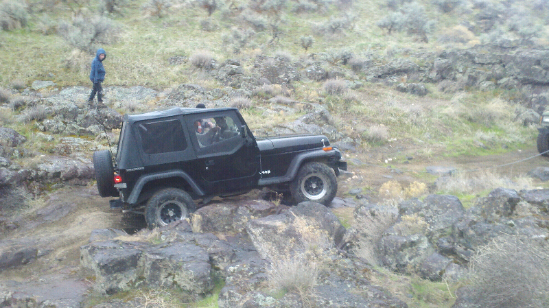

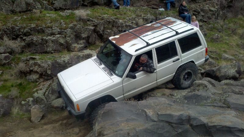

Wait a minute... I must be sadly mistaken here. I thought the YJ already came with 4.10 gearing to start with....guess im wrong there. The bigger tires are really for more clearance. I was definitely the little guy out there. Everyone around me was doing stuff like this:
While I was getting hung up on stuff like this:
A lot of it has to do with experience and knowing how to pick a good line. I don't see any reason why you couldn't be doing what that XJ is doing in your YJ. It doesn't look that bad, really. Anyway, you could do a small lift and bigger tires, but I would also suggest rocker protection and some skids if you want to play in the rocks like that. If you don't armor-up, it'll come back to haunt you eventually. But again, before you go spending a bunch of money on lots of modifications, I would invest in seat time. You'd be surprised at what a mostly stock Wrangler can do when driven by someone who knows what they're doing. And by the same token, you'd be surprised at what a mostly stock Wrangler can get stuck on when they're driven by someone who doesn't know how to wheel it ;).
Haha!....touche.... in my defense though, I did have 3 spotters telling me what to do, and I followed direction perfectly. It was mainly my leaf spring bolts that were dragging. Broke two and bent two. That was my only carnage though, so not too bad. I got through eventually, just want a little more clearance. That's all.
She did do pretty well, for being basically stock though. You're right there. I made it over some stuff that I really didn't think I would. One guy in a TJ busted an axle, another guy in a TJ ripped of his rear bumper, and even another guy in an XJ completely crushed his exhaust and muffler. These guys were all very experienced, so I think I did pretty well considering.
