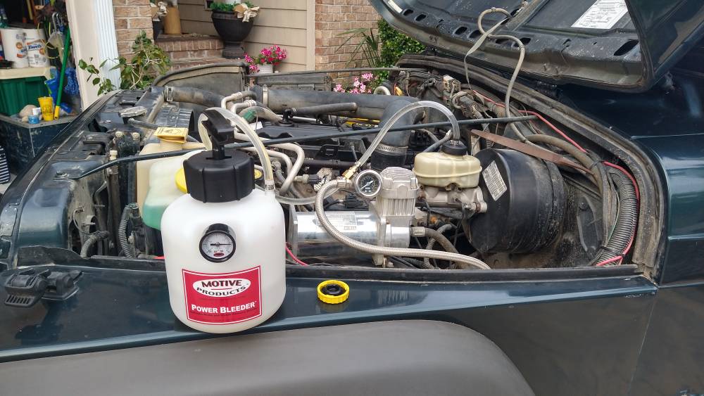

My brakes are squishy again, and I think it's time for another bleed.
what do you guys think of this brake bleed system for $72:
Amazon.com
cacheJeepzImage.php
I'd like the option to buy adapters for other vehicles, but overall it looks good
You hook it up to the master cylinder, fill it with clean fluid then pressurize everything. Open the bleeders one at a time, and it pushes the old fluid out.

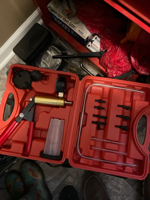

I bought this from Amazon for $24 I think. Just got it this week so I haven’t had a chance to use it to say how well it works. The catch is pretty small but allows for 1 person to use and refill after every collect.
Let me know how you like it. I think that kit is where you pull the fluid out at each wheel (instead of pushing from the master cylinder).
I had a plastic one of those at one time, but ended up braking it. The one you have looks better made though.
My son recently bought the Harbor Freight version of that bleeder - it didn't hold up too well, the pump was the weak link.
I bought a vac bleeder from HF, the grey one with many fittings. It Works well but you get air leaking through the bleeder valves threads.
So i only use them if I must. You need to cake grease around the threads. Two person bleeding is mainly how I do it.

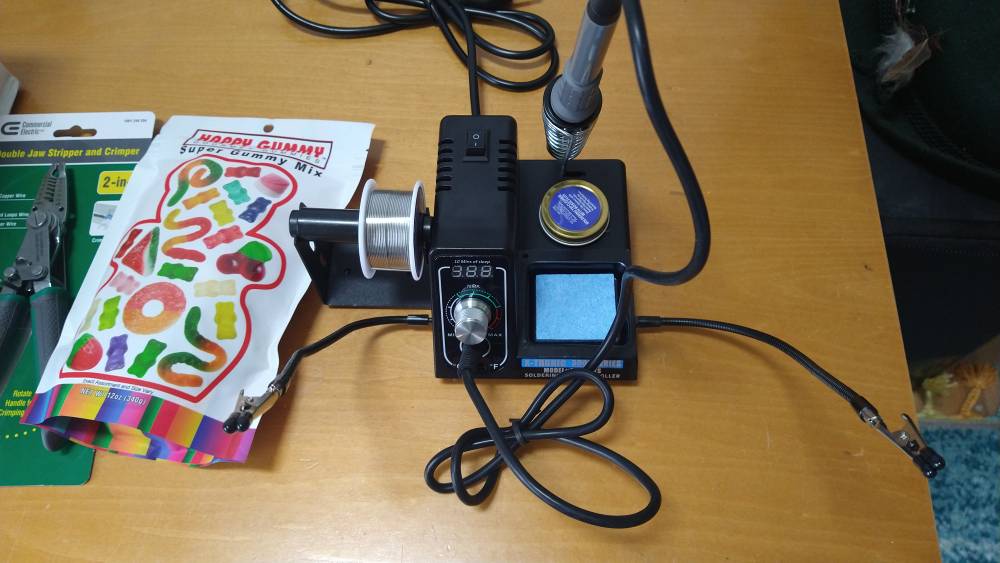

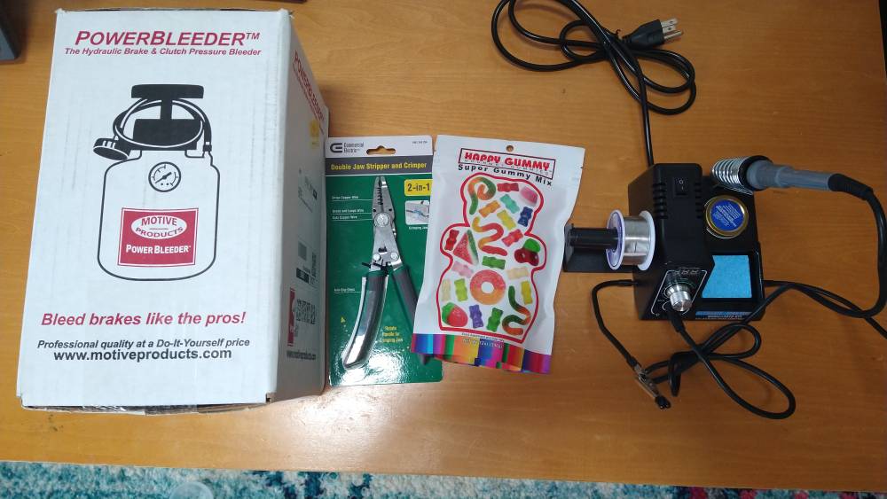

I think I did pretty good! I got a cool solder station that will hold the parts you're working on while you soldier them together.
The brake bleeder works better than I expected. I was surprised to find that my brake fluid was very dark color however I hooked up the bleeder pumped up some pressure and purged each one of the bleeder valves. Plenty of air and old fluid came out and now the Jeep stops pretty well.
All in all a pretty good birthday.
